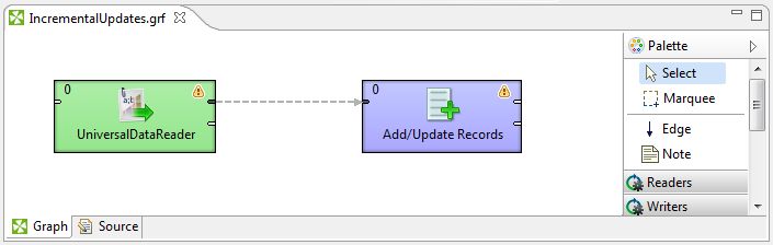

  1. In the Palette pane, open the Readers section and drag the UniversalDataReader component into the Graph Editor.
  2. In the Palette pane, open the Discovery section and drag the Add/Update Records connector into the Graph Editor.
  3. In the Palette pane, click Edge and use it to connect the two components.
  4. From the File menu, click Save to save the graph.
At this point, the Graph Editor with the two connected components should look like this:
The next tasks are to configure the components.
