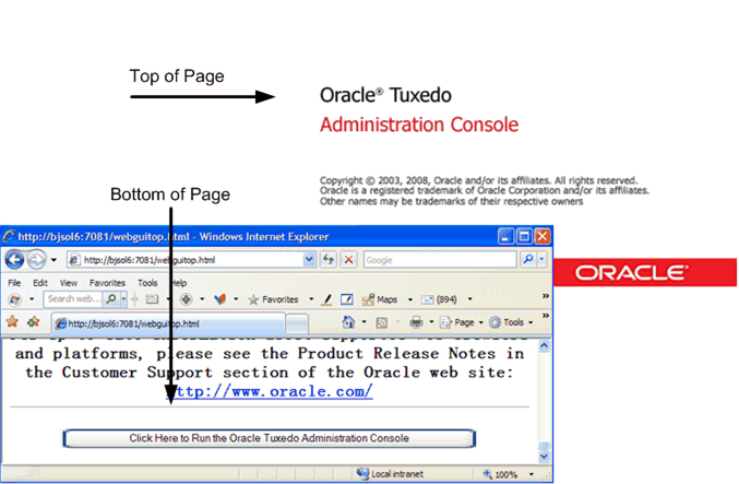

http://gumby:8080/webguitop.htmlFigure 1‑1 shows the Administration Console splash screen, including the button that starts the Administration Console, which is located at the bottom of the entry page.Figure 1‑1 Oracle Administration Console Entry Page

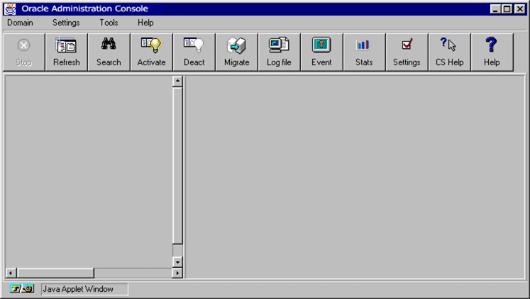

 4. Enter your login name and password in the appropriate fields, and click LOGIN. The password must be one of the entries in the tlisten.pw file, which is located in the udataobj directory where Oracle Tuxedo is installed.Figure 1‑2 illustrates the Administration Console main window that displays after you complete your login.Figure 1‑2 Oracle Administration Console Main Window
 Table 1‑1 shows the accessing information about the Oracle Administration Console Main Window. The main window does not display and the Connect Failed error message is displayed.

 15. Scroll to the bottom of the window and click the Click Here to Run the Oracle Administration Console button.
 16. Enter your login name and the tlisten password after the appropriate prompts, then click on the LOGIN button. As shown in Figure 1‑2, “Oracle Administration Console Main Window,” on page 1‑7, the Oracle Administration Console main window is displayed in your browser.For a complete description of the main window, refer to the section “A Tour of the Main Window” on page 2‑1

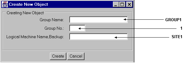

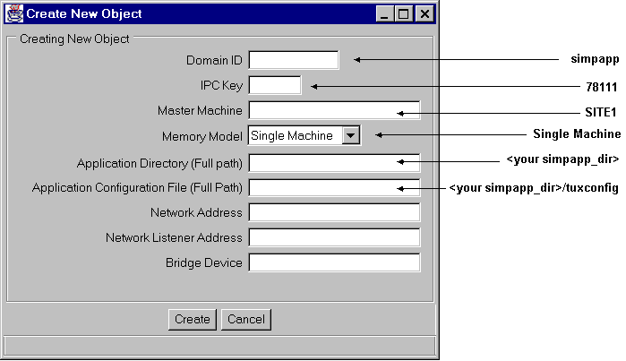

 2. Figure 1‑3 Create New Object WindowAs shown in the following figure, the tree view area of the main window displays the newly created simpapp domain.To add GROUP1 to the simpapp domain, follow these steps:
