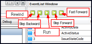

The methods for debugging the configuration are as follows. The buttons for these functions are located at the top of the EventList Window.
  1. Run: Ignore all breakpoints and process the entire transaction.
  2. Step Forward: Advance through the configuration one line at a time. On advancing, the line advanced to will be calculated and displayed. The Step Forward will step into and out of CopyBooks and Functions, as determined by the configuration.
  3. Fast Forward: Advance through the configuration to the next breakpoint. The debugger will stop on the line where the breakpoint is checked. Breakpoints may be placed in CopyBooks and Functions. If no breakpoints are set, the debugger will process the entire transaction.
  4. Step Backward: Step back one line in the configuration. This will “undo” or “clear” the step that was just performed, and take the user to the previous step, calculating and displaying that step as if the one that occurred after it was never determined.
  5. Rewind: Return to the beginning of the configuration, allowing the user to start debugging over. All prior values calculated and displayed will be cleared, with the exception of the input values.

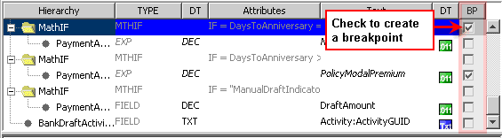

Another debugging feature is the ability to set-up breakpoint(s) in the configuration. Breakpoints are places in the code where execution is stopped for debugging purposes. In the Rules Palette, select as many breakpoints as needed by checking the BP checkbox. After breakpoints are selected, use the Run button play button in EventList window to step through configuration.
Important: Breakpoints can be set for a loop that then displays math variables and associated values for each iteration of the loop. Use the Run button play button to step through each iteration of a loop.
Breakpoints in debugging
Breakpoint Column on Debug Pane
To clear all the breakpoints, select the Clear All Clear All button button.
