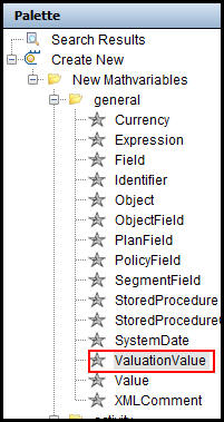

The ValuationValue math variable indicates that the math variable will retrieve a value from the math valuation object. Data created in the MathStatement valuation can be retrieved using the syntax of the ValuationValue math variable type. This math variable type should only be used in transaction math and not in attached rules or screen math.
Data may only be extracted from the math statement valuation object inside transaction math. It is not available in business rule math sections or spawns.
ValuationValue Math Variable in Palette Window
Drag and drop the ValuationValue math variable from the Palette window onto the Math Pane. Enter the following information for the math variable.
