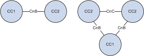

The following diagrams illustrates possible compound model structures, showing configurable components and their relationships (connections):
Configurable component
Single configurable component and connection
Multiple configurable components and connections
You can template connections by defining them as Connection Types, as CnB is a connection type suitable for joining CC1 and CC2.

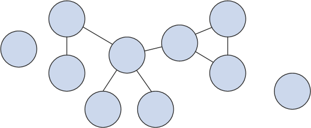

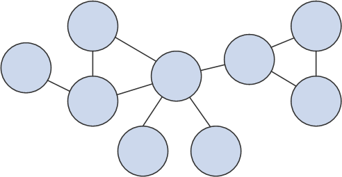

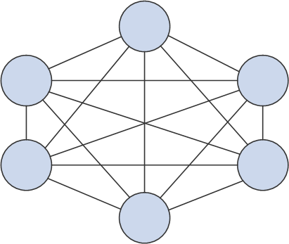

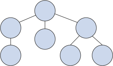

The Configurator provides you the flexibility to structure your compound model in several ways:
Tree
Network
Mesh
Arbitrary

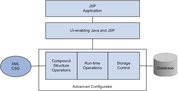

Architecture
Compound structure components extend the Configurator, which runs on the WebLogic application service. The compound structure extensions include Java classes and JavaServer Pages:
Compound model component hierarchy
Some Compound Structure Java classes work behind the scenes to enable you to:
Create multiple instances of models and configure them.
Constrain the selection point of one model against the selection point of another.
Other Compound Structure Java classes give you a public API that enables you to create JavaServer Pages that let your user dynamically create, configure, and verify a configuration based on a compound model.
