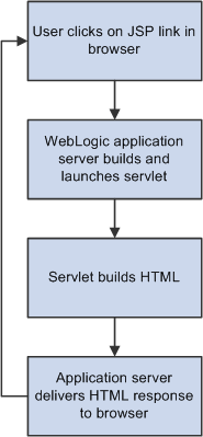

The web server passes incoming user requests to an application server specified by the port number portion of the URL. The application server converts the JSP source into pure Java source (for a servlet implementation). Then the application server runs the newly created servlet in its servlet engine. The output of the servlet is a stream of HTML text that the application passes to the web server to return to the user’s browser.
The following diagram shows the flow of communication between the midtier and the user:
Flow of communication between the midtier and the user

Whenever the user loads a JSP page in a browser, the WebLogic application server converts the JSP into a servlet JAVA file and a corresponding servlet CLASS file that implements the servlet interface. These files live securely on the machine hosting the WebLogic server, not in the browser. The WebLogic server then runs the servlet, which generates HTML that is served back to the browser. During a Configurator session, the user is linking to and loading JSP pages, yet only sees HTML output in the browser.
Note. You can compare the JSP source (on the midtier server) with the generated HTML (in the user’s browser: use the View/Page Source menus).
The following diagram shows the transition from JSP source code to an executing servlet:
JSP executes on the midtier and displays HTML in the browser
Note. This compilation only occurs the first time that the JSP page is requested; however, if that JSP source file is modified, then WebLogic recompiles it.
