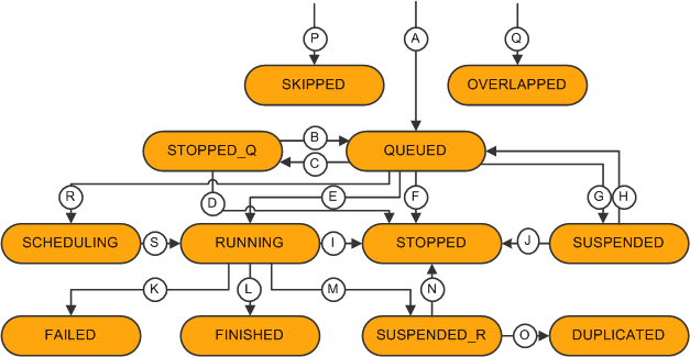

Scheduler State Tree DiagramThe following diagram shows the various scheduler states and their relationships; the letters in the diagram are keyed to the table below.
Scheduler State Tree diagram
Letter |
Description |
A |
New scheduled event created for a single or repeating event. |
B |
Stopping a QUEUED job in the Control Center. |
C |
Restarting a STOPPED_Q job in the Control Center. |
D |
Deleting the trigger from Online Marketing. |
E |
Scheduled job is activated by the Scheduler and starts running. |
F |
G |
Putting the dialog in Paused or Broadcast Hold status from Online Marketing. |
H |
Returning the dialog to Live status. |
I |
J |
K |
Job failed—set by the DES. |
L |
Job finished successfully. |
M |
Job stopped by the Control Center. |
N |
O |
Returning a Broadcast Hold dialog to Live status—a new event is created and this event is left in a DUPLICATED state. |
P |
Repeating Date/Time Trigger created a SKIPPED event. |
Q |
Repeating Date/Time Trigger created an OVERLAPPED event. |
R |
Scheduler gets ready event, marks itself as owner, and marks it SCHEDULING to run. |
S |
Schedule event handler receives the event and starts processing it by marking it RUNNING. |

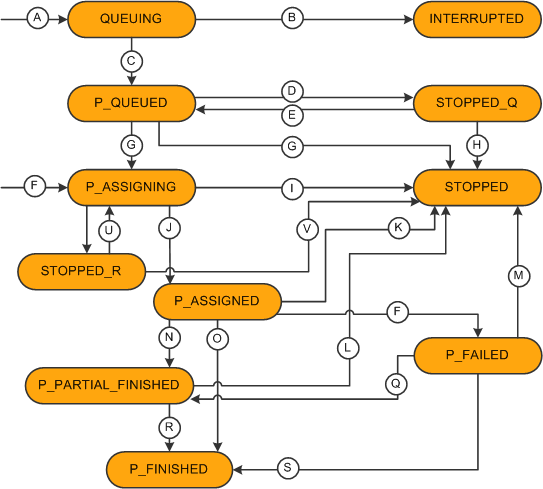

Parent Mail JobsThe following diagram shows the states of parent mail jobs and their relationships; the letters in the diagram are keyed to the table below.
Parent Mail Job diagram
Letter |
Description |
A |
New mailjob created by DES—deduping in progress. |
B |
Mailjobs that were left in a QUEUING state when the application server crashed during a dedup. Cleaned up on the next run of the scheduler and marked INTERRUPTED. |
C |
Job is finished deduping and is determined to be a large job. Ready for Mailcasters to start work. |
D |
Job is stopped in Control Center while in P_QUEUED state. |
E |
Job is restarted from the Control Center. |
F |
Job in progress by a Mailcaster. A new child mail job has been created. Not all mails have yet been apportioned by Mailcasters. |
G |
Online Marketing stops the dialog. |
H |
I |
J |
All mails have been assigned to Mailcasters. The last child job has been created. |
K |
L |
M |
N |
Job completed with some child jobs FINISHED and some FAILED. |
O |
Job completed with all child jobs FINISHED. |
P |
Job completed with all child jobs FAILED. |
Q |
Child job restarted by Control Center and some finish and some fail. |
R |
Child job restarted by Control Center and finishes. |
S |
T |
Job is stopped from the Control Center. |
U |
V |

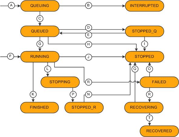

Small and Child Mail JobsThe following diagram shows the states of small and child mail jobs and their relationships; the letters in the diagram are keyed to the table below.
Small Mail Job diagram
Letter |
Description |
A |
New mail job created by DES—deduping in progress |
B |
Reboot recovered mail job that was in a QUEUING state when the system was started. |
C |
Job is finished deduping and determined to be a small job. Ready for Mailcasters to start work. |
D |
Job is stopped in the Control Center. |
E |
F |
New child job created by parent job in P_ASSIGNING or P_ASSIGNED state. |
G |
Mailcaster picks up job and starts running it. |
H |
I |
J |
K |
The job finishes successfully. |
L |
Job is stopped by the Control Center—the STOPPING state will last until the Mailcaster fully stops the job. |
M |
Job fails. |
N |
O |
P |
After the job has successfully stopped, the job state is set to STOPPED_R. |
Q |
R |
Job is restarted by the Control Center. |
S |
T |
Recovery is complete. A new job is created to run the recovered job and this event remains in the RECOVERED state. |

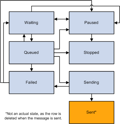

Frequency Queue Email StatesThe following diagram shows the states of frequency queue email jobs and their relationships.
State |
Label |
Description |
QUE |
Queued |
Email is ready to send. |
FAIL |
Failed |
Email failed in either rendering or delivery |
SEND |
Sending |
Email service is in the process of sending the email. |
WAIT |
Waiting |
Email is in a wait state. |
PAUS |
Paused |
Email has been paused. |
STOP |
Stopped |
Email has been stopped. |
