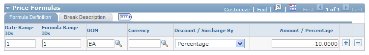

Price action types support a range of methods used for calculating pricing adjustments. Based on the selected action type and adjustment method, the system updates the display and label of numeric and textual fields so that adjustment information can be entered appropriately. This screenshot shows how the Price Formulas section looks like for the Discount/Surcharge price rule action type:
Price Formulas section of the Formulas page
This table lists the adjustment methods that each price rule action type supports, the fields that appear based on selected adjustment method, and the labels of the fields that are updated based on the selected rule action type and adjustment method:
Note. For discount or surcharge action types, use a negative number to indicate discount amounts or percentages, for example, -10 for a discount of 10 percent or dollar amount. A positive number represents surcharges by percentage or amount.

Price Formulas - Formula Definition
Use this section to define price formulas. A price formula comprises at least a date range and a formula range that further specifies when and which transactions that the price rule deems applicable. It also includes the price action details that the system needs to process the price adjustment when this rule is applied.
Fields in this section vary depending on the price action type and price type selected.
Date Range IDs |
Enter the ID of the date range that transactions must match for the formula to apply. If you want to include multiple date ranges to a formula, separate the IDs by commas (for example, 1,2,3). If multiple IDs are specified, transactions must meet all the date range conditions in order for the price rule formula to apply. |
Formula Range IDs |
Enter the ID of the formula range that transactions must match for the formula to apply. If you want to include multiple formula ranges to a formula, separate the IDs by commas (for example, 1,2,3). When multiple IDs are specified, transactions must meet all the formula range conditions in order for the price rule formula to apply. |
UOM (unit of measure) |
Enter the unit of measure that transactions must match for the formula to apply. If not provided, all unit of measures are considered. |
Frequency and Recurrence |
Specify how often and the number of times that price adjustments by this recurring price rule need to occur. If recurrence is not specified, price adjustments on the recurring charge are offered as long as the customer of the order has the service. Frequency is required for recurring price rules. These fields appear if the price rule is set to apply to recurring price calculations. |
Currency |
Specify the currency in which the price formula is measured. If not provided, apply to all currencies. |
Discount/Surcharge By |
Select how the discount or surcharge adjustment is performed. This field appears if the selected price action type is Discount/Surcharge or Total Order Discount/Surcharge. Values are: Amount: Indicates that the adjustment is by amount. Amt & Expr (amount and expression): Indicates that the adjustment is a calculated value derived by the amount or an expression. Expression: Indicates that the adjustment is derived from a specific expression. Ext Class (external class): Indicates that the adjustment is derived from an external class. Pct & Expr (percentage and expression): Indicates that the discount is a calculated value derived by a percent or an expression. Percentage: Indicates that the adjustment is by percent. Important! To indicate a discount, enter a negative value for the amount or percentage. A positive value indicates surcharge. |
Amount/Percentage |
Enter the adjustment amount (or percent) if the discount (or surcharge) by value is either Amount or Amt & Expr. Important! Enter negative numbers for discounts and positive numbers for surcharges. |
Class/Expression |
Enter the external class (or mathematical expression) to use in the price formula. This field appears if the discount (or surcharge) by value is Amt & Expr, Expression, Ext Class, and Pct & Expr. |
Small or Large |
Specify which net price (smaller or larger) to use as the final net price. If the selected price action type is either a discount or surcharge (discount/surcharge by value: Amt & Expr or Pct & Expr) , or a price override (price override by value: Prc & Expr), Enterprise Pricer performs two calculations and chooses either the larger or the smaller net price based on the selected value of this field. For example, the product's list price is 100 USD. The formula is specified as discount by amount and expression and the smaller net price is used. The discount amount is -10 and the expression is LIST_PRICE * 0.95. Discount by –10 results in a net price of 90. The expression is evaluated as 100 * 0.95=95. Because 90 is smaller than 95, a discount of –10 is applied for a net price of 90. This field appears if the selected discount (or surcharge) by value is either Amt & Expr or Pct & Expr, or if the selected price override by value is Prc & Expr. |
Free Period By |
Select Quantity as the criterion that is used to apply free promotions to orders with recurring charges. This field appears if the selected price action type is Free Period Promotion. When you define a free period promotion price rule, specify the free period by value as well as the number of times that the recurring charge should be waived in the Quantity field. For example, if the specified quantity is 3, and the free period promotion price rule is applied to an order with a cell phone for 30 USD per month, then the first three months are free. If you want the free period promotion price rule to be applicable only to transactions with certain UOM or frequency (or both), specify the values in the corresponding fields; transactions must match these values for the formula to apply. |
Product Add By |
Select how the giveaway or product add is performed. Values are: BOGO (buy one get one): Enterprise Pricer computes the quantity of the promoted item given away by summing the quantities from the order that match the price rule and dividing them by the BOGO factor, and taking the whole number. BOGO & Prc: Discounted giveaway, for example, buy one product and get another product at half price. Specify the BOGO factor used to calculate the quantity of the selected product to be given away at a price that is computed using a mathematical expression. Qty & Prc: Specify the product add quantity to be given away at a price that is computed using a mathematical expression. Qty Expr: Specify the mathematical expression used to calculate the product add quantity to be given away. Quantity: Specify the product add quantity to be given away. |
Quantity/BOGO Factor |
Enter the quantity to be used in the product add formula, or the factor that is used to calculate the product add quantity in the BOGO-specific product add formula. This field appears if the selected product add by value is any but Qty Expr This is the formula used to compute the final product add quantity for BOGO-specific product add formula: Total Quantity of Lines Matching the Price Rule/BOGO Factor The resulting number derived from the calculation is truncated so that only the whole number is used. For example, with a BOGO factor of three, when the customer buys two they get zero free. When they buy three, four, or five items, they get one free. When they buy six, seven, or eight items, they get two free items, and so on. |
Target Discount By orTarget Surcharge By |
Select how target discount (or target surcharge) is calculated, by amount or by percent. The Target Discount By field appears if the price action type is Min/Max Target Discount; the Target Surcharge By field appears if Min/Max Target Surcharge is the selected action. |
Target Price By |
Select Price, indicating that the target price is matched by item unit price This field appears if the price action type is Min/Max Target Price. |
Min Amount/Percentage (minimum amount/percentage) and Max Amount/Percentage (maximum amount/percentage) |
Enter the lower and upper amounts or percentages for the corresponding target discount/surcharge by value. This field appears if the selected price action types is Min/Max Target Discount or Min/Max Target Surcharge. |
Minimum Price and Maximum Price |
Enter both of these values if the selected price action type is Min/Max Target Price. |
Price Override By |
Select how price override is performed. Values are: Expression: Indicates that the price is derived from a specific expression. Ext Class:Indicates that the price is derived from an external class. Prc & Expr: Indicates two prices, one on the Price field that appears and the other derived from an expression. The value of the Small or Large field determines which of the two prices to select as the final net price. Price: Indicates item price is defined by the price in the Price field. |
Price |
Enter the new price, if the price override by value is Price. This field appears if the price override by value is Prc & Expr or Price. |
