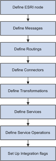

This flowchart illustrates the steps you follow to set up the ESRI integration:
ESRI integration setup

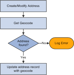

You can obtain geocodes from ESRI in synchronous real time. When you create or modify an address, the system calls ESRI to get the geocode. If the geocode is found, the system updates the address record with the geocode. If no geocode is found, the system logs an error.
This flowchart illustrates the request process for synchronous geocode addresses:
Request process flow for synchronous geocode addresses

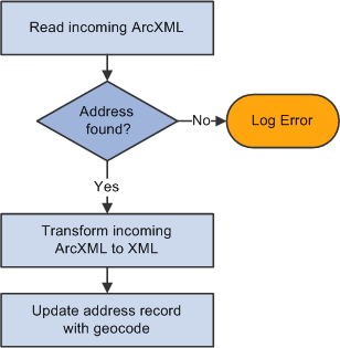

ESRI publishes the geocode for the address or intersection. If no geocode is found, an error is logged. If a corresponding geocode is found, the PeopleSoft system transforms the incoming ArcXML sent by ESRI to XML. The address record is updated with the geocode.
This flowchart illustrates the inbound process flow for geocode retrieval:
Reply process flow for geocode addresses

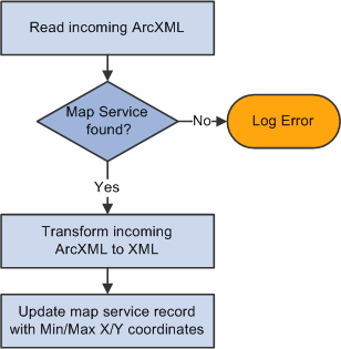

ESRI sends the map service information and the PeopleSoft system reads the incoming ArcXML. If the map service is found, the PeopleSoft system transforms the ArcXML to XML and updates the map service record with the minimum and maximum extents. The minimum and maximum X and Y coordinates appear on the Map Definition page. This flowchart illustrates the inbound process flow for updating the map service record:
Reply map service information process flow

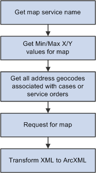

This integration is used to send a list of geocodes from either a case or service order search. A request XML is sent to the ESRI system to generate a map with geocodes that appear as dots. The PeopleSoft system gets the map service name, the minimum and maximum extents for the map, and all address geocodes associated with cases or service orders. It sends the message in ArcXML. This flowchart illustrates the outbound process flow for generating the map:
Request map generation process flow
The ESRI system responds with a URL to the image map based on the map service and geocodes. The map appears on the PeopleSoft page. This graphic illustrates the outbound process flow for generating the map:
Reply map generation process flow

To re-configure the transformations for these routings, use the fields on the pages to make any necessary changes or add new information.
Click to jump to top of pageClick to jump to parent topicDefining Services
Access the Services page (PeopleTools, Integration Broker, Integration Setup, Services, Services).
These services are used for the integration:
Service
Description
RBG_MAP_EXT_REQ_MSG
Service to get the extents of a Map Service.
RBG_MAP_REQ_MSG
Service to get a Map.
RBG_SYNC_ADDRESS_US_MSG
Service to get the geocode of an address or intersection.
To re-configure these services for your business operation, click the link under the Service field. The system displays the Service page. Use the fields on the pages to make any necessary changes or add new information.
Note. You must change the URL in the Namespace field so it coincides with your business for both the RBG and ESRI messages.
Click to jump to top of pageClick to jump to parent topicDefining Service Operations
Access the Find Service Operation page (PeopleTools, Integration Broker, Integration Setup, Service Operations, Find Service Operation).
Enter RBG in the Service field, and click Search. These services appear as search results:
Service
Service Operation
Operation Type
RBG_MAP_EXT_REQ_MSG
RBG_MAP_EXT_REQ_MSG
Synchronous
RBG_MAP_REQ_MSG
RBG_MAP_REQ_MSG
Synchronous
Synchronous
Click the link under the Service Operation field and then click the Routings tab to view the routing definitions associated with the service operation.
Click to jump to top of pageClick to jump to parent topicReviewing Routing Definitions for Service Operations
Access the Routings page (Click the Service Operation link on the Find Service Operation page. Then click Routings.).
