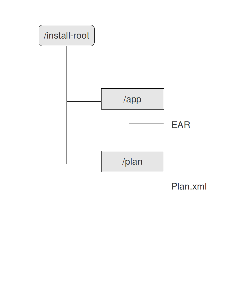

Step 3: The EAR and Plan.xml (deployment plan) are packaged under a directory named "application" in the release bundle (See the directory structure below). It is recommended to copy the "application" directory to a location (this directory will be referred as <INSTALL-ROOT> hereafter) and optionally rename the directory (for example, rename to OHIAltRe).
Step 4: To install the application using Administration Console, select the directory <INSTALL-ROOT> instead of selecting the EAR file. By default, the Administration Console will use a deployment plan named Plan.xml, if one is available in the \plan subdirectory.
