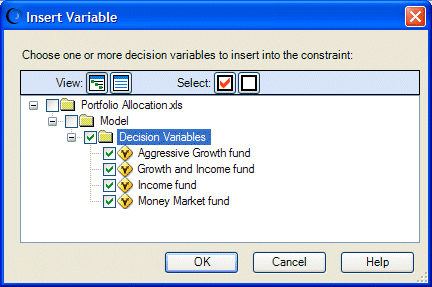

The Insert Variable dialog opens.
Since you want to include all four decision variables in the constraint formula, select each name. To select all four at once, select the box in front of Decision Variables. Then, click OK.
The variables appear in the edit box as a sum:
