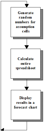

For each trial of a simulation, Crystal Ball repeats the following three steps:
Crystal Ball sequence for each trial of a simulation: generate a random number, recalculate the spreadsheet and retrieve a value from every forecast cell, and add to the forecast chart.
  1. For every assumption cell, a random number is generated according to the range you defined and then is placed into the spreadsheet.
  2. The spreadsheet is recalculated.
  3. A value is retrieved from every forecast cell and added to the chart in the forecast windows.
