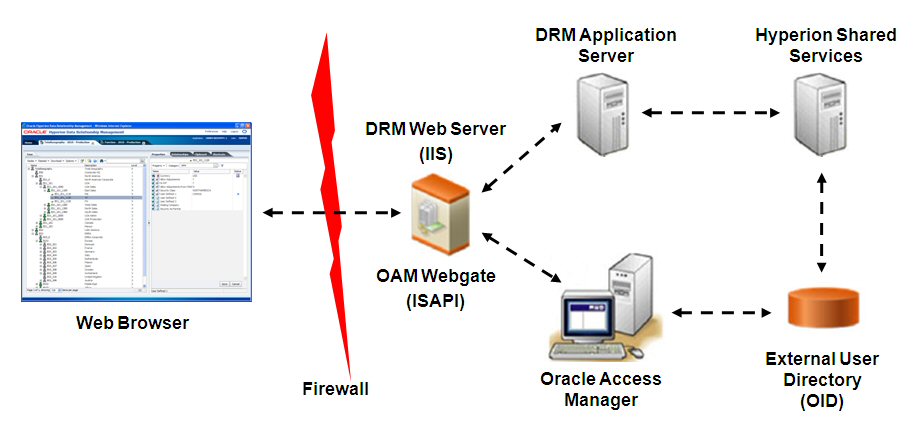

The following graphic depicts the process flow with Oracle Access Manager:
Process flow with OAM.
