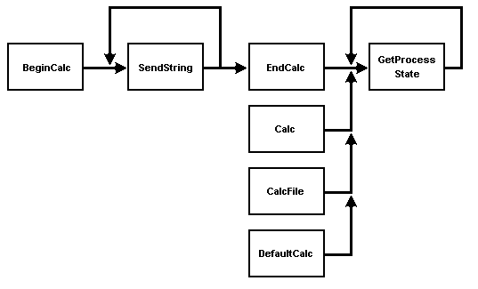

Flowchart of typical calculation operations. BeginCalc, then one or more SendStrings, then Endcalc. Then one or more  GetProcessStates, Calcs, Calcfiles, or Defaultcalcs.
Control Flow of the Calculation Functions
The default calculation is stored in the database and is executed by calling EsxDefaultCalc(). To get and set the script used for a default calculation, use EsxGetDefaultCalc() and either EsxSetDefaultCalc() or EsxSetDefaultCalcFile().

Calculations in Essbase are asynchronous operations, meaning that when the appropriate calc function is called, the API returns to the caller immediately without waiting for the calc to finish (unlike executing a report, for example). Essbase uses asynchronous calculations because a calculation can take a significant amount of time to complete (several hours is not uncommon). So, after the calculation starts, the program must check (by calling EsxGetProcessState()) at intervals to see if the calculation is complete.
The simplest way to check is to set up a system timer to wake up a process at short intervals (say 5-10 seconds), checking the status of the calculation. While the calculation is running you can perform any other operations within your program, but you can not make function calls to the Essbase API using the same context handle.
