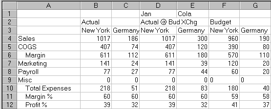

  8. Select Essbase, and then Retrieve.
    Essbase converted the New York and Germany figures to Canadian dollars (CAD).
    Performing an ad hoc currency conversion.
