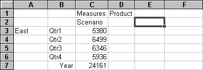

  2. On a member of the Scenario dimension (that is, cell C2, D2, E2, F2, or G2), double-click the secondary mouse button.
    Essbase collapses the members of the Scenario dimension:
    Result of drilling up on the Scenario dimension.

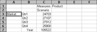

  3. In cell A3, double-click the secondary mouse button to drill up on East.
    Essbase collapses East, West, South, and Central into the Market dimension and keeps the dimension in the A column:
    Result of drilling up on East.
