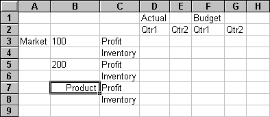

  4. In cell C3, select Actual, then select Essbase, and then Pivot.
    Essbase executes the pivot but does not retrieve data.
    Result of pivoting (Navigate Without Data enabled).
    You get the same result by pivoting any Scenario members.

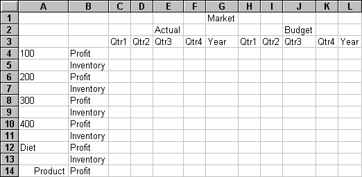

  5. In cell G1, click the secondary mouse button on Market and drag Market to product 100 (cell A4).
    Essbase executes the pivot without retrieving data:

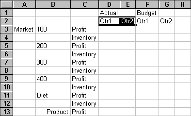

  To navigate without data when using the Keep Only or Remove Only command:
  1. Select Qtr1 (cell D2) and Qtr2 (cell E2), then select Essbase, and then Keep Only.
    Essbase retains only the selected members and does not retrieve data:

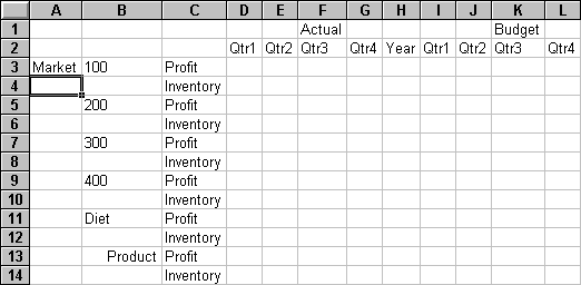

  2. Select products 300 (cell B7), 400 (cell B9), and Diet (cell B11), then select Essbase, and then Remove Only.
    Essbase executes the Remove Only command without querying the database for information:
    Result of Remove Only (Navigate Without Data enabled).

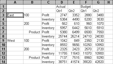

  To turn off Navigate Without Data when you are ready to retrieve data:
  1. Select Essbase, and then Navigate Without Data.
    Essbase removes the check mark next to the menu item.
  2. In cell A3, drill down (double-click) on Market.
    Essbase drills down on the Market dimension and retrieves data into the worksheet:
    Result of drilling down (Navigate Without Data disabled).
