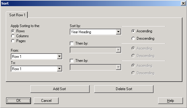

    3. Select Sort, and click Setup to display the Sort Dialog box.
      Figure 25. Sort Dialog Box
      Sort Dialog Box
  3. From Apply Sorting to the, select Rows, Columns, or Pages.
    For the Pages option, you can only select headings from the Sort by: drop-down menu. All other options are disabled.
  4. For Rows or Columns, use From and To to select the range of columns or rows to sort.
    When auto calculations is enabled, the outermost layers contains the grand total of all rows in the calculation. Sorting on the outermost layer is ignored. Also, when you select sort with auto calculation set on multiple layers, you must sort on all heading layers which have auto calculations.
  5. In the Sort by area:
    1. From the first drop-down list, select the headings or row or column on which to base the sort, then select Ascending or Descending sort order.
    2. Optional: In the Sort by area, set up one or two additional sorts:
      1. For each additional sort, select the Then by check box.
      2. From the second or third drop-down list or both, select the headings or row or column on which to base the sort.
      3. For each additional sort, select the Ascending or Descending sort order.
  6. Optional: To set up additional sorts:
    1. Click Add Sort. A tab is added to the Sort dialog box.
    2. In the tab, repeat steps 3 through 5 for the new sort.
