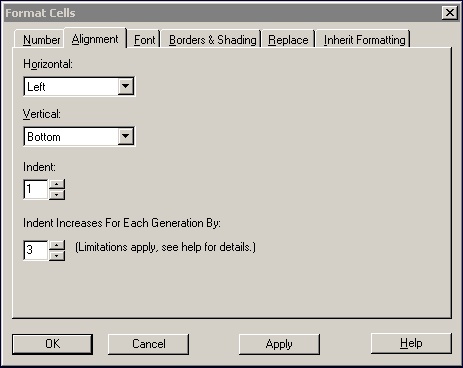

  4. Select the Alignment tab to specify alignment for the selected cells.
    Figure 20. Alignment Tab in the Format Cells Dialog Box
  5. From the Horizontal drop-down list, select an alignment option. The options are Left, Center, and Right.
  6. From the Vertical drop-down list, select an alignment option. The options are Top, Middle, and Bottom.
  7. To indent the heading and the associated text, data, or formula cells in the row, from the Indent value box, select the number of spaces to indent the values from the left cell margin.
    This control is enabled only if you selected Left from the Horizontal drop-down list.
