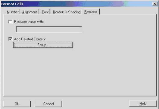

    Figure 23. Replace Tab in the Format Cells Dialog Box
  5. Select the Replace value with check box to enable the text box, then enter the replacement text in the text box.
    If the check box is selected and no text is entered in the text box, the selected cells are displayed as blank in the report.
  6. Select Add Related Content to specify related content links. The related content links will display when certain conditions are met. For conditional formatting, see Applying Conditional Formatting on Grids.
  7. Click Setup to Add Related Content dialog where you can select the related content links. See Modifying the Properties for Related Content
  8. Click Apply to apply the text replacement to your selected cells.
