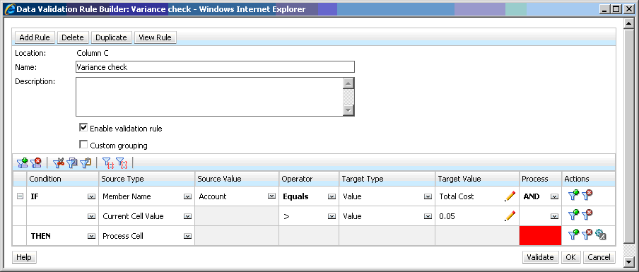

John designs the data form and adds a data validation rule at cell level, as shown in the following figure. He uses Member Name to apply the validation only to Total Cost.

Data Validation Rule at Design Time:

John defines the rule at the Variance Percent column for these reasons.
It improves performance. The rule is evaluated only on the cells in the Variance Percent column. If the rule had been assigned to YearTotal, it would have to be evaluated for all Time Periods for the current year budget.
It helps users respond to the data validation message. John can add a message to the Variance Percent column stating that the variance is higher instead of adding it to YearTotal. This way, users do not have to look for Variance Percent to determine the difference.
John could have flagged both YearTotal and Variance Percent in red if this had been part of the requirement.
