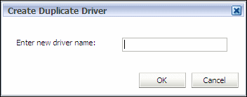

  3. Click the Duplicate Driver icon Duplicate Driver icon.
    The Create Duplicate Driver dialog box is displayed.
    Use the Create Duplicate Driver dialog box to enter the name of the new driver, and then click OK.
  4. Enter the name of the new driver, and then click OK.
    The new driver is added to the list of Driver Definitions, showing the same Type and Cost or Revenue details as the original driver.
