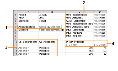

The Allocation Genealogy report calculates the allocation detail for source and destination intersections that do not have an assignment, but which have an indirect relationship.
Example of Allocation Genealogy Report Selections
Allocation Genealogy Report displays the layout of dimensions used to create the report.
The sample report above shows the layout of dimensions used to create the allocation genealogy report:
  1. AllocationType set to GenealogyAllocation
  2. All dimensions in other stages are set to NoMember.
  3. Start point intersections
  4. End point intersections
