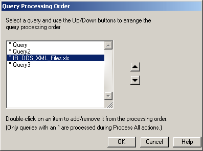

To specify a query processing order:
Select Tools, then Process Query, and then Processing Order.
The Query Processing Order dialog box is displayed.
The first time the Query Processing dialog box is displayed after the new document is created, all query sections belonging to the document are displayed in the order which they are displayed in the Section Catalog (top down). Query sections added after the sections have been arranged, are displayed at the end of the list in the order in which they were added when the dialog box is reopened.
Select a query section and move it up or down in the processing order using the arrow keys to the right.
Double click a query section to remove it from the processing order or add it back and click OK.
Only queries marked with an asterisk (*) are processed during “Process All”.
