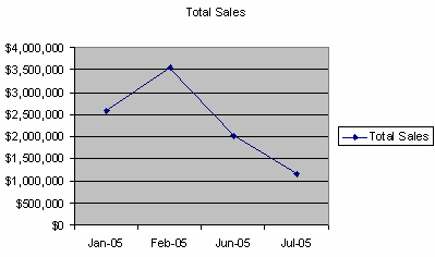

A Line Chart that has no Time Aware axis, shows the data as follows:
The four ticks corresponding to the month are arranged uniformed along the axis (the distance between them is the same. At first glance, it appears that the sales reduction trend becomes slower in the last month. If you look at the graph closer, there is no March to May period.

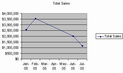

If you add a Time Aware axis, the same chart looks like this:
This chart shows every month on the present time values; even month for which there is no data. Sales for the last month drop quickly.
