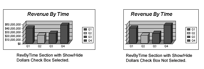

Note: | The rest of this exercise associates a script with the check box. The script turns on or off the display of revenue values (the ShowIntervalValues property) of the RevByTime chart. |

Toggle to Run mode, press Ctrl+D, and test how the check box works.
You have just learned to associate a script with a check box.
