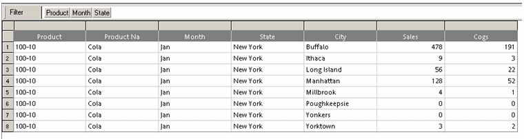

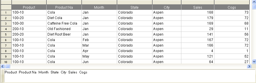

The relational section includes:
The initial results of the relational query are:
The following topic mappings are defined for the drill through:
Table 50. Mapping of Relational topics to OLAP Dimensions for Drill Through
| Relational | OLAP |
| Details.State | Market |
| Details.Product | Product |
| Details.Month | Year |
When the context of New York is 100-10, and Jan. is passed in the CubeQuery, these results are displayed in the relational query:
