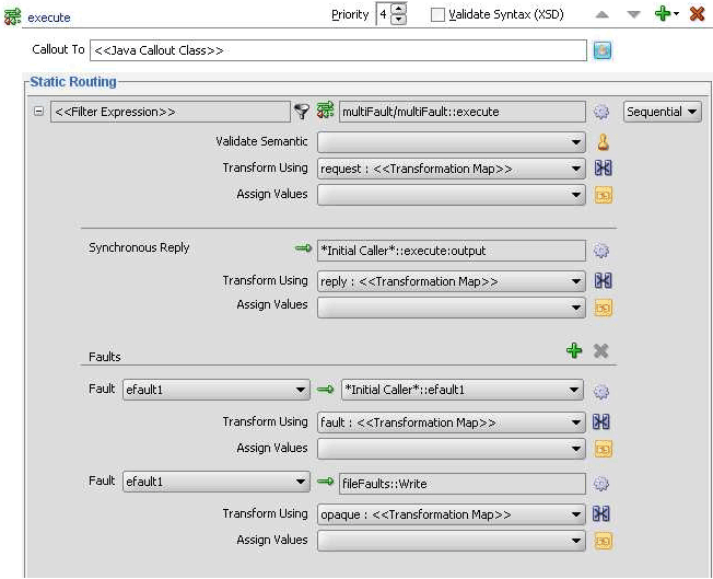

A static routing rule is not expected to change depending on the invocation context. In this case, the routing can be an echo, a routing to another service, or a publishing of an event.
When you define static rules, you can specify the following types of information:
Target Service
Mediator sends messages to the target service you specify. This service can either be defined as a WSDL interface or a Java interface. For information about invoking a target service, see Section 20.3.2.1, "How to Specify Mediator Services or Events".
Execution Type
Mediator executes routing rules either sequentially (that is, running in the same thread) or in parallel (running on different threads). For information about specifying an execution type, see Section 20.3.2.3, "How to Specify Sequential or Parallel Execution".
For synchronous service invocations, the routing rule should always be sequential.
Reply, Callback, and Fault Handlers
You can define how Mediator handles synchronous reply, callback, and fault messages. For information about handlers, see Section 20.3.2.4, "How to Configure Response Messages," Section 20.3.2.7, "How to Handle Faults," and Section 20.1.1.2, "Static Routing Rule Components."

Static routing rules define the following components:
Request Handler: Defines how Mediator handles incoming requests.
Reply Handler: Defines how the synchronous response from the called service is handled by Mediator.
Fault Handler: Defines how the named or declared faults from the called service are handled by Mediator.
Callback Handler: Defines how the asynchronous response and callback from the called service are handled by Mediator.
Timeout Handler in Callback: Defines how long Mediator waits for the asynchronous response and callback before performing timeout handling for the particular asynchronous request.
Event Publishing and Service Invocation: Calls other services or publishes an event depending on the configuration of the handlers.

If you create a new routing rule in which the target service operation has one or more faults, you still see a single fault routing section in the Mediator Editor. If the source Mediator service component supports one or more faults, then the fault is routed back to the caller by default. You can choose the source and target fault names to be routed. You can also use the service browser to route the fault to another target.
To define an additional fault routing:
The following steps are performed in the Routing Rules section of the Mediator Editor.
In the Faults section, click the Add another fault routing button shown in Figure 20-10.
Another fault section appears in the routing rule box.
Configure the target service, transformations, and assign values for the new fault.
Figure 20-11 shows a second fault being routed to a file adapter service.
Figure 20-11 Second Fault Added to Routing Rules
You can route the same fault to multiple targets using different transformations.

Java callouts enable you to use external Java classes to manipulate messages flowing through the Mediator. Only one Java callout is supported per operation or event subscription. The callout class must implement the oracle.tip.mediator.common.api.IjavaCallout interface. Callouts are available for both static and dynamic routings. Figure 20-27 shows a sample Mediator with two operations, in which both the operations have one routing rule each and the first operation has a callout class.
Figure 20-27 Sample Mediator Supporting Java Callout
To make Java callout classes available:
You must ensure that the Java callout class is available on the server. You can use any of the following methods for this:
Copy the Java class to the SCA-INF/classes folder.
Copy the JAR file containing the Java class to the SCA-INF/lib folder.
Copy the JAR file containing the Java class to the $DOMAIN_HOME/lib folder.
If you want to make the Java callout class available to multiple Mediators, copy the JAR file containing the Java class to the $DOMAIN_HOME/lib folder.
To enter the Java class for the callout:
You can either manually enter the Java class or select a class from the Class Browser.
To manually enter the name of the Java callout class, start typing the class name in the Callout To field, as shown in Figure 20-28. The auto-completion feature of Oracle JDeveloper completes the address and the classes in the current project.
To select from a list of available classes, click the Select Java Callout Class icon.
The standard Oracle JDeveloper class browser appears, as shown in Figure 20-29.
The class browser is filtered so it only displays classes that implement the oracle.tip.mediator.common.api.IjavaCallout interface.
