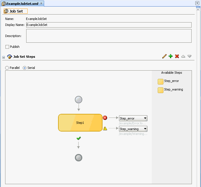

To add serial job set steps:
First, define the appropriate job definitions or job sets and define the parent job set to contain the steps.
In the Job Set Editor pane, in the Job Set Steps area, select Serial execution mode.
Click the Add icon to add a job set step. This displays the Add Step window.
In the Step ID field, enter the step ID. For example, enter step1.
In the Job field, from the dropdown list select a job definition or a job set to associate with the step. For example, select Job1.
If you need to define step level application defined properties, then select the Application Defined Properties tab and add properties for the step.
If you need to define step level system properties, then select the System Properties tab and add job set step system properties for the step.
Select a destination for the step. The step can be added as part of the job set by selecting Insert into main diagram. To make the step available for use in another step, for either error or warning states, select Add to list of available steps.
Click OK, this adds the job set step, as shown in Figure 12-2.
From the dropdown list next to the error icon, select Stop or select the step for the ERROR terminal state for the step. For example, from the dropdown list select Step_error (Step_error needs to be defined).
From the dropdown list next to the warning icon, select Stop or select the step for the WARNING terminal state for the step. For example, from the dropdown list select Step_warning (Step_warning needs to be defined).
Click the Add icon and add additional steps as needed.
Click OK, as shown in Figure 12-3.
