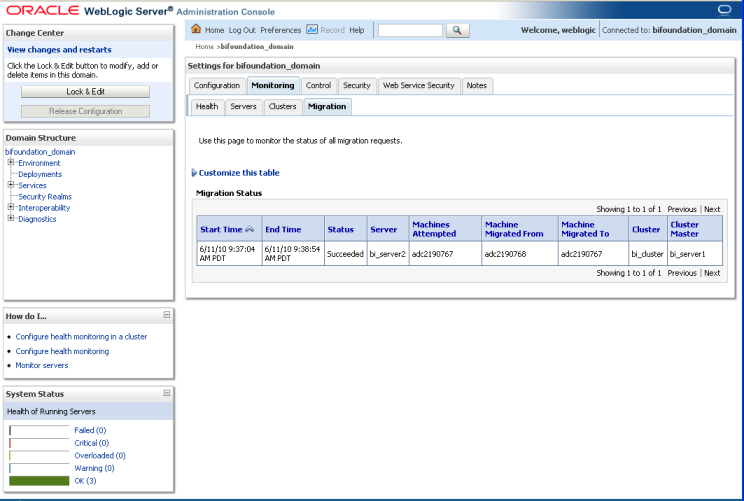

Verification From the Administration Console
Perform the following steps to verify migration in the Administration Console:
Log in to the Administration Console.
Click Domain on the left console.
Click the Monitoring tab and the Migration tab.
The Migration Status table provides information on the status of the migration, as shown in the following image:
After a server is migrated, to fail it back to its original node or computer, stop the Managed Server from the Administration Console and start it again. The appropriate Node Manager starts the Managed Server on the computer to which it was originally assigned.
