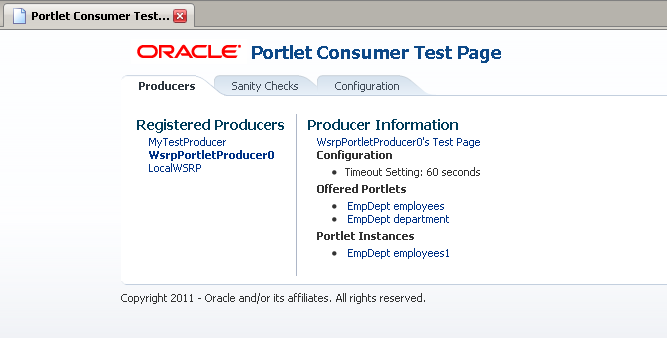

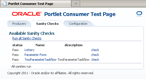

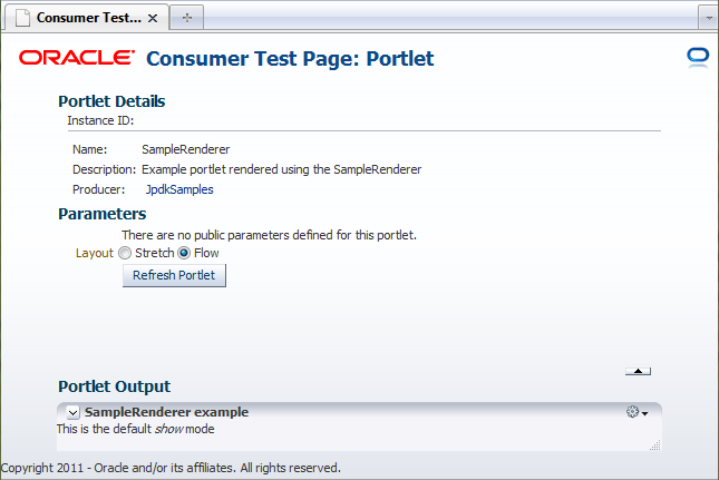

Portlet Consumer Test Page
A page that provides diagnostic information about the consumer application. You can access the Portlet Consumer Test Page using the following URL:
http://host:port/context-root/faces/oracle/portlet/client/adf/diagnostic/pages/ConsumerTestPage.jspx
where:
host
is the server to which the consumer application is deployed
port
is the port to which the server is listening for HTTP requests
context-root
is the consumer web application's context root
For example:
http://mymanagedserver.example.com:8888/myapp/faces/oracle/portlet/client/adf/diagnostic/pages/ConsumerTestPage.jspx
For more information, see Section 13.1.6.1.2.

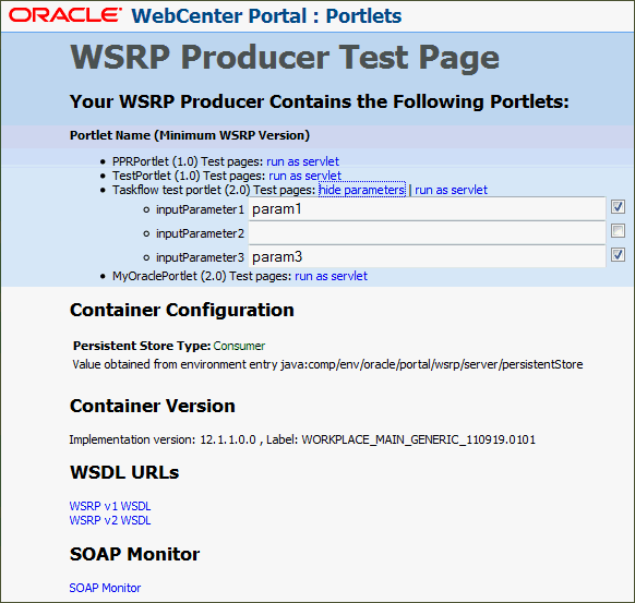

Producer Test Page
A page that provides diagnostic information about the portlet producer application. You can access the Producer Test Page using the following URL:
http://host:port/context-root/info
where:
host
is the server to which the portlet producer is deployed
port
context-root
is the producer web application's context root
For example:
http://portlets.example.com:9999/sample/info
The Producer Test Page includes a link to the Web Service Definition Language (WSDL) document to use for registration, for example:
http://portlets.example.com:9999/sample/portlets/wsrp2?WSDL
For more information, see Section 13.1.6.1.3.

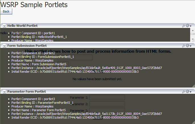

Running a producer as a servlet application through Faces
This is also known as running the application as a servlet. Before an application can act as a portlet provider, it must be able to run correctly through standard HTTP requests.
To run an application as a servlet, use the following URL:
http://host:port/context-root/faces/path-to-page/page.jspx
where:
host
port
context-root
path-to-page
is the path to the page you want to run
page
is the name of the page you want to run
For example:
http://portlets.example:9999/sample/faces/index.jspx
The Producer Test Page provides links to run such pages or task flows as servlets. For more information, see Task 2, "Run the JSF Portlet as a Servlet".

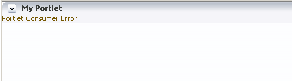

The message Portlet Consumer Error
(shown in Figure 13-1) typically indicates that an error occurred within the operation of the portlet parts of the portlet consumer application.
Figure 13-1 Portlet Displaying a Portlet Consumer Error
Problem
An error has occurred within the operation of the portlet parts of the portlet consumer application. In other words, the error is unrelated to the remote portlet producer application.
Solution
Consult the diagnostic log file to determine the cause of the exception. For information about portlet logging, see Section 13.1.6.2.
The exception that caused the error message to be displayed is logged. Wherever possible, a message is included in the log at the start of the exception stack to indicate for which portlet binding the exception occurred. Example 13-1 shows a message logged for a portlet error.
Example 13-1 Example Message Logged for a Portlet Error
<PortletRenderer> <setErrorState> An error has occured for Portlet Binding portlet1. oracle.portlet.client.container.PortletContentTypeException: Unexpected content type "null" in WSRPGetMarkup response. ...
Pay particular attention to the cause exceptions in the stack as this is likely to indicate what the real underlying problem is.
The cause is likely to be an internal error and the appropriate course of action is to contact Oracle Support with the log files of the consumer application.

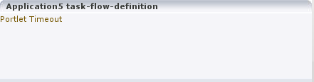

If a Portlet Timeout
message is displayed in the area of the page that you would expect to contain a portlet (as shown in Figure 13-2), this means that the consumer waited for a configured period of time for the producer to respond and did not get a response during that time, or the response did not complete during that time. There are a number of possible causes.
Figure 13-2 Portlet Displaying a Portlet Timeout Error
Problem 1
The producer machine is overloaded.
Solution 1
Check the load on the producer Managed Server (the tools used to do this vary depending on the operating system that is running on the producer). If the load is high, check whether a particular process is causing this high load, and whether such a process could be run on another machine, or at a less busy time. If no single process is causing the high load, or if the Oracle WebLogic Server is causing the high load, and if the load is consistently high, consider whether the producer hardware is adequate, or whether it is necessary to upgrade it (or add further nodes to the cluster). Also consider adjusting the Oracle WebLogic Server configuration to increase the size of the request thread pool. For more information, see the "Tuning WebLogic Server" chapter in Oracle Fusion Middleware Performance and Tuning for Oracle WebLogic Server.
Problem 2
The network is overloaded, or there are problems with the network affecting communication between the consumer and producer.
Solution 2
Check that you can ping the producer machine from the consumer machine. Check that you can access the producer's WSRP Producer Test Page in your local browser (for information, see Useful Resources). If this works, check that you can access this same page from a browser running on the consumer machine. If any of these steps cause problems, and the machine is not overloaded, this could be a network problem, which should be investigated by a system administrator.
Problem 3
The log or trace files indicate that there is a deadlock (or a stuck thread) on the producer machine causing the request thread to hang.
Solution 3
This should not happen during normal operation. If it does occur, there will generally be an error in the producer's log files indicating the point at which the deadlock occurred. This may help diagnose the problem. In some cases, it may be possible to alleviate this by modifying the configuration of Oracle WebLogic Server. For more information, see Oracle Fusion Middleware Performance and Tuning for Oracle WebLogic Server.
Problem 4
The producer application is running slowly (for example, due to processing large quantities of data).
Solution 4
In this case, the producer application may be processing large quantities of data, causing it to spend too long building the response. If the application will regularly deal with large quantities of information, it may be necessary to either add or improve producer hardware. If this is not possible you can increase the portlet timeout duration.
For information about how to configure the portlet timeout, see Solution 5.

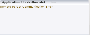

When a section of the screen shows the Remote Portlet Communication Error
message (as shown in Figure 13-3), and there is an otherwise blank region surrounding it, this area is expected to be filled with a portlet, which the application is not able to contact.
Figure 13-3 Portlet Displaying a Remote Portlet Communication Error
Problem 1
The producer is down.
Solution 1
It could be that the producer application is not running, or the Managed Server on which it is deployed is not started. In this case, it will need to be started. Identify the application that needs to be started based on the task being attempted at the time of the portlet failure. For more information, see Section 13.1.6.1.1.
Problem 2
The producer log files indicate that the web services security is incorrectly configured.
Solution 2
In Oracle Fusion Applications deployments, web services security (WS-Security) is managed with global web services security policies.
Troubleshooting steps for web services security depend on the type of security profile being used, for example AuthN, SSL, or Message Security.
For more information about troubleshooting web service security, see:
The "Diagnosing Problems" chapter in the Oracle Fusion Middleware Security and Administrator's Guide for Web Services
For information about the different types of security profile, see the "Locking Down Web Services: Points to Consider" section in the "Hardening Backchannel Network and Services" chapter of the Oracle Fusion Applications Security Hardening Guide.
The security policies set on the portlet producer's WSRP_v2_Service
web service ports are as follows:
WSRP_v2_ServiceDescription_Service
port: oracle/no_authentication_service_policy
WSRP_v2_PortletManagement_Service
WSRP_v2_Markup_Service
port: no policy specified, so that it picks up the globally attached policy
WSRP_v2_Registration_Service
If the producer ports are configured in any other way, then it may be the cause of the problem. In particular, if a local policy is applied to the WSRP_v2_Markup_Service
port, and the policy does not match the corresponding policy on the producer connection, then the port or the connection will need to be updated to specify matching policies, or be removed, so that the globally attached policies can take effect.
Problem 3
The producer Managed Server cannot be reached.
Solution 3
The producer may be in a location that cannot be reached by the consumer application, due to intervening firewalls or incorrect routing rules. In an environment that is installed by Oracle's provisioning software, this should not be the case, but it is worth checking that you are able to access the WSDL endpoint for the producer from the machine hosting the consumer, by going to:
http://host:port/context-root/portlets/wsrp2?WSDL
Where:
host
port
context-root
For example:
If you cannot reach the WSDL endpoint, contact your network administrator.

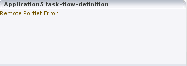

If the portlet displays a Remote Portlet Error
message (as shown in Figure 13-4), this indicates that the producer responded with an error message. The error message is returned in the form of a SOAP fault message inside the response document. There are a number of reasons the producer might return an error. The best strategy to diagnose these errors is to first find the corresponding exception stack trace in the consumer diagnostic logs (see Section 13.1.6.2). This stack trace shows what kind of fault was returned by the producer, plus any further information required in the response. Some faults you may encounter are listed in the following sections.
Figure 13-4 Portlet Displaying a Remote Portlet Error
Problem 1
OperationFailedException
. This is the most common type of Remote Portlet Error
and it is a catch-all for most unhandled exceptions raised in the producer application.
Solution 1
To resolve an OperationFailedException
, examine the exception in the consumer diagnostic logs. This generally shows any exception that was raised in the producer application to trigger the fault response as the final Caused by
exception.
If required, you can then examine the diagnostic logs on the producer application for more detail, or for any related exceptions that occurred prior to the fault being triggered. In some cases, the exception in the producer log indicates a problem that can be simply resolved, such as a database connection failure or configuration problem. In other cases, the exception might indicate a product bug.

If you encounter a portlet error message when a portlet is rendered, or if the portlet displays but you cannot interact correctly with it, there are some general steps using these tools that you should follow to diagnose the issue.
The first step when you encounter a portlet error, is to identify which portlet producer and portlet instance is being invoked. Execute the portletDebugShow()
JavaScript from your browser to display this information over the top of the main portlet content.
To identify the portlet instance:
Enter the following command in the Location field of your browser:
javascript:portletDebugShow()
Tip:
In Internet Explorer and Google Chrome, you must type this command in the Location field. If you paste the command into the field, the javascript
piece is removed.
In Firefox 6 and above, you cannot enter JavaScript in the Location field, you must enter the command in the JavaScript Console.
After running the script, every portlet now displays the following information:
Producer name
Portlet name
Portlet instance ID
Execution Context IDs (ECIDs)
The ECIDs are unique IDs used to identify a portlet request. Use the ECIDs to correlate the messages across different consumer and producer log files using Fusion Applications Control. The same ECID is propagated from the consumer to the producer. For more information, see the "Correlating Messages Across Log Files and Components" section in the Oracle Fusion Middleware Administrator's Guide.
Broken portlets show two ECIDs: one for the request in which the error occurred and one for request in which the error was reported.
For IFRAME portlets, for example Oracle JSF Portlet Bridge portlets, the ECIDs are different. This is because the error is reported in a later request than the one in which the original exception occurred. When checking the logs, you should look for both ECIDs, as either may contain relevant information.
Tip:
If you cannot see all of the information due to the size of the portlet, you can click anywhere within the diagnostic information to display it in a separate panel that is not confined to the portlet dimensions.
You can use this information in the subsequent diagnostic steps to help locate the issue.
The ECIDs shown in the portlet diagnostic information do not reflect partial page rendering requests that have been made to the portlet producer (using the portlet consumer resource proxy). These requests may update the portlet, but the ECIDs are not recorded in the portlet diagnostic information. Errors that occur during these requests are logged on the producer and by the portlet resource proxy on the consumer but you cannot use the ECID information reported in the portlet diagnostic information to help you determine the ECIDs for the relevant log entries.
When you have finished debugging the portlets, enter the following command to hide the portlet debugging information:
javascript:portletDebugHide()

The next step in diagnosing a portlet error is to access the Portlet Consumer Test Page (shown in Figure 13-5) to locate the portlet producer and, if necessary, test the portlet in isolation.
Figure 13-5 The Portlet Consumer Test Page
The Portlet Consumer Test Page contains three tabs:
Producers: This tab lists all the producers registered with the consumer application. Selecting a producer provides specific information about that producer.
Sanity Checks: This tab may contain a predefined set of portlet instances and required parameters that can be run in the consumer application, as configured by the consumer application developer. Any failures within these portlets indicate a problem with the corresponding producer and/or portlet.
Configuration: This tab enables you to identify the consumer configuration entries for portlet consumption. You cannot change these values as they are stored within the application; they are displayed for reference information only.
After accessing the Portlet Consumer Test Page, you can perform further diagnostic steps.

The Producers tab of the Portlet Consumer Test Page lists all the producers that have been registered with the consumer application. If a portlet instance in your application displays an error message, you can view information about the producer that owns the portlet by selecting it on this tab.
To locate the portlet producer:
In the Portlet Consumer Test Page, select the portlet producer that owns the portlet instance that is reporting the error.
You noted this information in Section 13.1.6.1.1.
The following information is provided for the selected producer:
Producer Test Page: A link to the Producer Test Page.
Configuration: Details of potential issues surrounding skins, security, and timeouts associated with the using producer.
Offered Portlets: A list of all portlets offered by the producer. If there are no offered portlets listed, this indicates that there is a problem with the registration metadata for the producer.
Portlet Instances: A list of all portlet instances for the selected producer in the consumer application. This list may be empty.
You can use this information to identify potential issues with the producer.

To locate and run the portlet instance:
Under Portlet Instances, select the portlet instance to display the Consumer Test Page: Portlet page.
The Portlet Consumer Test Page: Portlet page renders the portlet in a standalone page. If the portlet runs correctly on this page, the problem is most likely caused by other components on the page containing the broken portlet.
The Parameters section enables you to experiment with how the portlet looks using a stretch or flow layout.
If the portlet accepts parameters, the Parameters section also lists all the public parameters for the portlet. Enter values for any parameters to test that the portlet is receiving parameters correctly.
To navigate back to the Portlet Consumer Test Page, click the producer name link at the top of the page.
The Sanity Checks tab of the Portlet Consumer Test Page (shown in Figure 13-6) provides a quick overview of the state of portlet communication in your application across all producers.
The Sanity Checks tab references portlet instances used within the consumer application. This list is configured by the application developer who chose the portlets to include and the parameters to pass to these portlets.
The checks on this page do not render the output in the UI, but simply create a runnable instance of the portlet under the covers and report any failures if any exception is returned by the portlet.
To perform sanity checks:
In the Portlet Consumer Test Page, click the Sanity Checks tab.
Click the check link next to the portlet that you want to test.
The results of the sanity tests are displayed in the Status column. If any sanity tests have failed, run the corresponding portlet to troubleshoot the issue.
To run sanity checks on all listed portlets, click the Run all Sanity Checks link.

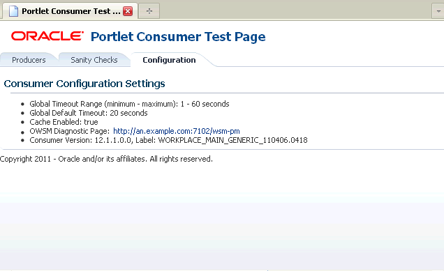

The Configuration tab of the Portlet Consumer Test Page (shown in Figure 13-7) enables you to identify the consumer configuration entries for portlet consumption. This tab displays settings defined in the adf-config.xml
file, for example, the minimum and maximum timeout values and the consumer version number. You cannot change these values as they are stored within the application; they are displayed for reference information only.

The Producer Test Page contains five sections:
Portlets
A list of all the portlets within the producer. For Oracle JSF Portlet Bridge portlets, each portlet also provides a separate link to run the portlet as a servlet (this is a prerequisite to running them as portlets: if a portlet does not run as a servlet, it cannot run as a portlet).
Container Configuration
Information on where the consumer preference information is stored.
Container Version
The version number of the Portlet Producer Container.
WSDL URLs
Links to the Web Service Definition Language (WSDL) documents to use for registration.
SOAP Monitor
A link to the WSRP SOAP monitor where users with the Monitors
or Administrators
role can track the SOAP messages between the consumer and producer.
After accessing the Producer Test Page, you can perform further diagnostic steps.
The Producer Test Page provides diagnostic information about the portlet producer.
To access the Producer Test Page:
In your browser, enter the URL for the Producer Test Page:
In the Producer Test Page, you can perform further diagnostic steps as described in the following sections.
To verify that an Oracle JSF Portlet Bridge portlet producer is running correctly, you must first verify that the producer application runs correctly through standard HTTP requests. If the artifacts the producer exposes as portlets do not run as servlets, they will not run as portlets.
To run a JSF portlet as a servlet:
In the Producer Test Page, click the run as servlet link next to the portlet.
The portlet is called using standard HTTP to request the underlying page or task flow. The results of the request are displayed in a new browser window.
If the resulting page or task flow does not render correctly, then there is a problem with the producer application that must be resolved before you can run the page or task flow as a portlet.
If the portlet accepts parameters, click show parameters to list them and provide values. When you click run as servlet, the portlet call includes the parameter values.
Oracle Fusion Applications has adopted a standard to use a consumer persistence store as the persistent store. Therefore, for Oracle Fusion applications producers, the Persistent Store Type displayed on the Producer Test Page should always be set to Consumer.
Although other configurations are acceptable for applications that are built to assume such a configuration, having a non-consumer setting in Oracle Fusion applications indicates an issue in the producer. For Oracle Fusion applications to work correctly, they require a consumer persistence store.

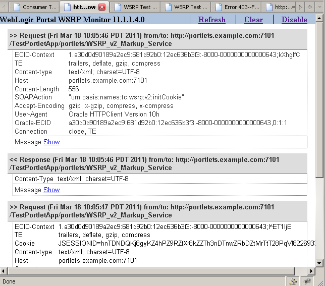

The SOAP monitor provides access to the SOAP requests between the consumer and producer when rendering a portlet. This is very useful in diagnosing problems at the communication level.
To examine the SOAP monitor:
In the Producer Test Page, click the SOAP Monitor link at the bottom of the page.
When prompted, enter your user name and password.
To access the SOAP monitor you must be a member of the Monitors
or Administrators
role in the Identity Management System. For more information, see the "Users, Groups, And Security Roles" chapter in Oracle Fusion Middleware Securing Resources Using Roles and Policies for Oracle WebLogic Server.
By default, the SOAP monitor is disabled, so the page is empty. You must first enable the monitor by clicking the Enable link at the top of the page.
The page does not automatically refresh, so to display SOAP messages, you must click the Refresh link.
To force a request to the failing portlet, go to the Portlet Consumer Test Page: Portlet page for the portlet and select Refresh Portlet.
When the portlet has rendered, or failed, click the Refresh link in the SOAP monitor to display the captured request.
Now, you can investigate the SOAP messages that were sent and the responses to try to narrow down the cause of the problem.
If, after rerunning the portlet and refreshing the SOAP monitor, you see no messages displayed, this indicates that there may be a security issue between the producer and the consumer. You must verify that the correct WS-Security settings are set up for the producer and consumer to communicate.
