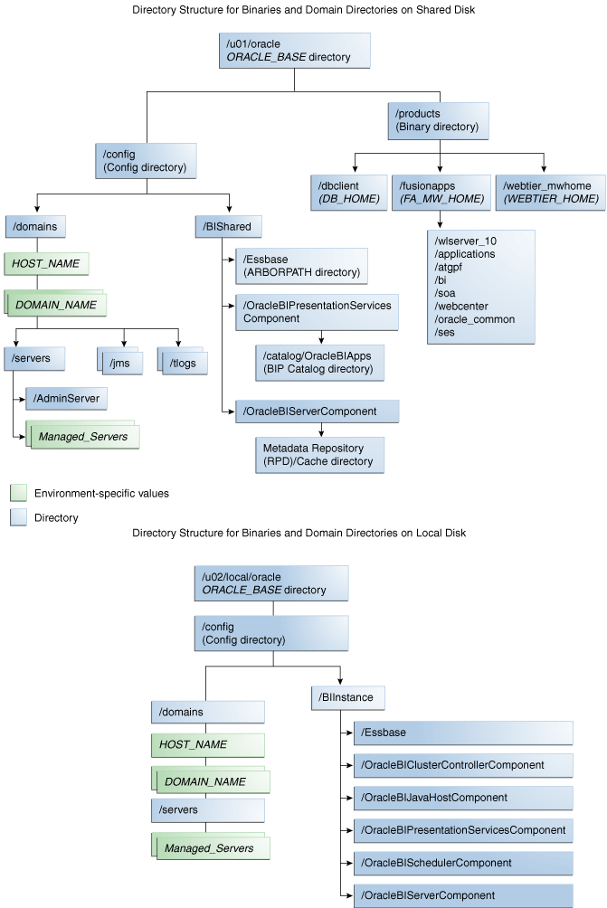

3.4.1 Directory Structure
Figure 3-1 shows the enterprise deployment directory structure and its dependencies.
Figure 3-1 Enterprise Deployment Directory Structure for Oracle Fusion Applications
Described in the surrounding text
3.4.2 Binary Directory Structure
The binaries in the Oracle Fusion Applications reference enterprise deployment topology (the Oracle Fusion Middleware home and Oracle home) are on a shared disk. To avoid disk corruption, you may choose to maintain snapshots.
The file system for the binaries should be mounted on all the nodes with the exact mount point and path. For example, /u01/oracle.
3.4.3 Domain Configuration Directory Structure
The domain configuration directory structure is created on a shared disk, and its mount point should be visible from all nodes This path will be used by the components that require shared resources and also administration servers to start active-passive processes. For example, /u01/oracle.
