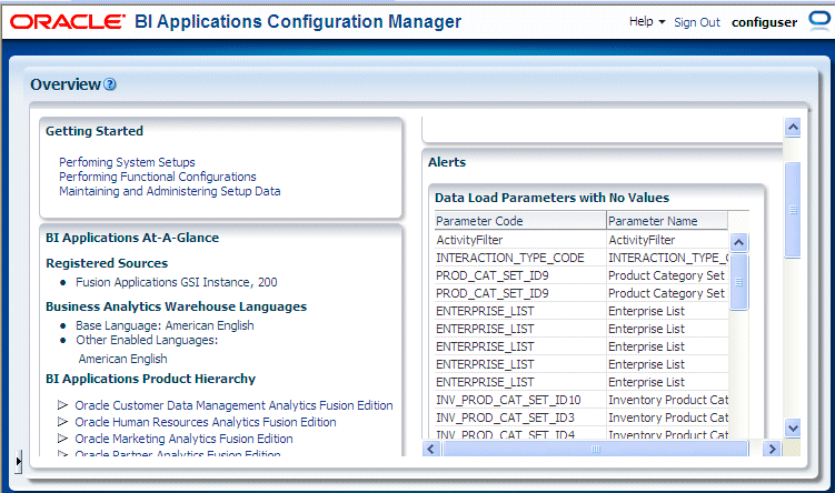

  1. During the Functional Configuration stage, you typically use Oracle BI Applications Configuration Manager to monitor the setup data values.

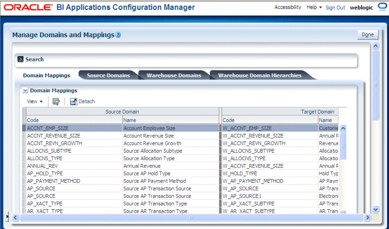

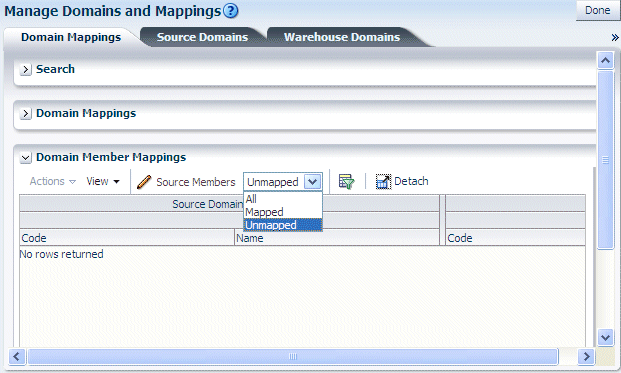

    • To monitor Domain Mappings, in Oracle BI Applications Configuration Manager, select the Manage Domains and Domain Mappings link from the Tasks bar to display the select Manage Domains and Domain Mappings dialog.
      This screenshot is described in surrounding text.
      Note: Alternatively, in Functional Setup Manager, select the Go to Task link for a Task that updates a Domain or Domain Member mappings. For example, the Task name 'Manage Domains and Member Mappings for Employee Dimension' updates Domain and Domain Member Mappings.

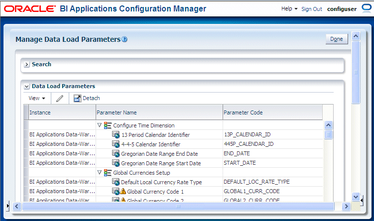

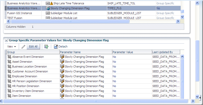

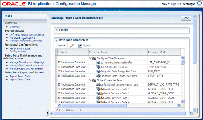

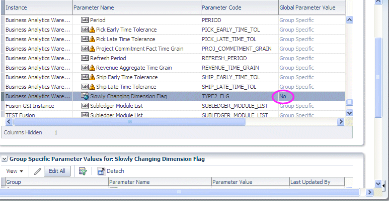

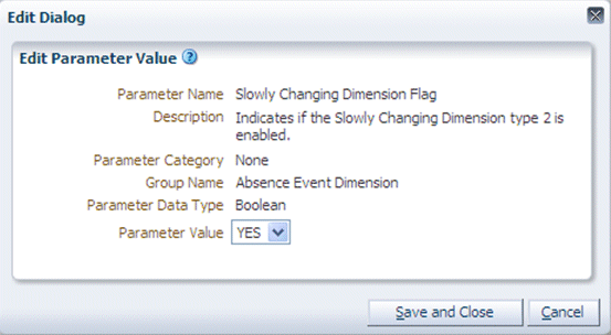

    • To monitor Data Load Parameters, select the Data Load Parameters link from the Tasks bar to display the select Manage Data Load Parameters dialog.
      Note: Alternatively, in Functional Setup Manager, select the Go to Task link for a Task that updates a Data Load Parameter value. For example, the Task named 'Configure Data Load Parameter Workforce Adjusted Service Date' updates a Data Load Parameter value.

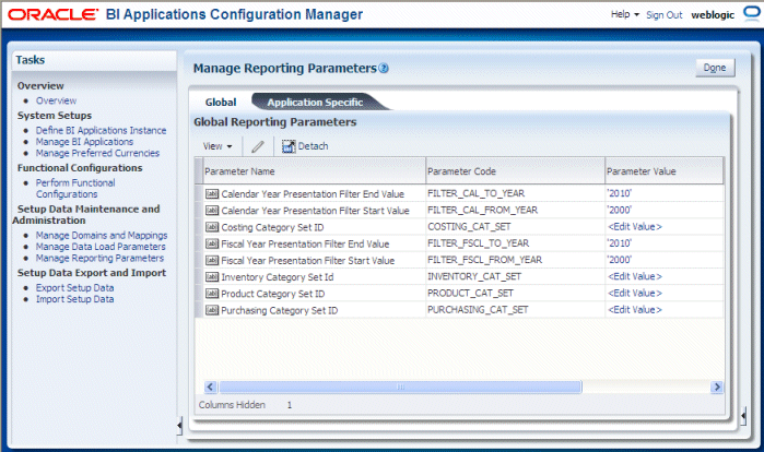

    • To monitor Reporting Parameters, select the Manage Reporting Parameters link from the Tasks bar to display the select Manage Reporting Parameters dialog.
      Note: Alternatively, in Functional Setup Manager, select the Go to Task link for a Task that updates a Reporting Parameter. For example, the Task named 'Configure Reporting Parameters for Year Prompting' updates a Reporting Parameter.

To manage Domains, you use the Manage Domains and Mappings dialog (see the following screenshot).
To display the Manage Domains and Mappings dialog, do one of the following:

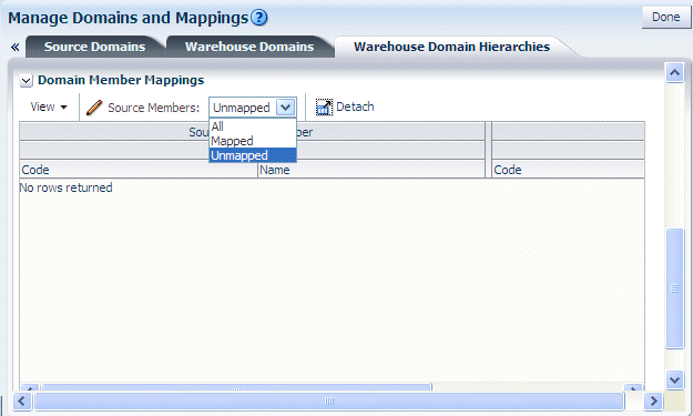

Domain Member Mappings specify how domain member data in a source system is extracted and loaded into domain member data in Oracle Business Analytics Warehouse. For example, in Oracle HR Analytics, domain Gender (W_SEX_MF_CODE) has a source value 'Male' that is mapped to a domain member value 'M' in Oracle Business Analytics Warehouse.

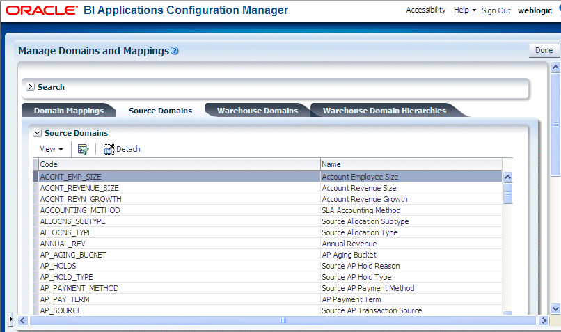

6.4.2 About Source Domains
Data fields in a Source System application are referred to as Source Domains. Data fields in Oracle Business Analytics Warehouse are referred to as Warehouse Domains.
The following screenshot shows example source domains for Oracle Financial Analytics.
Note: Source Domains displayed on the Source Domains tab are read-only.
Domain Members are the permitted values for a Source or Warehouse Domain. For example, the Domain Members for MARITAL_STATUS include D for Divorced, M for Married, S for Single, and so on.

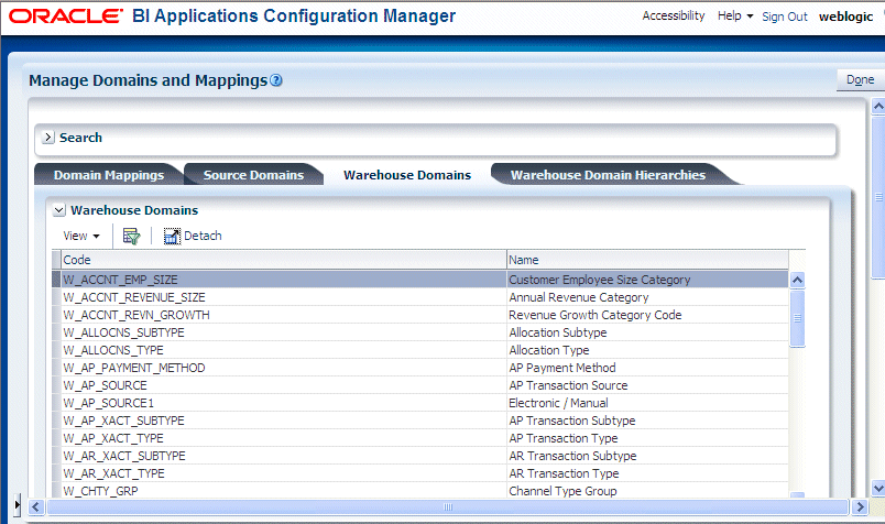

6.4.3 About Warehouse Domains
The following screenshot shows example warehouse domains for Oracle Financial Analytics.

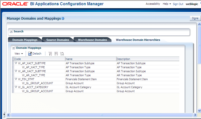

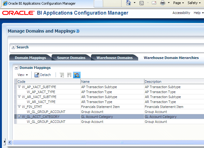

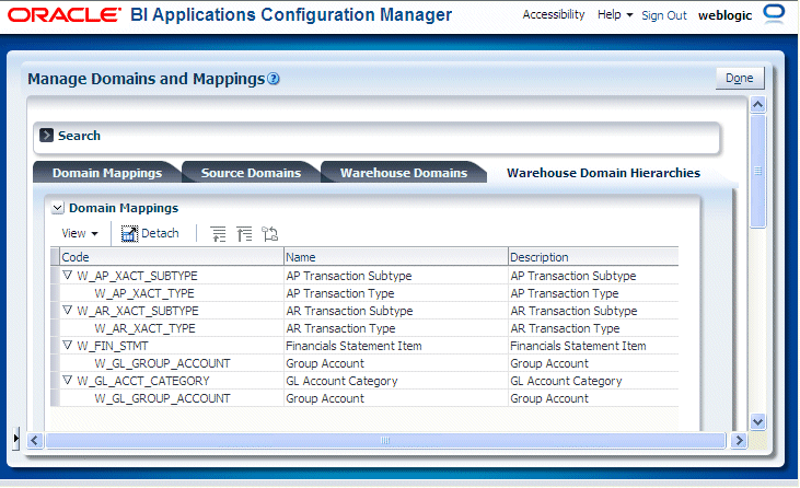

6.4.4 About Warehouse Domain Hierarchies
Warehouse Domain Hierarchies are Domains that have been organized into hierarchies to enable the data to be more effectively analyzed. For example, in Oracle HR Analytics, you might need to have a workforce event hierarchy: Event Group -> Event Sub-group -> Event Detail.
Domain Hierarchies are displayed in inverted format, that is in the following format:
<Child 1>\
<Child n>\
<Parent>.
For more information, see Section 6.12, "Viewing Domain Hierarchies".
The following screenshot shows example warehouse domain hierarchies for Oracle Financial Analytics.

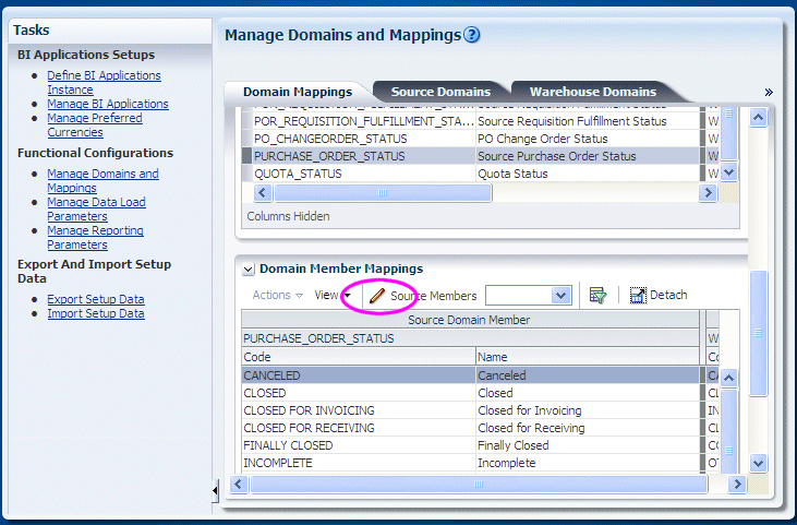

  2. Scroll down to the Domain Member Mappings pane.

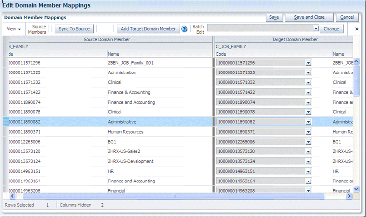

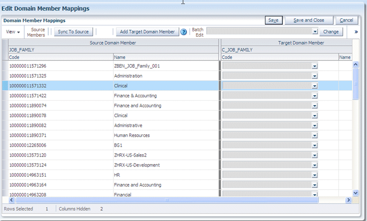

  3. Click the Edit Domain Member Mappings icon to display the "Edit Domain Member Mappings dialog",
  4. Use the "Edit Domain Member Mappings dialog" to edit the domain mapping values.

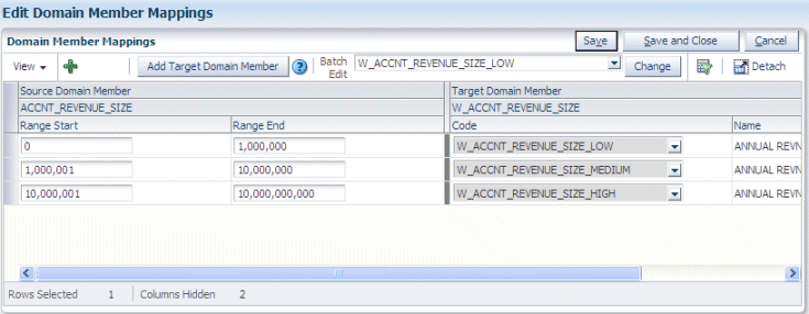

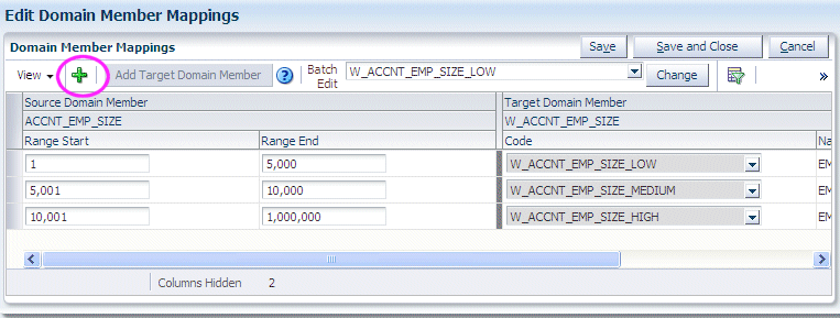

6.4.5.2 How to add a Range Member Mapping
To add a Range Member Mapping:
  1. Navigate to the Domain that you want to edit, using the "Manage Domains and Mappings: Domain Mappings tab".
    To display the Domain Mapping tab, do one of the following:
    • In Oracle BI Applications Configuration Manager, select the Manage Domains and Mappings link in the Tasks pane, display the Domain Mappings tab, then select a banded (or ranged) Domain.
    • In Functional Setup Manager, select the Go to Task link for a Task that updates a banded or ranged Domain or Domain Member Mappings.
  4. Click the Add Range Member Mapping (+) icon and specify values in the Range Start, Range End, and Target Domain Member - Code fields.
    Tip: Before you create a new range, you might first want to use the Add Warehouse Member button to first create a target Warehouse Member, which is then available as an option in the Target Domain Member - Code list. For example, you might add a Warehouse Member called 'Greater than 250,000' to map to the range 250,000 to 1,000,000.

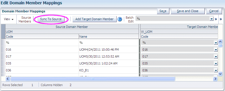

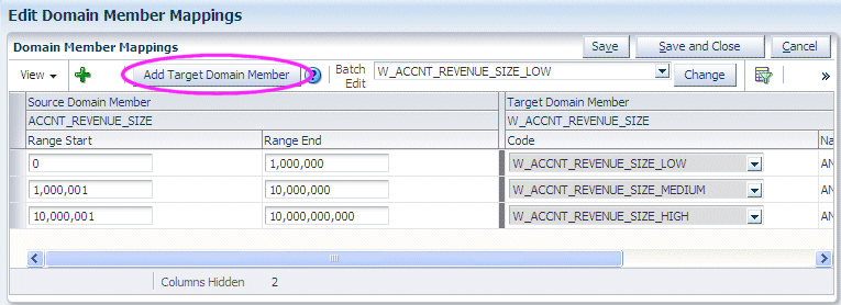

  4. Click Add Target Domain Member to display the Add Target Domain Member dialog, which enables you to specify a Name, Code, and optional Description.
    Note: If the Add Target Domain Member option is grayed out or not displayed, then the domain is non-extensible (for more information, see Section 6.4.7, "Why are some domains non-extensible?").
    When you click OK to return to the "Edit Domain Member Mappings dialog", you can map a Source Domain to the Target Domain that you just created.

6.4.5.6 How to use Sync to Source to synchronize a Target Domain with a Source Domain
In some scenarios, you might only know what target Domain member values should be when you deploy Oracle BI Applications. For example, in Order Management or Supply Chain Analytics, UOM (Unit of Measurement) is typically not known until deployment time. You can set up a non-ranged target domain using the Sync to Source option to automatically synchronize a target domain with values from the source domain. This process inserts new target members from the source domain, and automatically generates 1:1 mappings. This is useful for large domains with many member mappings that might otherwise take a long time to set up.
Note: Sync to Source is only available for extensible non-ranged Domains.
How to synchronize a Target Domain with a Source Domain:
  1. Navigate to the Domain that you want to synchronize.
    If you are in Oracle BI Applications Configuration Manager, from the Tasks bar click Manage Domains and Mappings, display the Domain mappings tab, select the Domain that you want to edit, then click the Edit Domain Member Mappings icon in the Domain Member Mappings pane to display the "Edit Domain Member Mappings dialog".
    If you are in Functional Setup Manager, when you click Go to Task for the Task that is updating a Domain, you display the "Edit Domain Member Mappings dialog" dialog.

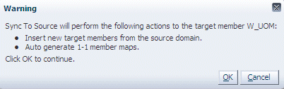

  2. Click Sync to Source.
  3. At the Warning dialog, click OK.
    Note: If you click OK to continue, then you commit changes to the target Domain members, even if you do not click 'Save' or click 'Save and Close' on the Edit Domain Member Mappings dialog.
    Target Domain member values are generated. In the example below, the target codes for C_JOB_FAMILY are automatically synchronized with the Source member codes.
6.4.5.7 How to use Batch Edit to update multiple Target Domain Member Values
You can set up a target domain using the Batch Edit option to update multiple target domain members with the same value. This is useful for large domains with many member mappings that require the same value.
To use Batch Edit to update multiple Target Domain Member Values:
  1. Navigate to the Domain that you want to edit.
  2. Multi-select one or more rows in the table.
    Tip: To multi-select, use Ctrl + click to select multiple rows.
  3. Select a value from the Batch Edit drop down list.
  4. Click Change to apply the value selected in the Batch Edit drop down list to all specified members.
6.4.6 How to modify a Warehouse Domain Hierarchy
Oracle BI Applications Warehouse Domains are organized into hierarchies. You might want to modify a hierarchy to enable data to be more effectively analyzed. For example, you might change the order of items in a hierarchy.
To create or edit a Warehouse Domain Hierarchy:
  1. In the Domain mappings list, select the Domain Mapping that you want to edit.
  2. Use the options at the top of the Domain Mapping list to change the hierarchy.

6.5 About Working With Data Load Parameters
Data Load Parameters are configuration values that specify how Source System data is loaded into Oracle Business Analytics Warehouse. For example, the cost time grain parameter COST_TIME_GRAIN specifies whether costs are aggregated weekly, monthly, or quarterly, during the data loading process.
6.5.1 Key points about working with Data Load Parameters
When you work with Data Load Parameters in Oracle BI Applications Configuration Manager, note the following key points:

    The example below shows the Global parameter 'Slowly Changing Dimension Flag' with associated Group-specific values displayed in the lower pane.
    This graphic is described in surrounding text.

6.5.2 About editing Data Load Parameters
You edit Data Load Parameters (whether they are Global or Application Specific) using the Data Load Parameters dialog, which is displayed in Functional Setup Manager when you edit a Data Load Parameter (see the following screenshot). The Data Load Parameters list above (or master table) displays the parameters and values, and the Group Specific Parameter Values list below displays associated Fact Groups or Dimension Groups (if there are any).
To display Data Load Parameters in Oracle BI Applications Configuration Manager, select the Manage Data Load Parameters link on the Tasks bar to display the "Manage Data Load Parameters dialog".
6.5.3 About Editing Global Data Load Parameters

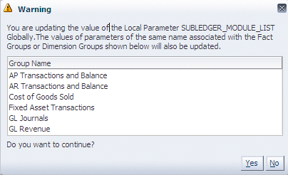

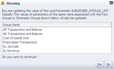

To edit the value of a Global Parameter, select the record in the Data Load Parameters master table, and then either click the Edit icon in the table toolbar or click on the link in the Global Parameter Values column.
If the Global Parameter that you edit is associated with Fact Groups or Dimension Groups, then a warning message is displayed to verify that you want to update the value for all associated Fact Groups and Dimension Groups. If you click Yes at the warning message, then the values of all occurrences of the parameter at the Group level will be updated to the new value.
For example, if you click the Edit icon or the link in the Parameter Value column for the parameter SUBLEDGER_MODULE_LIST in the Data Load Parameters master table, then the following Warning dialog is received:
Clicking Yes allows you to continue with the edit of the parameter value. A change to the parameter value is applied to all parameter occurrences at the Group level.
To change the value of parameter for a specific Fact Group or Dimension Group, select the Global Parameter in the Data Load Parameters master table, and then select the parameter in the Group Specific Parameter Values for: <Parameter Name> detail table. Click on the Edit icon in the table tool bar or the link in the Parameter Value column to open the Parameter Value Edit dialog.
Changing the parameter value in the above Edit Dialog updates the parameter value for the Slowly Changing Dimension Flag parameter associated with the Absence Event Dimension Group.

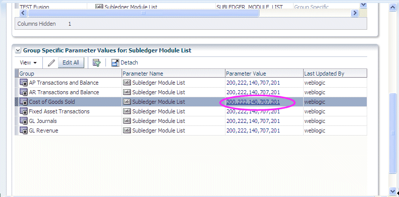

6.5.4 About Editing Application Specific Parameter Values
You use the Edit option to edit the value of a Fact Group or Dimension Group that is associated with an Application Specific parameter (if the parameter is overridable).
You use the Edit All option to edit the value of all Fact Groups and Dimension Groups that are associated with an Application Specific parameter.
If you attempt to edit the value of a specific Fact Group or Dimension Group, then:
  • if the parameter is overridable at the Group level, then you update only that specific Fact Group or Dimension Group.
  • if the parameter is Non-Overridable at the Group level, then a Warning dialog displays a list of Fact Groups and Dimension Groups that will be affected if you click Yes to edit the value.
6.5.5 How to Edit a Data Load Parameter value
You edit Data Load Parameters using the Manage Data Load Parameters dialog.
To display the Manage Data Load Parameters dialog, do one of the following:
  • In Oracle BI Applications Configuration Manager, select the Manage Data Load Parameters link in the Tasks pane.
  • In Functional Setup Manager, select the Go to Task link for a Task that updates a Data Load Parameter (for example, Configure Initial Extract Date).
To edit a Data Load Parameter:
  1. Select the parameter in the Data Load Parameters list.
    If the parameter is a Global parameter, then the Global Parameter Value field displays the actual value (for example, 'MONTHLY').
    If the parameter is a non-Global parameter, then the Global Parameter Value field displays the text 'Group Specific').

      If a Global parameter is associated with Fact Groups or Dimension Groups, you can override the Global value for specific Fact Groups or Dimension Groups by editing the parameter value in the Group specific Parameter Values for pane.
    • To update an Application Specific parameter, select the parameter in the Data Load Parameters list, scroll down to the Group Specific Parameter Values for list, and click either the Edit icon, or the value in the Parameter Value column (or select the parameter row and click the Edit icon).
      If the parameter is overridable at the Group level, then you update only that specific Fact Group or Dimension Group using the Edit Parameter Value dialog.
      If the parameter is Non-Overridable at the Group level, then a Warning dialog displays a list of Fact Groups and Dimension Groups that will be affected if you click Yes to edit the value.

6.6 About Working With Reporting Parameters
Reporting Parameters are configuration values that specify how data is presented in Business Intelligence dashboards.
There are two categories of Reporting Parameter:
You manage and edit Reporting Parameters using the "Manage Reporting Parameters: Global/Application Specific tab" (see the following screenshot).
You display the "Manage Reporting Parameters: Global/Application Specific tab" by doing one of the following:
To edit a Reporting Parameter, select the parameter in the parameter list, then either click the Edit icon, or click the value in the Parameter Value column.

6.9 How to Locate Unmapped Domain Values in Oracle BI Applications Configuration Manager
You locate unmapped Domain Values to enable you to make sure that you have mapped all of your source system domain values.
Tip: You can also use the Alerts pane on the Overview page in Oracle BI Applications Configuration Manager to identify target domains with one or more unmapped source members. Display the Overview page, and navigate to the Domain Maps with Unmapped Source Members pane.
How to locate unmapped domain values:
  1. Start Oracle BI Applications Configuration Manager.
  2. Do one of the following:
6.10 How to Locate Data Load Parameters with no Values in Oracle BI Applications Configuration Manager
You locate Data Load Parameters with no values to check all Tasks in Functional Setup Manager relating to Data Load Parameters have been completed correctly.
How to locate Data Load Parameters with no values:
    • From the Overview page, use the Data Load Parameters with no Values list in the Alerts pane.
    • From the Tasks bar, select Manage Data Load Parameters to display the "Manage Data Load Parameters dialog", which enables you to view and edit parameters.
6.11 About Adding Target Domain Members
You add Target Domain Members to extend Oracle Business Analytics Warehouse. For example, you might want to create a new salary category called 'Range 5' so that you can map salary values to this new category.
6.11.1 How to add a Target Domain Member
You add a target domain member to extend Oracle Business Analytics Warehouse.
To add a Target Domain Member:
  1. Display the Warehouse Domains tab.
    In Functional Setup Manager, the Warehouse Domain tab is displayed when you perform a Task that edits a Warehouse Domain value.
    In Oracle BI Applications Configuration Manager, from the Tasks bar, select Manage Domains and Mappings to display the Manage Domains and Mappings dialog.
  2. In the Warehouse Members pane, click Add Warehouse Domain Member, to display the "Add Warehouse Domain Member/Add Target Domain Member dialog".
  3. Use the "Add Warehouse Domain Member/Add Target Domain Member dialog" to specify the details.
  4. Click OK to save the details and close the dialog.
6.12 Viewing Domain Hierarchies
To view Domain Hierarchies, select the Manage Domains and Mappings link on the Tasks bar, then display the Warehouse Domain Hierarchies tab.

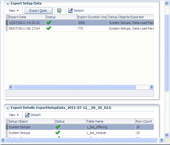

  1. In the source environment, start Oracle BI Applications Configuration Manager.
  2. From the Tasks bar, select Export Setup Data to display the "Export Setup Data dialog".
    This screenshot is described in surrrounding text.

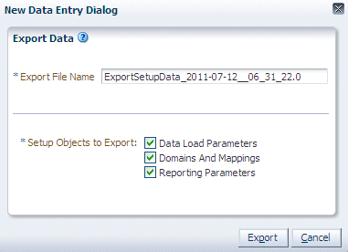

  3. Click Export Data to display the "Export Data dialog".
  4. Use the "Export Data dialog" to specify the setup objects that you want to export.
  5. Click Export.
  6. When the File Download dialog is displayed, click Save to save the ZIP file to a location that you specify.
    If you first click Open at the File Download dialog to open the ZIP file, then make sure that you save the ZIP file in the ZIP program that you are using.
The Export Setup Data table is updated with the export details.

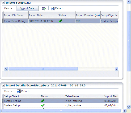

6.13.6 How to Import Setup Data
You import Setup Data to restore or migrate Setup Data. Before you import Setup Data, you must copy the previously exported ZIP file to a file location that is accessible from the machine that is running the Oracle BI Applications Configuration Manager client.
Note: When you import Setup Data, the data source number in the target system must be the same as the data source number in the source system.
To import Setup Data:
  2. From the Tasks bar, select Import Setup Data to display the "Import Setup Data dialog".

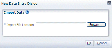

  3. Click Import Data to display the "Import Data dialog".
  4. Use the "Import Data dialog" to specify the location and name of the ZIP file that contains the configuration changes that you want to import.
  5. Click OK.
    The Setup Data is imported from the ZIP file, and the Import table is updated with the details.
