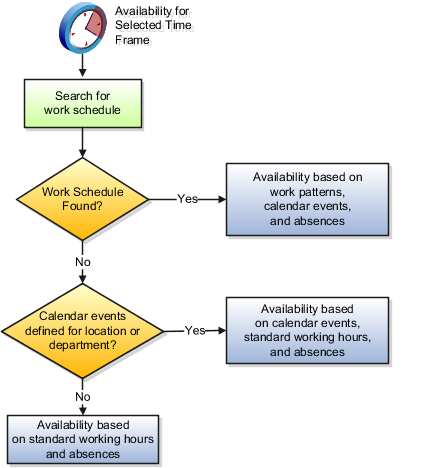

How Worker Availability Is Determined
The following figure shows how worker availability is determined.
Figure illustrating how worker availability
is determined
The application searches for primary work schedules that were assigned to these workforce structure levels in the following order:

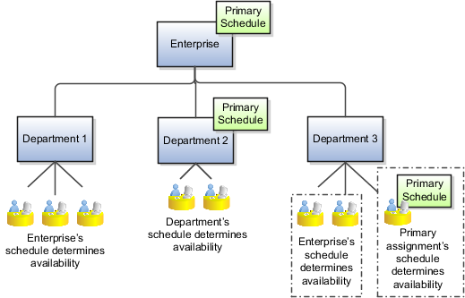

To determine availability, work schedules that were assigned to lower workforce structure levels take precedence over those defined at higher levels.
For example, you assigned a primary schedule at the enterprise level. However, since workers belonging to a particular department in that enterprise follow different work timings, you assigned a different primary schedule to that department. The department's primary schedule determines worker availability because that schedule takes precedence over the one that was defined at the enterprise level. In the same example, if you assigned a primary schedule to a worker (primary assignment) belonging to the same department, then that schedule determines the worker's availability because a schedule assigned to the primary assignment takes precedence over the ones defined at the department level and the enterprise level. The following diagram illustrates this example:
Impact of schedules defined
at various workforce structure levels on worker availability

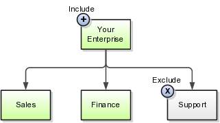

Adding and Removing Coverage in a Hierarchy
You want to apply the New Phone System Training calendar event to all workers in your enterprise except those working in the Support department. When an event applies to most of a hierarchy, it's efficient to use the Include tool to include the whole hierarchy in the coverage and then use the Exclude tool to leave out the exceptions.
The following diagram shows how to include and exclude calendar event coverage in a sample organization hierarchy.
Calendar event coverage in an organization
hierarchy.

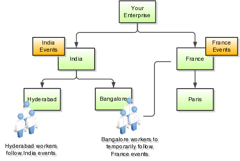

Overriding Coverage for Specific Locations
You have set up public holidays and other calendar events for workers at your India location and France location using a geographic hierarchy. For six months, workers at your Bangalore location will work closely with their counterparts in Paris on a critical project. During this time, you want the Bangalore workers to follow the events you set for France. On the Manage Locations page, edit the location information for Bangalore and set the geographic hierarchy to France.
The following diagram shows a sample geographical hierarchy where employees of a particular location share calendar events of another country.
in a geographical hierarchy

How can I associate calendar events with countries?
On the Manage Trees page, you must create a geographic tree version using the predefined HCM Geographic Hierarchy tree structure and add country nodes. When you create a calendar event, you select that geographic tree version and select countries that you want the calendar event to apply to.
