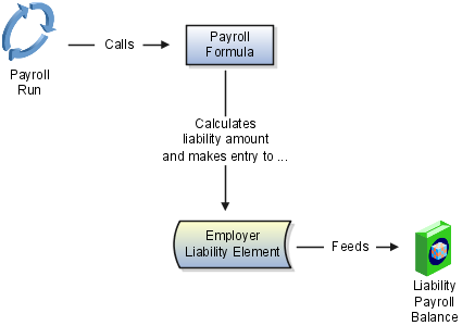

The following figure depicts the relation between the Absence element, Earnings element, skip rules, and the payroll formula associated with the Earnings element:
Relation between the absence element,
earnings element, skip rules, and the payroll formula associated with
the earnings element

Maintaining a Consolidated Leave Liability Balance for All Employees
To consolidate the liability amounts for all employees for accounting purposes, you create a payroll balance that stores the aggregate amount and include the liability amount calculation in the payroll formula that the accrual plan generates. When you run the payroll, the payroll formula calculates the liability amount and adds it to the payroll balance.
The following figure shows how the payroll run maintains the leave liability amount in a payroll balance.
Maintenance of employee leave liability
amounts in a payroll balance
Ensure that you create the Employer Liability element and the Liability payroll balance. The pay value of the employer liability element must feed the payroll balance. For the accrual plan element, you must create a result rule that passes the Current Liability Increment formula result value to the pay value of the Employer Liability element. The payroll formula must return the Current Liability Increment value as a result of the liability calculation, as shown in the following example.

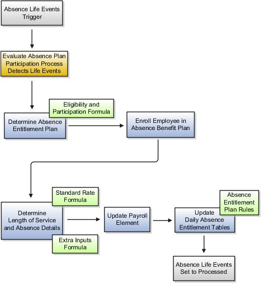

The following diagram illustrates how the process determines the absence entitlement days.
Diagram illustrating the working of the
Evaluate Absence Plan participation process
Recording an absence triggers absence life events.
When you run the Evaluate Absence Plan Participation process, it detects these life events and searches for all absence benefit plans. For each absence benefit plan that it finds, the process runs the Eligibility and Participation formula associated with that plan to determine whether an absence entitlement plan exists for the combination of the absence benefit plan and the absence type that was used to record the absence. If an absence entitlement plan exists, the process enrolls the employee in the absence benefit plan.
The process then runs the following formulas associated with the absence benefit plan's standard rate and updates the payroll element:
On the basis of the rules you set up in the absence entitlement plan, the process updates the following tables:
The information in the BEN_GAP_DAILY_ABSENCES table indicates the entitlement for the employee for each absent day. Each row in this table contains the following columns:

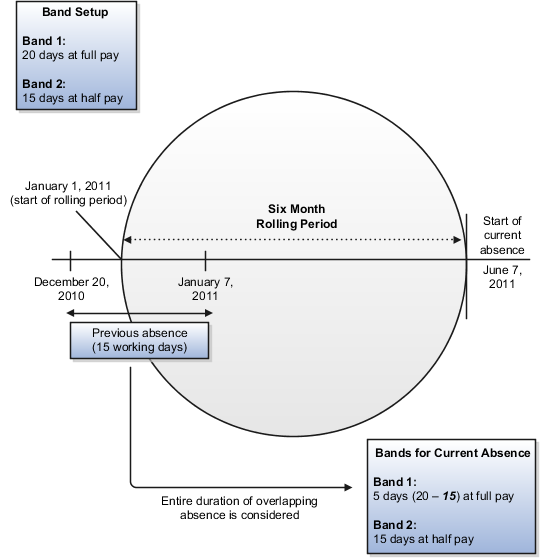

Using the Include Rule
This rule applies to rolling-backward assessment periods only. If an absence overlaps the beginning of the rolling period, then the entire absence is considered in the current assessment period.
For example, assume that you have defined a six-month rolling-backward assessment period in your entitlement plan and set up bands that entitle employees to 20 days of absence at full pay and a further 15 days at half pay. An employee starts sick leave on June 7, 2011 and the assessment period starts on January 1, 2011. The employee was paid previously under the same entitlement plan while on sick leave for a period of 15 working days from December 20, 2010 to January 7, 2011. Because the previous absence overlaps the current assessment period and you configured the entitlement plan to use the Include rule, the employee receives full pay for the first 5 (20 - 15) days of the absence and half-pay for the next 15 days.
The following figure shows the usage of the Include rule in this scenario.
Include rule
Using the Exclude Rule

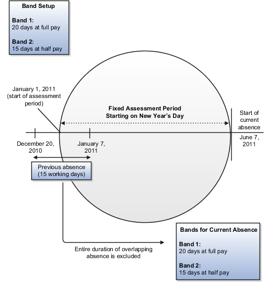

If an employee is absent at the beginning of an assessment period, then this rule ignores the entire absence that overlaps the period.
In the example used in the previous scenario, for an entitlement plan that uses the Exclude rule, the employee receives full pay for the first 20 days of the absence and half pay for the next 15 days. Because you used the Exclude rule, even though the previous absence overlaps the current assessment period, the employee receives the entitlement band benefits for the current absence without any deductions.
The following figure shows the usage of the Exclude rule in this scenario.
Exclude rule

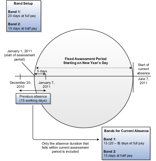

Using the Split Rule
This rule assesses overlapping absences that fall within the current period only. In the example used in the previous scenario, for an entitlement plan that uses the Split rule, the employee receives full pay for the first 15 (20 - 5) days of the absence and half pay for the next 15 days.
The following figure shows the usage of the Split rule in this scenario.
Split rule

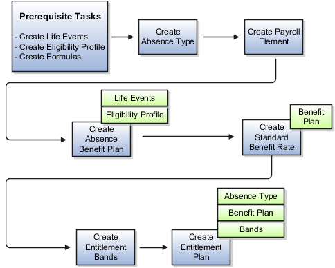

Task Summary
Before you start, ensure that you create life events, an eligibility profile, and associated formulas. You can reuse these for any sickness or maternity absence entitlement plans that you create subsequently.
Create an absence type for employees to record absences. Create a recurring payroll element to record the absence entitlement details. Create a benefit plan and associate with it the eligibility profile and life events that you created. Create a standard benefit rate for the absence benefit plan and associate with it formulas that determine the employee's length of service and other absence information to update the payroll element. Create absence entitlement bands that determine the amount of leave time that the employee is entitled to. Finally, create an absence entitlement plan and associate with it the entitlement bands, the absence type, the absence benefit plan, and other plan rules.
The following diagram shows the tasks to complete in this example.
Diagram that shows the tasks to complete
in this example.
Prerequisites
  1. Create absence life events that trigger when an employee records an absence start date or end date, or deletes an absence.
  2. Create and compile the following formulas:
  3. Create an eligibility profile for employees who work full-time and associate with it the Participation and Rate Eligibility formula you created.

Task Summary
The following figure shows the tasks to complete in this example.
Figure that shows the tasks to complete
in this example.
