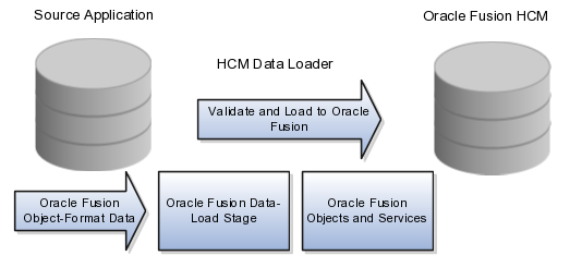

The following figure shows an overview of the data-load process.
To use the HCM Data Loader, you:
Map data between your source application and Oracle Fusion HCM.
Extract data from your source application and place it in the HCM Data Loader staging tables in the supported Oracle Fusion HCM object-data format.
Run the Load Batch Data process to load the data into Oracle Fusion HCM.

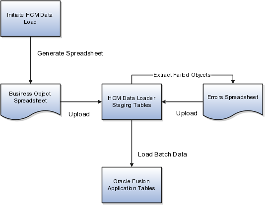

The following figure, which also shows one approach to error correction, summarizes both stages of this process.
When you upload data from a spreadsheet to a batch in the HCM Data Loader staging tables, the status of each spreadsheet row is updated to show whether the row was inserted successfully in the batch. If the row insertion fails, you can double-click the status value to display information about the error. After correcting the error, you upload the corrected data to the existing batch.
When you run Load Batch Data to transfer data from the HCM Data Loader staging tables to the Oracle Fusion application tables, the data is validated.
If errors occur, you can:
Download objects in error to an errors spreadsheet, correct the errors, and upload the corrected data to the existing batch.
Each time you download objects in error for a batch, a new spreadsheet is generated with the existing batch name. If you overwrite the existing batch name in the errors spreadsheet with a new batch name, then the existing batch in the HCM Data Loader staging tables is renamed using the new batch name.
Once the data is uploaded successfully, you run Load Batch Data again for the batch.
Correct the errors in the HCM Data Loader staging tables and rerun the batch. Only corrected data is transferred to the Oracle Fusion application tables.
