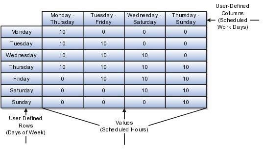

This example illustrates how to create a user-defined table to store values for workers schedules.
Your organization works on a 10 hour a day, four day a week rotating schedule. The employees work for four consecutive days, 10 hours a day.
The main components of the user-defined table are the definition, columns, rows, and values.
In this example, you will construct a user-defined table containing the schedules available in your organization.
This figure illustrates the user-defined table containing the various schedules that your organization offers.
This user-defined table definition consists of the following:
The name of the table is Scheduled_Hours.
The table is used to match to a specific day of the week.
The row title is Days of the Week.
The unit of measure is text since the row values are days of the week.
The user-defined columns are named the days of the week that the employee works. The data type for each column is number. The date type reflects the data type of the values that will be entered in each column.
There are seven user-defined rows containing the exact value of a day of the week.
The values are the scheduled hours for each day of the week. Since the employees only work four consecutive days of ten hours each, there can only be four different schedules. Each column contains the scheduled hours for each day of the week represented in the row.

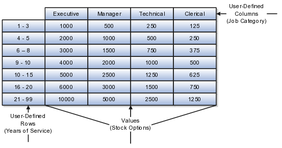

This example illustrates how to create a user-defined table to store values for stock option allocations.
Each year, your organization offers stock options to its employees. The amount of options depends on years of service and job category of the employee receiving them.
In this example, you will construct a user-defined table containing stock option allocations by job category and years of service.
This figure illustrates the user-defined table containing the stock option allocation that your organization offers.
The name of the table is Stock_Options.
The table rows consist of a range of numbers that represent years of service.
The row title is Years of Service.
The unit of measure must be number when you are looking at a range of values.
The user-defined columns are named for each job category. The data type for each column is number. The date type reflects the data type of the values in each column.
There are seven user-defined rows containing the range of years of service allotting the same amount of stock options.
The values are the number of stock options. There are only four job categories, in this example. Each column contains the stock option allocation for each job category based on the range of service years.

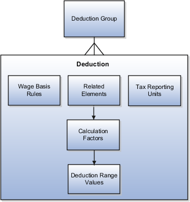

Deduction information defined at the legislative data group level comprises several different components, including wage basis rules, one or more payroll elements, and rules for calculating the deduction amount. The following figure shows the relationship between these components.
Each deduction belongs to a deduction group used to categorize related deductions. Predefined deduction groups include social insurance, taxes, retirement plans, involuntary deductions, benefits, and more. The deduction groups available and their names vary by legislation.
A payroll deduction is a set of rates and rules used in the calculation or reporting of one or more payroll deduction elements. A set of statutory deductions is predefined for each legislative data group and cannot be changed. Involuntary deductions are created automatically when you create an element for an involuntary deduction classification. Use the Manage Payroll Deductions task to view deductions.
Wage basis rules determine the earnings that contribute to a deductible amount or, for exemptions, the elements that reduce the amount subject to deduction. For example, wage basis rules might define which classifications of standard and supplemental earnings are subject to a particular tax. If wage basis rules vary based on a factor such as a person's location of residence, then location of residence is defined as a wage basis rule reference. Use the Manage Deduction Group Rules task to create new wage basis rules.
A deduction is typically associated with one or more elements. The element definition specifies how and when the element should be processed and identifies the input values for the element. A deduction element's processing rule drives the calculation of the element, accessing calculation factors and wage basis rules to derive the deduction amount.
Related elements for statutory deductions are predefined. Related elements for involuntary deductions are created when you create the involuntary deduction element. Element entries for deduction elements are created automatically when the deduction component for the element is added to a personal deduction card.
A calculation factor is a data-driven rule for calculating an element. For example, a calculation factor for an income tax element would identify the deduction range that holds the tax rates to use in the calculation. If tax rates vary based on a factor such as a person's filing status, then filing status is defined as a calculation factor reference. Thus, an element may have multiple calculation factors, one for each unique set of rules and references values. If element calculation involves multiple steps, each step is defined in a separate calculation factor. Calculation factors are predefined for statutory and involuntary deductions, and should not need to be changed. Technical users can create new calculations factors using the Manage Payroll Deductions task, and then modify an element's processing rule to use the new calculation factors.
A deduction range stores calculation rates and rules, which may vary based on the amount subject to deduction. For example, deduction range values for a graduated tax might define a 10 percent tax rate for earnings under 50,000 USD and a 20 percent rate for earnings above 50,000 USD. Predefined deduction ranges are provided for statutory and involuntary deductions. Use the Manage Deduction Ranges task to view and manage deduction ranges.
At the legislative level, a deduction can be associated with one or more tax reporting units for reporting purposes. These associations do not impact the deduction calculation or aggregation during a payroll run. You associate tax reporting units with specific deduction components on a personal deduction card.
Use these examples of an individual income tax deduction and a social insurance deduction to understand how deduction components work together. Each example provides sample values for the following deduction components:
Deduction group
References for wage basis rules
References for calculation factors
Wage basis rules
Related elements
Calculation factors for elements
Associations for tax reporting

A calculation factor defines a data-driven rule for calculating a deduction or exemption element. For example, a calculation factor for a tax deduction element might define a context reference (such as a city or state), the deduction range value (such as a 4 percent tax rate on balances under 50,000), and optionally a calculation method and calculation step. Some elements may have a large number of calculation factors, one for each unique set of rules, ranges, and references values. The element calculation process determines which calculation factor to use based on the reference values and calculation rules of the element being processed. Calculation factors are predefined for statutory and involuntary deductions, and should not need to be changed.
Aspects of a calculation factor are shown in the following figure:
A calculation factor may be associated with up to six references that define its context. For example, calculation of a social insurance deduction might vary based on a person's age and employment status. Each reference has a sequence number that determines the order in which it is evaluated for processing relative to other references.
To view the references associated with a calculation factor, click the deduction in the Deduction Overview pane on the Manage Payroll Deductions page.
Note
The calculation factors and related references for statutory deductions are predefined for each legislative data group. You cannot add or edit references for predefined deductions.
Each calculation factor is associated with a deduction range that defines the calculation type, such as flat amount or flat rate, and a set of calculation rates and rules, which may vary based on the amount subject to deduction. For example, a deduction range for a graduated tax might define a 10 percent tax rate for earnings under 50,000 USD and a 20 percent rate for earnings above 50,000 USD. Predefined deduction ranges are provided for statutory and involuntary deductions. Use the Manage Deduction Ranges task to view and manage deduction ranges.
A calculation step is a label you assign to a calculation factor to identify its role in a complex calculation. For example, when calculating an income tax deduction, the process might first calculate the allowance, then any exemption amount, and then apply the tax rate to the reduced deductible amount. For such deductions, you can define multiple elements to be processed separately or define a single element with multiple calculation steps, each defined in a separate calculation factor. You can assign the same calculation step to more than one calculation factor. Calculation steps are optional.
A calculation method references a single fast formula. It is an optional component of a calculation factor. Calculation methods operate at a higher level than the calculation types defined in the deduction range. They provide a wrapper around the calculation of a deduction by retrieving values from a deduction range, applying a fast formula, and returning the final deduction amount for the current run. For example, if the calculation method is set to Cumulative, which references the Core Cumulative fast formula, then the calculation process returns the total deduction amount as a cumulative year-to-date amount.

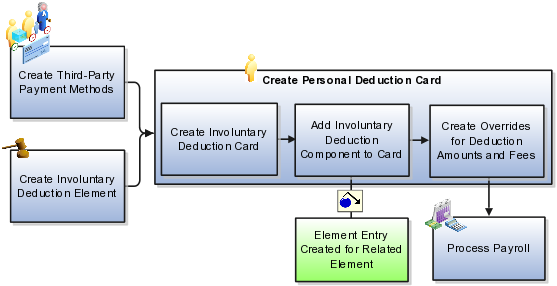

Oracle Fusion Global Payroll supports a set of involuntary deduction types, such as bankruptcy orders, garnishments, child support payments, tax levies, and educational loans. Global Payroll provides element templates for each involuntary deduction type supported by your localization. You can create involuntary deduction elements as needed using these predefined templates. You can then add the corresponding involuntary deduction component to a personal deduction card so the deduction will be processed during a payroll run.
This figure shows the steps involved in creating an involuntary deduction.
Use the Manage Third-Party Payment Methods task in the Payment Distribution work area to create payment methods for all external payees. For example, you might set up direct deposit for the payee of a child support deduction. A payee can be either a person or an organization.
If you create a third-party person payee, you must select the payroll relationship for the employee whose pay is subject to the deduction. This makes the person payment method available for selection as a payee on the employee's involuntary deduction card.
For example, you might set up electronic file transfer (EFT) for Mary Smith, payee of a child support deduction for John Smith. When you create the person payment method, you select the payroll relationship for John Smith. When you add the child support order to John Smith's involuntary deduction card, you can select Mary Smith in the Order Amount Payee field.
If you create a third-party organization payee, you must select External Payee in the Party Usage Code field on the Create Third-Party Organization Payee page. This makes the organization payment method available for selection as a payee on the employee's deduction card.
For example, you might set up an EFT payment method for a County Sheriff that receives a processing fee on garnishment payments. When you create the organization payment method, you designate the County Sheriff as an External Payee. When you add the garnishment order to the employee's involuntary deduction card, you can select the County Sheriff in the Processing Fee Payee field.
You can create a third-party organization payee for a court or other issuing authority, even if the organization is not being paid. This allows you to record address and contact information that you can later associate with the deduction on the involuntary deduction card.
For both types of third-party payment methods, you must select a previously defined organization payment method to use. (Use the Manage Organization Payment Methods task in the Payment Distribution work area to define the payment source for third-party payments, if not already defined.)
An involuntary deduction element must be defined for each involuntary deduction type you need to process. Involuntary deduction elements can be created during initial setup and as the need arises later. You can create multiple elements for the same involuntary deduction type if processing information or other details vary. For example, court orders from different jurisdictions might have different processing rules. The involuntary deduction element creation process is summarized here. You can skip this task if an element has already been defined for the type of involuntary deduction you want to add to a person's deduction card and the element's processing rules meet your needs.
Using the Manage Elements task in the Payroll Calculation work area, create a new element with a primary classification of Involuntary Deduction and a secondary classification that reflects the deduction type, such as tax levy or child support. (Secondary element classification names vary by localization.)
Answer the questions on each page of the Create Element flow. For example, you must indicate whether or not to create arrears if the full deduction amount cannot be taken. A predefined set of rules, plus the answers you provide, determine which earnings contribute to the deductible amount and how the deduction will be processed.

Scenario: A UK employee is issued a court order in the amount of 100 GBP per month. However, protected pay rules defined for the deduction require that the employee take home at least 700 GBP, after all deductions.
Involuntary Deduction Card Setup: Add a deduction component for a court order and then:
Select the Order Amount Payee.
Set the Frequency to monthly.
Create an Order Amount override, and set the amount to 100,
Create a Protected Pay Amount override, and set the amount to 700.
Payroll Run Results:
The amount of the employee's pay subject to the deduction is 750 GBP.
A 100 GBP deduction amount would leave only 650 GBP for the final pay amount. Therefore, only 50 GBP is deducted for the month.
The remaining balance of 50 GBP is not placed in arrears, based on processing rules defined for this deduction.

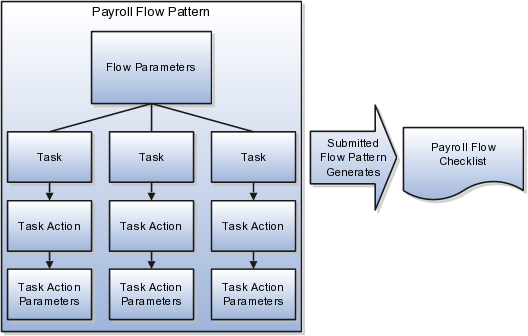

A payroll flow pattern consists of a sequence of tasks, which represent the tasks you complete in each phase of the payroll cycle. You can use the predefined flow patterns or create new ones for tasks you normally perform during a payroll period.
When you create a flow pattern, you can:
Include predefined tasks
Rename tasks and reorder the task sequence
Specify flow parameters that a person enters when submitting a flow
Specify optional information, such as duration dates, notifications, task and flow ownership
The task pane of the payroll work areas include a task to submit a flow pattern. Submitting a flow pattern generates a payroll flow, which you can monitor from the Payroll Dashboard, and with a payroll checklist that lists the tasks on a single page, so that you can easily monitor, perform, and reassign the tasks to someone else.
Predefined tasks are the building blocks of flow patterns. Predefined tasks are associated to an activity, which corresponds to a phase of the payroll cycle, and optionally to a task group within the activity.
All payroll flow patterns begin with a start task and conclude with an end task. Flow patterns can include:
A single task
The predefined tasks that form the building blocks of composite flows consist of single tasks that you can submit as standalone flows. You submit report and process single task flows using the Submit Report or Process Flow task in the navigation tree from the Payroll Checklist work area or the work area that corresponds to the task's activity.
Multiple tasks ordered in a sequence that corresponds to a phase of a typical payroll activity, such as the tasks involved in hiring someone or the tasks involved in paying people after running the payroll.
You submit flow patterns consisting of multiple tasks using the Submit Payroll Flow task in the navigation tree from the Payroll Checklist work area or the work area that corresponds to the activities for tasks included in the flow.
This figure shows a payroll flow pattern for a single task.
This figure shows a payroll flow pattern of several tasks.
Each payroll task has subordinate task actions. Task actions are based on the work the task performs and how it does this work within the application. They describe how the task is executed, such as submit, roll back, mark for retry, retry, and view. Each task action includes task parameters that control how the application processes a task and how the task relates to other tasks in the flow pattern. When you create a flow pattern, you can review the predefined task-action parameters and edit them, for example, to specify a different lookup value set.
This figure shows the relationship of a task to its subordinate task actions and their parameters.
You can rename tasks on the Tasks Sequence page and add descriptions to tasks to more clearly identify their use. For example, if you have a payments flow pattern that includes two payment processes, you might add a manual task after each payment task, rename these tasks and add descriptions to reflect the type of payment and validation to perform.
The sequence in which you initially select the tasks for your flow pattern on the Basic Information page determines the order in which you view the tasks on the Task Sequence page. You can rearrange the order on the Task Sequence page, as well as remove and add tasks. For example, you might remove a report task from the Calculations activity and add it to the Statutory activity.
When you create a flow pattern, you specify flow parameters, the subset of input task parameters that a person submitting the flow enters and that the application uses to derive values needed to successfully complete the tasks included in the flow pattern.
You can specify optional information for a flow pattern, including when a task starts or is due, and which types of notifications to send the task owner, such as overdue reminders, and error and warning messages.
You can restrict who can perform the tasks in it by designating owners for specific tasks. After you create a flow pattern, you can control access to it by creating a security profile and associating it to the appropriate data roles.
The payroll flow pattern parameters capture the information necessary to complete the tasks in the flow pattern. Tasks parameters determine how the application processes a task, and how the task relates to other tasks in the flow pattern. Flow parameters consist of a subset of the input task parameters that the person submitting the flow enters and that the application uses to derive values when processing the tasks in the flow pattern.
You can review and update the task and flow parameters for the flow patterns you create.
The following figure shows how the flow parameters are a subset of task-action parameters required to generate the entire payroll flow and complete the tasks successfully.

The payroll flow pattern determines the sequence of payroll flow tasks executed in a payroll flow. Submitting a payroll flow generates a payroll flow checklist.
You can manage a payroll flow by working in:
The Payroll Checklist work area
Other payroll work areas for the specific activity phase
The payroll flow checklist contains the payroll flow tasks required to complete each activity phase of the payroll: preparation, calculation, payment distribution, accounting, and regulatory reporting.
A payroll flow task by default is associated to an activity, but it can recur in the same activity. For example, a payment distribution flow pattern might include a verification task after each type of payment, such as EFT payment and check payment.
The payroll flow checklist shows you the progression of the individual tasks that comprise the payroll flow. You can use the checklist to monitor the status of the payroll flow tasks and to manage the tasks. The checklist owner or flow task owner manages the flow tasks, for example, by reassigning tasks, revising due dates, marking tasks as complete, and performing actions the task supports, such as roll back and retry.
From the payroll checklist, you can navigate directly to the payroll flow task details. For example, you can navigate from the payroll calculation task directly to the Person Process Results page to view a list of workers processed in the payroll run.
While working with payroll flows, you can remain in the Payroll Checklist work area or navigate to the other payroll work areas to work on payroll flow tasks and access related payroll tasks.
The activities in the payroll flow checklist correspond to the individual payroll work areas. Each payroll work area includes additional tasks to manage the information processed for that phase of the payroll. For example, the Accounting Distribution work area includes tasks to view journal entries and revise cost allocations, and the Payroll Calculation work area includes tasks to manage payroll relationship information.

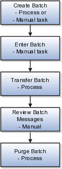

Batch loader spreadsheets are a fast way to upload batches of data. You load data into staging tables using the generic spreadsheet loader then transfer the batch into live HCM tables.
Batch uploads can be created, based on predefined templates, to load the following data:
Balances
Balance groups
Elements
Element entries
Payroll relationships
Fast formula global values
Object groups
This figure illustrates the tasks to complete to create and upload data using the batch upload spreadsheets.
You can access the batch loader in the Data Exchange work area. Payroll managers and administrators can also access the batch loader and batch processes in the Payroll Administration work area, or using the Enter Batch task if it is included in a flow.
Create a batch directly on the batch spreadsheet or through the Create Batch process run on the Submit a Process or Report page in the Payroll Calculation work area. Enter a batch manually by adding rows for each line of data for the batch needed. Create a batch through a process to automatically add rows to the spreadsheet for the people and elements in which you want to add data. Prior to running the Create Batch process you must create object groups that contain the elements or people needed in the batch. The create batch process can only run for element entries and balances.
You enter data in columns, which vary depending on the type of batch you are creating. Add rows for each line of data that you need to add.
A batch exists in the temporary staging tables until you run the Transfer Batch process to create entries in the HCM table in which the data is applicable. Access the Submit a Process or Report task from the Payroll Calculation work area to run the Transfer Batch process.
Once you have transferred the batch, access the Batch Message Sheet, on the spreadsheet loader, to view any messages that occurred from the transfer process being run. If an error occurred, correct the problem causing the error and rerun the Transfer Batch process.
You purge batch data once it is transferred successfully to the applicable HCM tables. You run the Purge Batch process on the Submit a Process or Report page. You can purge a batch at any time.
Batches that you manage in spreadsheets from the Batch Loader page include a status, displayed on the Batch Header Sheet. The status depends on the status of the batch header, all the batch lines, and any control totals specified for the batch. On the Batch Header Sheet, you can see the following status values:
