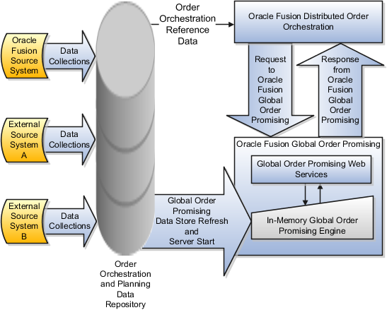

Data Collections, Order Orchestration, and Order Promising: How They Fit Together
You perform data collections to populate the order orchestration and planning data repository. The collected data is used by Oracle Fusion Distributed Order Orchestration and Oracle Fusion Global Order Promising.
The following figure illustrates that the order orchestration and planning data repository is populated with data from external source systems and from the Oracle Fusion source system when you perform data collections. Oracle Fusion Distributed Order Orchestration uses some reference data directly from the repository, but the Global Order Promising engine uses an in-memory copy of the data. After data collections are performed, you refresh the Global Order Promising data store with the most current data from the data repository and start the Global Order Promising server to load the data into main memory for the Global Order Promising engine to use. When Oracle Fusion Distributed Order Orchestration sends a scheduling request or a check availability request to Oracle Fusion Global Order Promising, the Global Order Promising engine uses the data stored in main memory to determine the response.
Order orchestration and order promising
using data from the data repository
Data Collections
You perform data collections to populate the order orchestration and planning data repository with data from external source systems and from the Oracle Fusion source system.
Order Orchestration
Oracle Fusion Distributed Order Orchestration uses some reference data directly from the order orchestration and planning data repository. You must perform data collections for the order orchestration reference entities even if you are not using Oracle Fusion Global Order Promising.
Important
Before collecting data from an Oracle Fusion source system, you must define at least one organization for the source system. After you have defined at least one organization for the source system, you must update the organization list for the source system on the Manage Planning Source Systems page or Manage Orchestration Source Systems page, and enable at least one organization for collections. If there are no organizations enabled for collections when a collections process runs, the collections process will end with an error.
Order Promising
The Global Order Promising engine uses an in-memory copy of the data from the order orchestration and planning data repository. When Oracle Fusion Distributed Order Orchestration sends a scheduling request or a check availability request to Oracle Fusion Global Order Promising, the Global Order Promising engine uses the data stored in main memory to determine the response to send back to order orchestration. After a cycle of data collections is performed, you refresh the Global Order Promising data store with the most current data from the data repository and start the Global Order Promising server to load the data into main memory for the Global Order Promising engine to use.

The order orchestration and planning data repository provides a unified view of the data needed for order orchestration and order promising. You manage data collection processes to populate the data repository with data collected from external source systems and from the Oracle Fusion source system. You manage the data collection processes to collect the more dynamic, transaction data every few minutes and the more static, reference data on a daily, weekly, or even monthly schedule. The data collected into the data repository contains references to customer data managed in the Oracle Fusion Trading Community Model and to product data managed in the Oracle Fusion Product Model. The data managed in these models is not collected into the order orchestration and planning data repository.
The following figure illustrates that the order orchestration and planning data repository is populated with data collected from external source systems and from the Oracle Fusion source system. The data repository does not contain data managed by the Oracle Fusion Trading Community Model and the Oracle Fusion Product Model. The data collected into the data repository references data managed in these models.
Data collections for the order orchestration

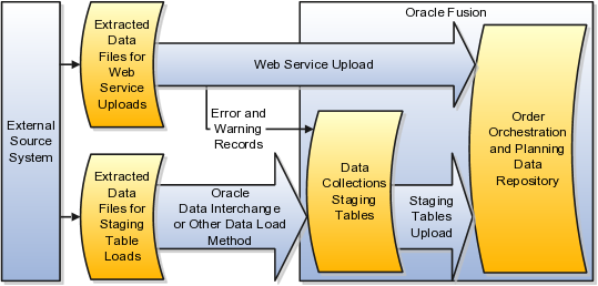

Data Collection Methods for External Source Systems: Explained
To populate the order orchestration and planning data repository with data collected from external source systems, you use a combination of two data collection methods. The two methods are Web service uploads and staging tables uploads.
The following figure illustrates the two data collection methods, Web service uploads and staging tables uploads, used to collect data from external source systems. The figure illustrates that both methods require programs to be written to extract data from the external source systems. For Web service uploads, you load the data from the extracted data files directly into the order orchestration and planning data repository. Any records with errors or warnings are written to the data collections staging tables. For staging table uploads, you load the data from the extracted data files into the data collections staging tables, and then you use the Staging Tables Upload program to load the data from the staging tables into the data repository.
The two methods for collecting data
You determine which entities you collect from which source systems and at what frequency you need to collect the data for each entity. The data for different entities can be collected at different frequencies. For example, supplies and demands change frequently, so collect data for them frequently. Routings and resources, are more static, so collect data for them less frequently.
Which data collection method you use for which entity depends upon the frequency of data changes as follows:
Web Service Upload Method
Use the Web service upload method for entities that change frequently, such as supply and demand entities. You determine the frequency of collections for each entity. For certain entities, you may implement Web services to run every few minutes. For other entities, you may implement Web services to run hourly.
To implement and manage your Web service uploads, you must design and develop the processes and procedures to extract the data in the format needed by the data collection web services. For more information regarding the data collection Web services, refer to the Oracle Enterprise Repository. For additional technical details, see Oracle Fusion Order Promising Data Collection Staging Tables and Web Service Reference, document ID 1362065.1, on My Oracle Support at https://support.oracle.com.
Staging Tables Upload Method
Use the staging tables upload method for entities that do not change frequently, such as routings and resources. You determine the frequency of collections for each entity. You may establish staging table upload procedures to run daily for some entities, weekly for some entities, and monthly for other entities.
To implement and manage your staging table uploads, you must develop the processes and procedures you use to extract data from an external source system. You use Oracle Data Interchange, or another data load method, to load the extracted data into the data collection staging tables. For additional technical details, such as the table and column descriptions for the data collection staging tables, see Oracle Fusion Order Promising Data Collection Staging Tables and Web Service Reference, document ID 1362065.1, on My Oracle Support at https://support.oracle.com.
For the final step of the staging tables upload method, you initiate the Load Data from Staging Tables process from the Manage Data Collection Processes page or via the Enterprise Scheduling Service.

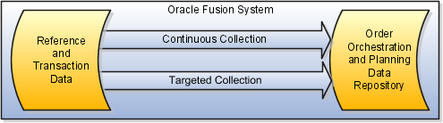

Data Collection Methods for the Oracle Fusion Source System: Explained
To populate the order orchestration and planning data repository with data collected from the Oracle Fusion source system, you use a combination of two data collection methods: continuous collection and targeted collection. You typically use continuous collection for entities that change frequently and targeted collection for entities that are more static.
The following figure illustrates the two data collection methods, continuous collection and targeted collection, used in combination to collect data from the Oracle Fusion source system.
Data collections from the Oracle Fusion
Source System
Continuous Collection
When you use the continuous collection method, you are only collecting incremental changes, and only for the entities you have included for continuous collection. Because continuous collection only collects incremental changes, you usually set up the continuous collection to run frequently, such as every five minutes.
Note
Prior to including an entity for continuous collection, you must have run at least one targeted collection for that entity.
Targeted Collection
When you collect data using the targeted collection method, you specify which entities to include in the targeted collection. For the included entities, the data in the data repository that was previously collected from the Oracle Fusion source system is deleted and replaced with the newly collected data. The data for the entities not included in the targeted collection is unchanged. You typically use the targeted collection method to collect data from entities that do not change frequently.

Review Orchestration Collected Data
Data Collections Daily Monitoring: Explained
When you manage the data collection processes, you use the Process Statistics report and the Data Collection Summary report to routinely monitor your collections. When error records are reported, you query the data staging tables for further details regarding the error records. You can also review most of your collected data using the review collected data pages.
The following information sources are available for you to monitor data collections:
Process Statistics Report
You view the Process Statistics report to monitor summary of statistic for the daily collections activity for each of your source systems. This report is available on the Actions menu when managing data collection processes for either the continuous collection publish process or the collections destination server. The day starts at 00:00 based on the time zone of the collection server.
For the Oracle Fusion source system, statistics are provided for both the continuous collection and the targeted collection data collection methods. For each external source system, statistics are provided for the Web service upload and for the staging tables upload data collection methods. The following statistics are provided in the Process Statistics report:
Note
The process statistics provide summary information, and are not intended for detailed analysis of the collections steps. Use the Oracle Enterprise Scheduler Service log files for detailed analysis.

Errors and Warnings When Collecting Data from External Source Systems: How They Are Handled
When you are collecting data from external source systems, the data collection processes perform many data validation checks. If the data validations fail with errors or warnings, the steps taken by the data collection processes vary slightly depending upon whether the Web service upload data collection method or the staging tables upload data collection method is used.
In both cases, records where errors are found are not loaded into the order orchestration and planning data repository. Instead records are loaded into, or remain in, the applicable staging tables with an appropriate error message. Records where only warnings are found are loaded to the data repository, and records are loaded into, or remain in, the applicable staging tables with an appropriate warning message.
Settings That Affect Error Handling When Collecting Data from External Source Systems
The handling of errors and warnings encountered when the data collection processes validate data during collections from external source systems depends upon which data collection method is used, Web service upload or staging tables upload.
How Errors and Warnings Are Handled
When you are running data collections using the Web services method, records without errors or warnings are loaded into the data repository. For records with errors or warnings the following error and warning handling steps occur when using the Wed services method:
When you are running data collections using the staging tables upload method, the following error and warning handling steps occur:

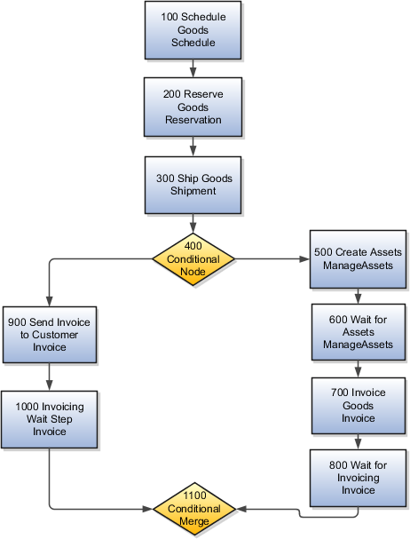

Define Orchestration Processes
Orchestration Process Definitions: Explained
An orchestration process is a process flow that approximates your organization's fulfillment process. An orchestration process contains a sequence of steps that takes a fulfillment line through the fulfillment process. An orchestration process contains the instructions for how to process an order, such as which steps and services to use, step dependencies, conditional branching, lead-time information, how to handle change orders, which status values to use, and more. You define orchestration processes according to your organization's needs. You create rules, so that at run time the appropriate orchestration process is automatically created and assigned to the new fulfillment lines.
If you want to use the ShipOrderGenericProcess and ReturnOrderGenericProcess predefined orchestration processes, then you must generate them and deploy them; it is not necessary to release them.
Defining Orchestration Processes: Examples
Orchestration process definitions include the sequence of task layer service calls, as well as planning details, change management parameters, and status conditions. Use the following examples to understand how you can use orchestration process definitions to model your business processes.
Sequence of Task Layer Service Calls
You are an order administrator at a company that sells widgets. You list the logical steps that are required to fulfill an order. Then you create an orchestration process that mirrors your business process.
The first steps are:
(Statuses are represented in all uppercase letters.)
Your company requires that a representative call the customer when an invoice exceeds $100,000. You continue creating the orchestration process by adding a conditional step (which is not a task layer service call):
Afterwards, the steps continue as follows:
Otherwise, the steps are:
A merge node ends the branch.

Branching: Explained
Use branching to create a sequence of steps that are executed only under certain conditions. A branch contains one or more steps. For example, your company sells laptop computers. If a customer buys a service agreement with the laptop computer, then you create an asset, so that the computer can be tracked. If a service agreement is not purchased, then the customer is invoiced without creating an asset.
The following figure shows an orchestration process flow that models this scenario. Each step contains the step number, task name, and task type. This example includes the ManageAssets custom task type. The conditional node indicates that an orchestration process is about to branch. The first step of the branch contains the condition. If the condition is met, then the application executes the steps on the branch that includes the Create Asset and Wait for Asset steps. Otherwise, the other branch is executed, and an invoice is created without creating an asset.
Orchestration Process with Two Branches
You do not need to set an Otherwise condition in the orchestration process definition if you have only one branch. When the orchestration process artifacts are generated, an empty default branch is added.
