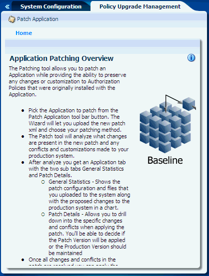

The Policy Upgrade Management tab, partially illustrated in Figure 7-1, contains the tab Home, where the upgrading process begins and which succinctly describes the steps you follow to upgrade application policies. The first step is to select the application whose policies to upgrade.
Figure 7-1 The Policy Upgrade Management Tab

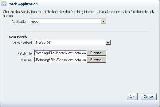

In the Home tab of the Policy Upgrade Management page, click the button Patch Application at the top left corner of the page to bring up the Patch Application dialog illustrated in Figure 7-2.
Select the application to patch from the pull-down Application list.
This list displays only applications that are currently deployed in the domain. After selecting the application, the dialog takes a different form according to whether or not the application selected has a patching in progress.
If the application has a patching in progress, you can continue with it or abort it.
If the application does not have a patching in progress, select the Baseline file (specifies the location of the baseline policy store) and the Patch file (specifies the location of the patch policy store) and click OK. The only Patch Method available in this release is a 3-way DIFF which considers differences between the baseline, the production, and the patch stores
The rest of this procedure assumes a new patching process. Authorization Policy Manager displays an indicator showing the progress of the analysis phase in the Patch Application dialog. Once this phase is completed, the Patch Application dialog displays the statistics of the analysis as illustrated in Figure 7-3.

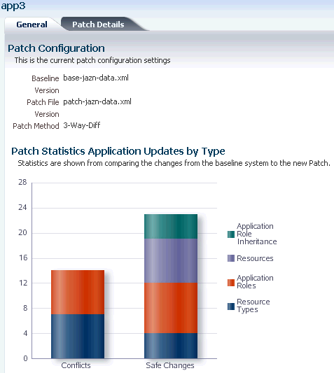

Authorization Policy Manager creates a new tab (named after the application display name) that contains the details of the results, that is, the conflicts and differences encountered, in two sub-tabs:
General - This tab displays the files you have specified at the start of the patching and a chart showing the number changes and conflicts found, per artifacts, between the baseline and the patch stores. For details about these terms, see Section 7.5.1, "Changes and Conflicts." Figure 7-4 illustrates the General tab.

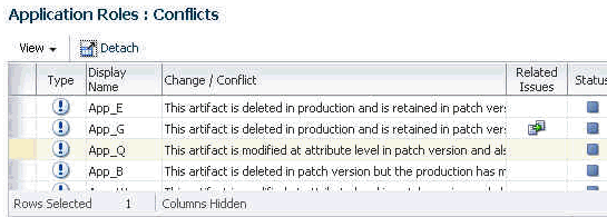

To display the specifics of an object's differences in the right area, click Changes or Conflicts under the object. Each row in the table has a type icon that indicates whether the difference is a change (double arrow icon) or a conflict (exclamation mark icon). (For details, see Section 7.5.1, "Changes and Conflicts.")
To view a change or conflict for a specific artifact, select the corresponding icon. All changes or conflicts are displayed in a table at the top of the page. The Status column shows whether a change or a conflict has been resolved (green check icon) or not (gray square icon). The Related Issues column shows whether a change or conflict has implied dependencies; click the icon in this column to display the Patch Artifact Dependencies dialog and see, among other details, the reasons why other artifacts would be affected when resolving a difference for this artifact. Figure 7-6 partially illustrates this page.

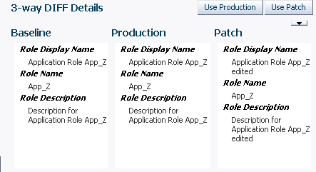

To view conflict details for a specific item in the table, select the item to display the different specifications found in the 3-Way DIFF Details area. Figure 7-7 illustrates the differences for a role.

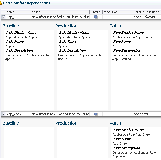

Figure 7-8 partially illustrates the dependencies implied by differences in a pair of roles. Specifically, it illustrates a baseline role App_Z that is not modified in the production store but modified in the patch store as follows:
The display name and the role description are changed.
The new role App_Znew is a child of the role App_Z.
Figure 7-8 Viewing Dependencies Implied by a Conflict or Change

Select the artifact in the Conflicts table, to display the specifications for the artifact found in each of the three stores at the bottom of the page.
Inspect specification differences and decide which one to use; to use the production store, click the button Use Production; to use the specification in the patch store, click the button Use Patch.
