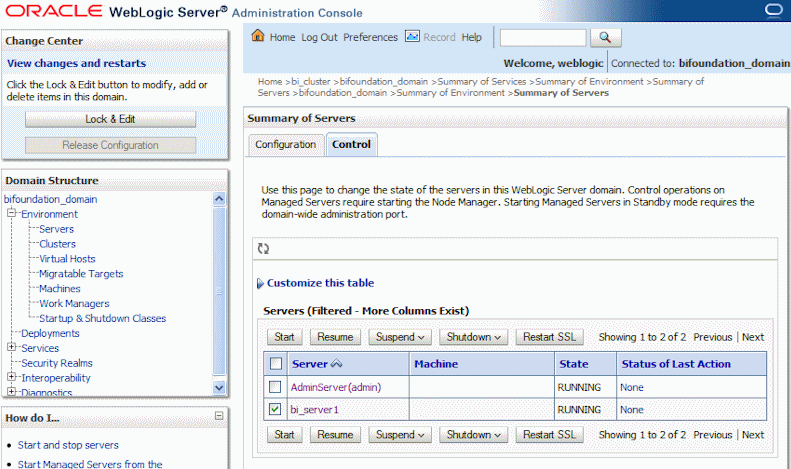

To use the Oracle WebLogic Server Administration Console to start and stop BI Publisher:
Start the Oracle WebLogic Server Administration Console.
Under the Domain Structure, expand Environment.
Click Servers to display the Summary of Servers table.
Click Control. Select the server and then click the appropriate action, as shown in Figure 1-1.

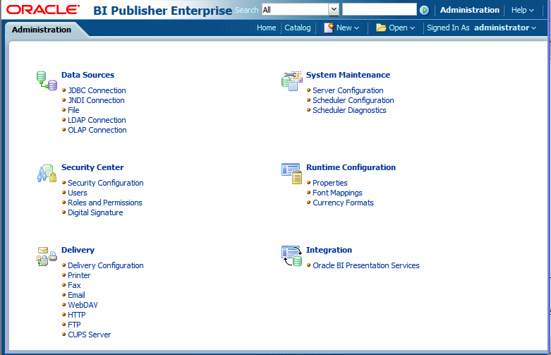

Many of the tasks described in the Administration section of this guide are performed from the BI Publisher Administration page. You must be granted Administrator privileges to access the Administration page.
The Administration page is accessed from the Administration link in the global header. Figure 1-2 shows the Administration page:
If you installed Oracle BI Publisher with the Oracle Business Intelligence Enterprise Edition, then you must perform the Administration tasks in the BI Publisher Administration page, as described in the following table. Navigate to the BI Publisher Administration page as follows:
In the global header, click Administration, on the Administration page, click Manage BI Publisher.
Table 1-3 BI Publisher Administration Tasks
| Task | Where to Get Information |
Set up data source connections for reporting |
Grant access to data sources for user roles defined in Oracle Business Intelligence |
Configure the connections to delivery servers (for example, printers, e-mail servers, FTP servers, and so on) |
Configure the scheduler processors |
Configure system runtime properties such as PDF security properties, properties specific to each output format, template type properties, font mappings, and currency formats. |
Configure server properties such as caching specifications, database failover properties, and database fetch size. |
