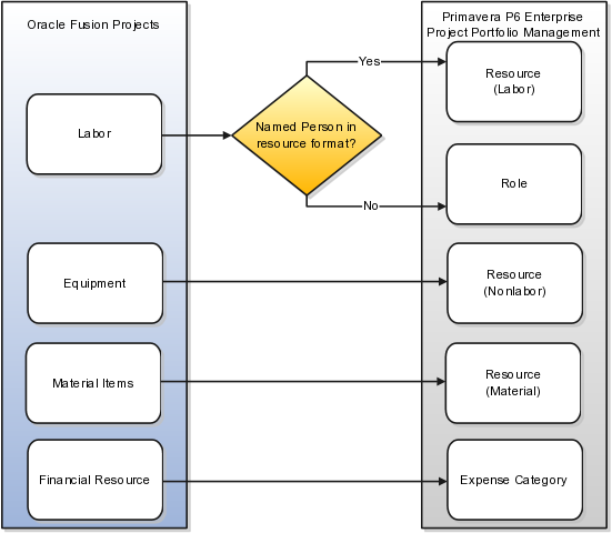

As illustrated in the following diagram, planning resources are exported to Primavera P6 Enterprise Project Portfolio Management based on the associated resource class, and in the case of labor resources, on the associated resource format:
Resources of the Labor resource class are exported as follows based on the resource format:
If the resource format contains the Named Person resource type, it is exported as labor resource.
All other resource formats are exported as roles.
Resources of the Equipment resource class are exported as nonlabor resources.
Resources of the Material Items resource class are exported as material resources.
Resources of the Financial Resource resource class are exported as expense categories.

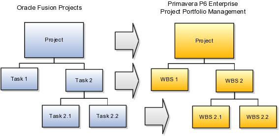

In Primavera P6 Enterprise Project Portfolio Management, exported projects are added to an enterprise project structure (EPS) node called Imported Projects. Move the exported projects to a different EPS node as required.
As illustrated in the following diagram, during initial export, project information from Oracle Fusion Projects is used to create a new project in Primavera P6 Enterprise Project Portfolio Management. Alternatively, if the project number of a project matches the project ID of an existing project in Primavera P6 Enterprise Project Portfolio Management, then the two projects are linked.
Similarly, WBSs are created for each task in the hierarchy, up to the lowest-level task. The tasks and WBS are linked. If you build out your WBS in Primavera P6 Enterprise Project Management by adding further WBS and activities, all information is summarized up to the integrated WBS before project plan information is imported into Oracle Fusion Projects.
