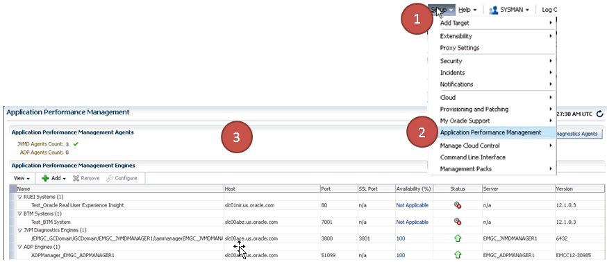

In Cloud Control, from Setup menu, select Application Performance Management.
For more information about the Application Performance Management page, see Figure 11-1.

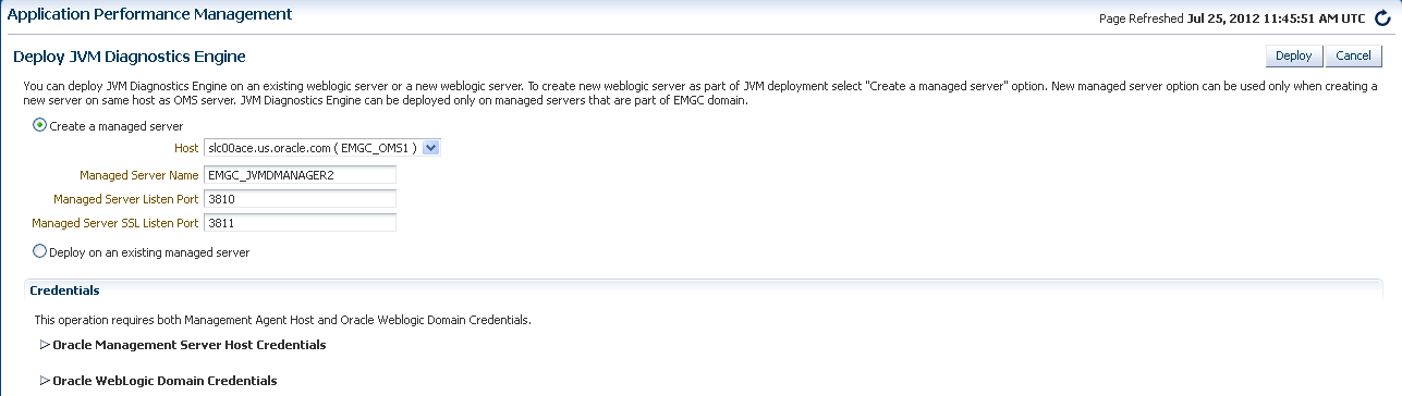

On the Application Performance Management page, from the Add menu, select JVM Diagnostics Engine.
On the Deploy JVM Diagnostics page, select Create a managed server, and enter the following details:
Select an OMS Server from the Host list. The list is comprised of all the servers present in the Enterprise Manager WebLogic domain.
For example, host1.example.com (EMGC_OMS1),
host2.example.com (EMGC_OMS2)
, and so on.
Enter a unique name for the managed server in the Managed Server Name field.
For example, EMGC_JVMDMANAGER1
, EMGC_JVMDMANAGER2,
and so on.
The Port numbers for Managed Server Listen Port and Managed Server SSL Listen Port are populated with the default values 3800 and 3801 respectively. You can change these values by entering custom value if required.
Specify the Oracle Management Server Host Credentials and Oracle WebLogic Domain Credentials:
Where,
Oracle Management Server Host Credentials are the credentials for the host machine where the OMS server selected is running. For example, the OMS selected is EMGC_OMS1
(host1.example.com)
Oracle WebLogic Domain Credentials are credentials of the Weblogic domain in the Enterprise Manager Cloud Control.
For more information about credentials, see Selecting Credentials.
Click Deploy to submit the job.

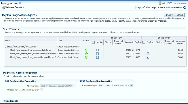

On the Deploy Diagnostics Agents page as shown in Figure 11-3, choose the Oracle WebLogic Server (managed servers) to which you want to deploy the JVMD agents.
Ensure that you retain the selection of only those Diagnostic Agent(s) that you want to deploy to each of the Managed Servers, deselect the others.
By default, the following servers appear deselected:
The Administration server is not selected by default.
All the managed servers that are not up and running appear deselected by default.
If the Deployed Version and the Version to Deploy are the same, and the status of the already deployed JVMD agent is up and running.
In the Diagnostics Agent Configuration section, enter the JVMD Configuration Properties for the selected agents.
Select the desired JVMD manager from the JVMD Manager list.
The JVMD agents selected for deployment will report to this JVMD Manager.

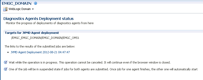

Click Deploy to submit the job. A Diagnostics Agent Deployment status page as follows appears:
The Status page appears with a link to the job status. Click the link to see the status of the job that you submitted.
On the Application Performance Management page, all the deployed Managed Servers are listed. Attributes like Host, Port, SSL Port, Version, Status, Availability, and Server available on the Application Performance Management page helps monitor the status and the availability of the JVMD Manager.
