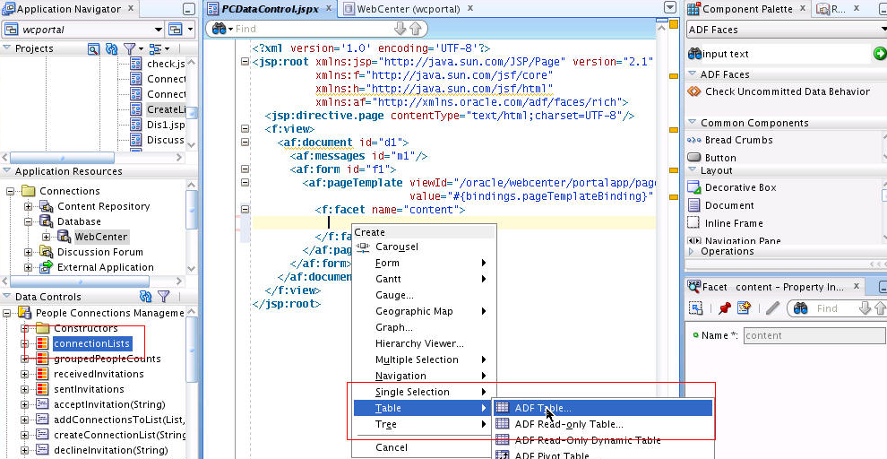

  6. Drag and drop the data control object on to the.jspx page and select the ADF Table option in the drop-down Table menu list, shown in Figure 40-1.
    Figure 40-1 The Data Control Object Dragged and Dropped on to a .jspx Page With ADF Table Selected
    Description of Figure 40-1 follows
    Description of "Figure 40-1 The Data Control Object Dragged and Dropped on to a .jspx Page With ADF Table Selected"

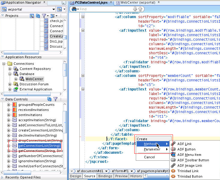

  7. To use the available Java methods, drag the methods to the .jspx page and select the Method item in the Create menu list, as shown in Figure 40-2, and bind it to the data in your project to achieve the desired functionality.
    Figure 40-2 Dragging and Dropping Java Methods to the .jspx Page and Selecting Method in the Create Menu List
    Description of Figure 40-2 follows
    Description of "Figure 40-2 Dragging and Dropping Java Methods to the .jspx Page and Selecting Method in the Create Menu List"
