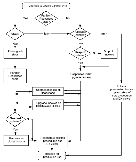

There are two basic sets of decisions you must make to plan the upgrade:
  • Whether and when to convert to a partitioned Responses table
  • If you are not partitioning, when and how to upgrade the index structure of the Responses table
These two decisions are inter-related — the conversion to partitioning subsumes the index upgrade. If you decide that you will be partitioning shortly after upgrading, you might want to skip the separate index upgrade. Conversely, if you are postponing partitioning you might want to do the separate index conversion soon after upgrade. If you are not converting to partitioning, you need to consider the path to index upgrade (see ).
If you have a fresh installation of Oracle Clinical, you do not need the index upgrade. You do need to decide about partitioning.
Timing Considerations and Deferral of Index or Partition Upgrade
The index upgrade and partitioning both require impact analysis in advance and both can take a significant amount of time to implement. Assuming that the impact analysis is done prior to upgrading and the upgrade path chosen, the primary consideration for when to upgrade is the elapsed time needed to perform the actual upgrades. While either could be done at the same time as the upgrade, deferring the index or partition upgrade to a separate time might reduce the risk and time pressure. The index upgrade is the least time-consuming and is easily performed overnight even on a large database. Partitioning is more time-consuming and, while it can easily be accomplished over a weekend on even the largest Oracle Clinical database, it needs more careful advanced planning.
If you decide to defer both partitioning and the index upgrade, you can force Oracle Clinical to continue to create validation and derivation procedures and data extract views that are optimized for the pre-4.0-style index structure (see "Enforcing Pre-Version 4.0 Optimization").
The upgrade for Responsest should be done at the same time as either partitioning or the Responses table index upgrade.
See "Upgrading Indexes" for more information. This upgrade can be done at any time that is convenient.
Figure 9-1 Partitioning and Indexing Decision Paths
Description of Figure 9-1 follows
Description of "Figure 9-1 Partitioning and Indexing Decision Paths"
If you decide to postpone both the partitioning and indexing upgrades, you can force Oracle Clinical to continue to create validation and derivation procedures and data extract views that are optimized for the pre-4.0-style index structure.
You do this by inserting a record in the local OCL_STATE reference codelist with the short value of USE RESP_DCMQG and a long value of YES.
Later, when you are ready to convert to the new index scheme or partitioning, change the long value to NO before you regenerate views and procedures. The absence of an entry is equivalent to NO.

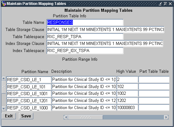

Implement Partition Structure
Once you have executed the script, you can use the Maintain Partition Mapping Tables form, shown in (navigate to Admin, then Partition Admin), to implement the partitioning scheme determined above.
You always specify the maximum clinical_study_id included in a partition. The minimum is implicitly one more than the maximum of the previous partition.
You can delete rows to merge partitions. You can edit the storage clauses to reflect consolidation or to adjust the storage because you are aware of factors that affect the size, such as planned rapid growth of a partition. Bear in mind that you can always rebuild a partition later, independent of the upgrade process.
Figure 9-2 Maintain Partition Mapping Tables Window
Description of Figure 9-2 follows
Description of "Figure 9-2 Maintain Partition Mapping Tables Window"

Partitioning the Responses Table
Once you have prepared the partition table and index creation scripts, you are ready to perform the partition upgrade. The upgrade consists of the following steps:
  1. Back Up the Database.
  2. Export the Responses Table.
  3. Prepare the Database:
    1. Drop Responses Table
    2. Reorganize Tablespaces and System File Space
    3. Create Partitioned Responses Table
  4. Import Responses Data.
  5. Compute Statistics on the Responses Table.
  6. Compile Invalid Objects and Restore Database Trigger.
  7. Back Up the Database (can be deferred to after Step 8).
  8. Regenerate Procedures and Data Extract Views.
  9. Back Up the Database. (Optional, can be deferred to normal backup schedule.)

Oracle Clinical includes the partition mapping form (see "Maintain Partition Mapping Tables Window") and a utility script generator that support SPLIT and MERGE operations and changes to ongoing storage characteristics.

When you determine that you need to merge or split partitions, first use the Maintain Partition Mapping form (see ). Insert records for partitions that are to be split or delete records for partitions that are to be merged. You can also alter the storage clauses for partitions, although this affects only new storage allocations — it does not rebuild the existing partition space.
You then use the utility script gen_alter_partition.sql to generate the SQL partition maintenance commands.
gen_alter_partition output_file.sql
For example:
SQL> @gen_alter_partition.sql alter.sql
The generation script compares the partition definition in the Oracle Clinical Partition Mapping table with the actual partition structure in the database. It then generates the SQL DDL statements to merge or split the partitions and to alter the storage clauses (see ).
You should review the generated script and make any necessary modifications before you run it.
