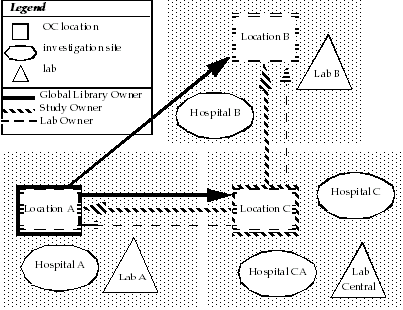

Example of an Oracle Clinical Distributed Study
Figure 13-1 illustrates a sample installation configuration for an Oracle Clinical study that is distributed over three physically separate locations.
In this installation:
  • One study is being conducted at the investigation sites, that is, Hospital A, Hospital B, Hospital C, and Hospital CA.
  • Location A is the Global Library-owning location.
  • Location C is the study-owning location.
  • Location A and Location B are study-sharing locations.
Location A Maintains Global Information
As the Global Library-owning location, Location A is responsible for maintaining Global Library objects, and global lab information (lab units and panels).
Location C Replicates the Global Library
Location C, which is the study-owning location, is responsible for designing the study and defining study elements. Before beginning the study design and definitions, Location C must replicate the Global Library from Location A. To complete the study definition, Location C may need the global lab information as well. The heavy black arrow between Location C and Location A represents this replication task.
Sharing Locations Replicate Study Design and Definitions
Once Location C completes the study design and definitions, and makes the study available for replication, then the other locations (Location A and Location B) must replicate these study elements from Location C. The heavy gray arrows from Location C to both Location A and Location B represent this replication task.
Location A and Location B cannot modify any of the study design or definition elements. However, these locations must maintain certain local responsibilities such as assigning sites and investigators.
Local Processing and Lab Replication
Each location in the installation deals with local facilities to conduct their part of the study.
Location A conducts investigations at Hospital A and processes results at Lab A. Likewise, Location B conducts investigations at Hospital B and processes results at Lab B. Each of these Oracle Clinical locations is a lab-owning location for its local lab.
Location C has two hospitals serving as investigation sites, but this setup has no ramifications for replication. However, the lab setup at Location C does have an effect on replication. Location C is the lab owner for Lab Central, which services Location C and also processes some tests for the other locations. As part of its lab owning responsibility, Location C maintains the lab ranges for Lab Central. Because the other locations (Location A and Location B) use Lab Central, they must replicate the ranges for Lab Central from Location C. The dotted-line arrows from Location C to both Location A and Location B represent this replication task.
Figure 13-1 Sample Installation with Three Physically Separate Locations
Description of Figure 13-1 follows
Description of "Figure 13-1 Sample Installation with Three Physically Separate Locations"
Table 13-1 summarizes the roles and responsibilities for each location (Location A, Location B, and Location C) in the sample Oracle Clinical distributed study.

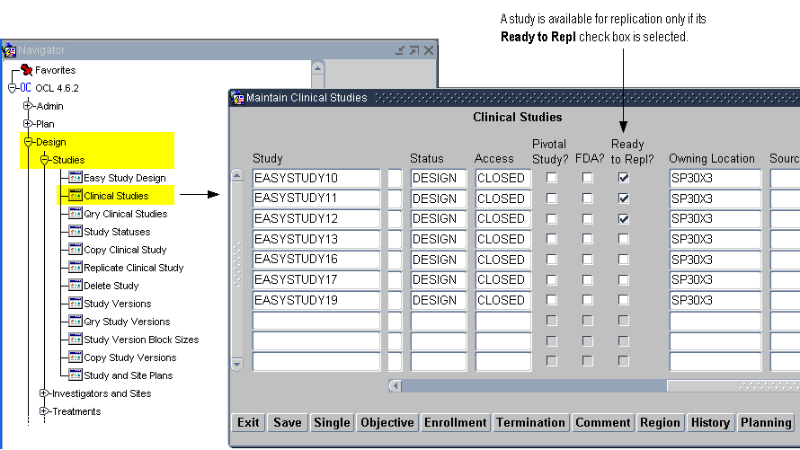

Enabling a Study for Replication
A study is available for replication only if its Ready to Repl check box is selected. In addition, only the study-owning location can designate when a study is ready for replication.
To enable a study to be available for replication:
  1. Navigate to Design, Studies, and then select Clinical Studies.
  2. Scroll to the right in the window.
  3. Select the Ready to Repl? check box. See Figure 13-2.
  4. Click Save.
Figure 13-2 Enabling a Clinical Study for Replication
Surrounding text describes Figure 13-2 .

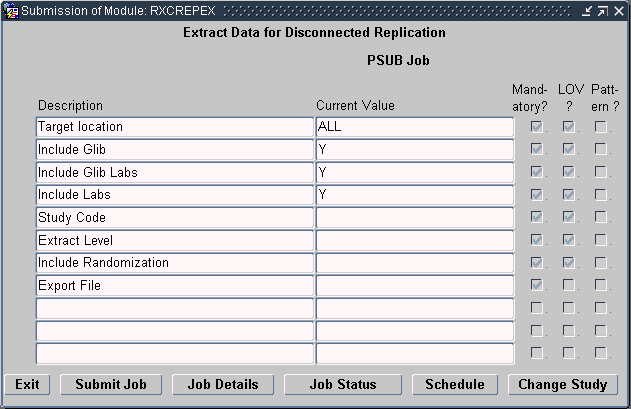

  1. Navigate to Admin, Replication, and then select Disc Repl Export.
    Oracle Clinical opens an Extract Data for Disconnected Replication window, which varies slightly depending on whether the location owns the Global Library for the selected database.
    Note that the window includes the following parameters only if the location is the Global Library-owning location:
    • Include GLIB
    • Include GLIB Labs
    Surrounding text describes disc_repl_export01.gif.
  2. Enter values for the parameters displayed in the Extract Data window. See "Defining the Extract Data Parameters" for details.
  3. Click Submit Job to send the replication job to the Parameterized Submission (PSUB) utility for processing.
    Alternatively, you can click Schedule to schedule the job for a particular date and time.
    For additional information about using the Parameterized Submission (PSUB) utility to submit jobs, see Oracle Clinical Getting Started.

This section describes the values that you can enter for each parameter displayed in the Extract Data window.
Target Location
Select the name of a specific target location or select ALL. Note that the available target locations are based on the active values in the SOURCE LOCATION CODE installation reference codelist. See Figure 13-3.
The value you select depends on the type of data you are replicating:
  • For Global Library, Global labs (textbook ranges and conversion tables), or lab data, select ALL to extract data for replication to multiple sites. Select the name of one target location to extract data for replication to a single site.
  • For study design, study definition, or patient data, select the name of one target location to extract data for replication to a single site.
Figure 13-3 Available Target Locations based on SOURCE LOCATION CODE Installation Codelist
Surrounding text describes Figure 13-3 .
Include GLIB
Set to Y to include Global Library information in the exported file. Note that the Include GLIB parameter is available only at the Global Library-owning location.
Include GLIB Labs
Set to Y to include textbook ranges and conversion tables in the exported file. The replicated data includes the following information:
  • Textbook Ranges
  • LAB_PANELS
  • LAB_PANEL_QUESTIONS
  • LAB_TEST_QUESTION_UNITS
  • LAB_UNITS
  • LAB_UNIT_CONVERSIONS
  • PREFERRED_LAB_UNITS
  • PREFERRED_LAB_UNIT_GROUPS
Note that the Include GLIB Labs parameter is available only at the Global Library-owning location.
Include Labs
Set to Y to include lab information in the exported file.
Study Code
Enter the appropriate value depending on the type of data you are replicating:
  • For study design, study definition, or patient data, select the name of a study. When you select a specific study, you can use the exported file only at the one site specified in the Target location field.
    Note that a study is available for replication only if its Ready to Repl check box is selected. See "Enabling a Study for Replication" for details.
  • For Global Library data, enter N/A.
  • Studies previously owned by the current location and now being given to the target location.
Extract Level
Enter the level of data you want to replicate and export to the file. Valid values are:
  • DESIGN — Study design
  • DEFINITION — Study design and study definition
  • DATA — Study design, study definition, and data
  • N/A — Not applicable
Include Randomization
Set to Y to include randomized treatment assignments to patient positions.
Export File
Enter the name of the file to which Oracle Clinical exports the data. The directory path defaults to the path on the PSUB server defined in REPL_ROOT in the OCL_STATE local reference codelist.

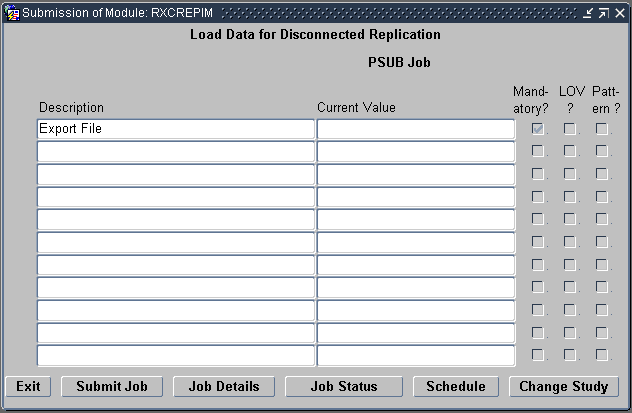

  1. Navigate to Admin, Replication, and then select Disc Repl Load. Oracle Clinical displays the Load Data for Disconnected Replication window.
    Surrounding text describes disc_repl_load.gif.
  2. Enter the name of the export file to load.
  3. Click Submit Job to send the job to the Parameterized Submission (PSUB) utility for processing.
