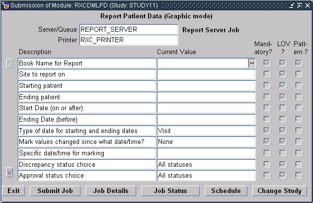

The Submission of Module window appears, showing the parameters required for execution of the selected job.
Submission of module. You enter values for all the mandatory parameters.

When you select a task that requires a batch job, the Submission of Module window appears and displays a list of the parameters needed, as shown in . The list may include a few of the fields that show on the final report or process. It may also include some fields that are not part of the final process but that limit the number of records in the report, or that are required in order to execute the job.
The label at the top center shows your current task. The label below the task name indicates whether the job is a Report or a PSUB job (some tasks that generate reports are run by PSUB, not the Oracle Reports server). If it is a Report, you can now choose which server computer you want to run it, and, if the output type is PRINTER, which printer you want.
The parameters in the Description column are displayed with their default values, if any. Three check boxes indicate the options for setting these parameter values:
Table 4-1 Check boxes in the PSUB Window
| Check box | Effect |
Mandatory? |
If checked, the parameter must have a value. If there is no default value supplied, you must enter one. |
LOV? |
If checked, a List of Values is available for you to choose from. |
Pattern? |
If checked, you can use a wildcard search to limit the number of records reported. |
When you enter a value for a parameter in the Current Value field, Oracle Clinical validates the value to ensure that it meets any requirements established for the parameter. You receive a message if the value you entered fails validation.

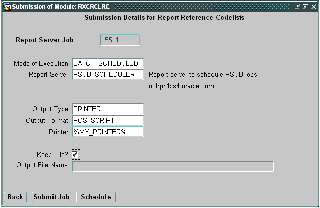

The Submission Details for Task window allows you to specify the output form of the results of a batch job: print, computer display (screen), or file, and where and when you want it to be printed or saved.
Figure 4-2 Submission Details for Task Window
Follow these steps to modify fields in the Submission Details for Task window:
Fill in the fields for Mode of Execution, and server or printer.
If Mode of Execution is set to batch_scheduled, you must save the parameter set before submitting the job. See "Saving a Parameter Set".Make sure that all other parameters are set to your satisfaction. Contact your system administrator for more information on batch and print queue names.
Click Submit Job to start the job and return to the Submission of Module window.

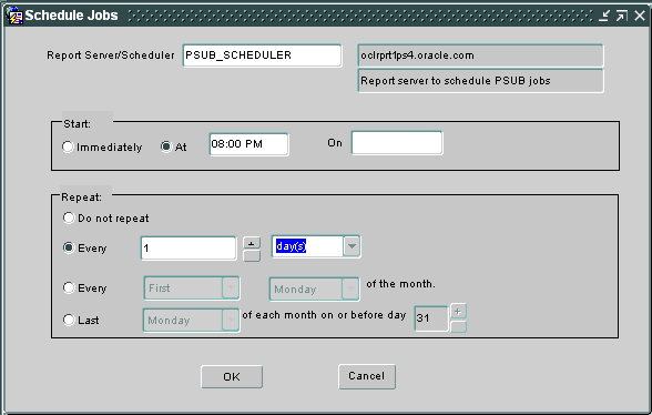

Click the Schedule button in either the Submission of Module or the Submission Details window to schedule a job, either repeating or not (called "batch deferred" in previous versions).
Table 4-3 Fields in the Schedule Jobs Window
| Name | Description |
Report Server/Scheduler or Schedule Queue |
Reports Server that processes reports jobs or Reports Server that schedules PSUB jobs. Display only. Value set in Submission Details for Task window. |
Start |
Use these fields to set the time and day. |
Immediately option |
As soon as your request gets to the server. Use this option only if the scheduled job starts on today. You must enter the first date the job runs in the At option, if it is not today. |
At option, time field |
Time of day in format HH:MI AM or PM, that is, a twelve-hour clock. |
On option, date field |
The date of the first run of the job. Day of the year in your local format (default is dd-mon-year). |
Repeat |
Use these fields to set the interval between repeats (if any). |
Do not repeat option |
Run the job just once. |
Every option, number and units fields |
A positive integer and a unit of time. Default is 1 Hour. shows every day. |
Every option, ordinal and day fields |
An ordinal number and a day of the week. Default is first Monday of the month. |
Last option, day and date fields |
A day of the week and a date of the month. Default is last Monday on or before the 31st of the month. |
