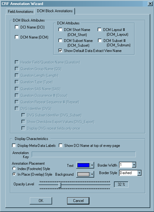

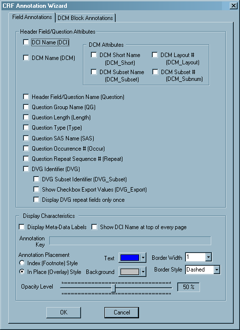

You access CRF Annotation Tool by clicking Annotate CRF on the RDC Toolbar in the DEW. This button is only active when you use the Create Annotation action in the GLE.
Figure 12-2 CRF Annotation Tool - DCM Block Annotations Tab
The CRF Annotation Tool window is comprised of two tabs: Field Annotations and DCI Block Annotations. As Figure 12-1 and Figure 12-2 illustrate, the set of configurations on each tab are similar. However, there are certain differences, which are based on the what each type of annotation entails.
Both tabs include a Display Characteristics section, which allows you to control certain formatting aspects and the location of the annotations. The Field Annotations tab includes a Header Field/Question Attributes section, which you use to configure annotations associated with the DCI and DCM header data fields. The DCM Block Annotations tab includes a DCM Block Attributes section. This section includes settings for include DCI and DCM names, and a subsection that consists of settings for DCM attributes. The section also displays settings from the Field Annotations tab in read-only mode.

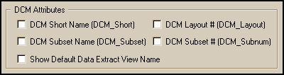

The DCM Attributes section, which is present on each tab, controls DCM-specific annotations at the header/Question field or the DCM block level, depending on which tab you use. The graphic in Figure 12-3 depicts the section that is present in DCM Block Annotations tab. The section in the Field Annotations tab is identical, with the exception of the Show Default Data Extract View Name setting, which is only present in the DCM Block Annotations tab.
The settings that are the same on each tab are: DCM Name, DCM Short Name, DCM Layout and DCM Subset. The settings on each tab are independent of one another. The fundamental difference between the tabs is in determining which annotation is affected.
The DCM Attributes settings in the:
Field Annotation tab control whether the item is included in the annotations for each DCM field
DCM Block tab control whether the item is included in the annotation that is displayed at the top of each DCM block.
Figure 12-3 DCM Attributes Section – DCM Block Annotations Tab
The DCM Attributes section on the DCM Block Annotations tab also includes a Show Default Data Extract View Name setting, which, when selected, includes the name of the data extract view in a separate annotation that is displayed at the top of each DCM block. This setting is not present on the Field Annotations tab because data extract views are applicable at the DCM block level.
The Field Annotations tab, which is depicted in Figure 12-1, "CRF Annotation Tool - Field Annotations tab", consists of two sections: the Header Field/Question Attributes section, which you use to configure annotations at the field level, and the Display Characteristics section, which you use to modify how these annotations are displayed. The settings in the Header Field/Question Attributes section are listed and described in Table 12-2. Each listed setting is selected using a check box. The meta-data name that corresponds to each attribute is in parentheses after the corresponding annotation label.
Table 12-1 Header Field/Question Attributes Section
| Label | Description |
DCI Name (DCI) |
Includes the DCI Name in each DCI header, DCM header, and Question field annotation. This is the only attribute that is not applicable to a form originating in the DCM layout Editor. |
Includes the DCM name in each DCI header, DCM header, and Question field annotation. |
Includes the DCM Short Name (if available) in each DCI header, DCM header, and Question field annotation. |
DCM Layout # (DCM_Layout) |
Includes the DCM layout number in each DCI header, DCM header, and Question field annotation. |
Includes the DCM Subset Name in each DCI header, DCM header, and Question field annotation. |
DCM Subset # (DCM_Subnum) |
Includes the DCM Subset number in each DCI header, DCM header, and Question field annotation. |
Header Field/Question Name (Question) |
Includes the Question name or the header field name in the corresponding annotation for each DCI header, DCM header, and Question field annotation. |
Question Group Name (QG) |
Includes the Question Group name in each Question field annotation. |
Question Length (Length) |
Includes the Question length value in each Question field annotation. In an NLS Study, this value is the length defined in NLS application, which may differ from Question Length defined in Oracle Clinical. |
Question Type (Type) |
Includes the Question type value in each Question field annotation |
Question SAS Name (SAS) |
Includes the SAS name in each Question field annotation. |
Question Occurrence # (Occur) |
Includes the Question occurrence number in each Question field annotation. |
Question Repeat Sequence # (Repeat) |
Includes the Question repeat sequence number in each Question field annotation. |
DVG Identifier (DVG) |
For a repeated DVG in a repeating Question Group, includes the DVG identifier in each Repeating Question field annotation. |
DVG Subset Identifier (DVG_Subset) |
Includes the DVG subset identifier in each Repeating Question field annotation. |
Show Checkbox Export Values (DVG_Export) |
For a DVG field that is represented by a checkbox group, includes each checkbox export value in each Repeating Question field annotation. In an NLS Study, the DVG_Export values are the Local Language translation that is defined in Discrete Value Translation Form in the OC/NLS Application. |
Display DVG repeat fields only once |
For repeated DVG entries, this setting limits the inclusion of the DVG identification information to the first Question field annotation in the group. |
The DCM Block Annotations tab, which is depicted in Figure 12-2, "CRF Annotation Tool - DCM Block Annotations Tab", controls the annotations that are displayed at the start of each DCM block. It consists of two sections: the DCM Block Attributes section, which you use to configure annotations at the DCM Block level, and the Display Characteristics section, which you use to modify how these annotations are displayed. The components of the DCM Block Attributes section is further divided into theDCM Attributes Section, which is described above, and two other settings, which are listed and described in Table 12-2. Each setting is selected using a check box. The meta-data name that corresponds to each attribute is in parentheses after the corresponding annotation label. Unless noted otherwise, each setting is present on both tabs.
Table 12-2 Components of the DCM Block Attributes Section
DCI Name (DCI) |
Includes the DCI Name in each DCM Block annotation. This is the only attribute that is not applicable to a form originating in the DCM layout Editor. |
DCM Name (DCM) |
Includes the DCM name in each DCM Block annotation. |
DCM Short Name (DCM_Short) |
Includes the DCM Short Name (if available) in each DCM Block annotation. |
Includes the DCM layout number in each DCM Block annotation. |
DCM Subset Name (DCM_Subset) |
Includes the DCM Subset Name in each DCM Block annotation |
Includes the DCM Subset number in each DCM Block annotation. |
Show Default Data Extract View Name |
Includes the name of the default data extract view in DCM Block annotation. |
