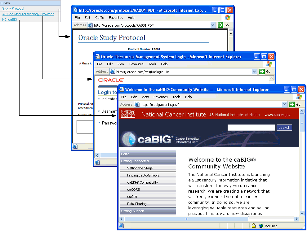

10.1.1 Links on the Home Page
In RDC Onsite, the Links section on the Home page displays your customized links to other Web sites or applications. See Figure 10-1. The Home page supports an unlimited number of links. You can also change the title of the Links section.

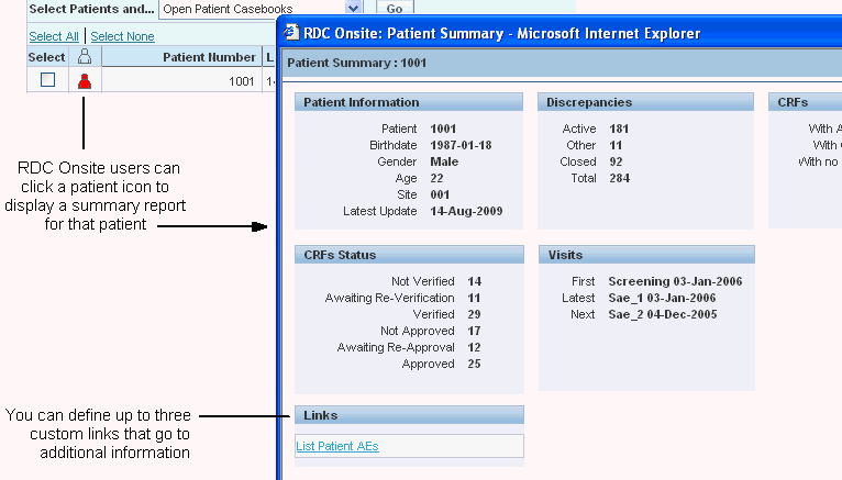

10.1.2 Links on the Patient Summary Report
RDC Onsite lets you display a maximum of three patient links in the Links section of a Patient Summary Report. See Figure 10-2.
In a typical patient link, RDC passes parameters to a custom SQL program and opens a new browser window. The custom program queries the database for patient data and presents a custom report in the new browser window.

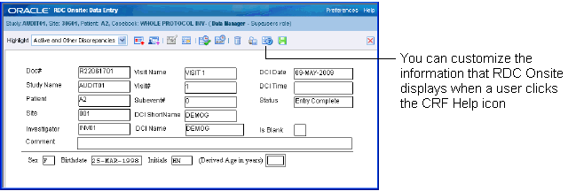

10.1.3 A Link for CRF Help
You can configure one link for the CRF Help icon in the toolbar in the Data Entry window. When the user clicks the icon, RDC Onsite opens a new browser window to the link's target location. RDC Onsite displays the CRF Help icon only if you define and enable a link in the Maintain Links form.

10.5 Defining Links for the Patient Summary Reports
You can define a maximum of three links for the Links section of a Patient Summary Report. These links have a scope of Patient.

10.5.1 Parameters for a Patient Link
Use scope type Patient to create links for the Patient Summary Report.
  • For a static link of scope Patient, RDC Onsite appends the following parameter values from the user's session to the URL:
    ?userid=userid&user_role=user_role&test_prod=test_prod &study_id=study_id&study=study&site_id=site_id&site=site &patient_id=patient_id&patient=patient
  • For a dynamic link of scope Patient, RDC Onsite passes the following parameter values from the user's session to the function:
    pHeader, pScope, pUserId, pUserRole, pTestProd, pStudyId, pStudy, pSiteId, pSite, pPatientId, pPatient
See Table 10-1 for a description of each parameter.

10.6 Defining a Link for CRF Help
You can configure one link for CRF Help. If you configure this link, RDC Onsite automatically adds the CRF Help icon to the toolbar in the Data Entry window.
Description of help_icon.gif follows
Clicking the icon opens a new browser window to the link's target location and displays sponsor-defined help for the current CRF.
The link for CRF Help has a scope of CRF. The link can be static or dynamic.
