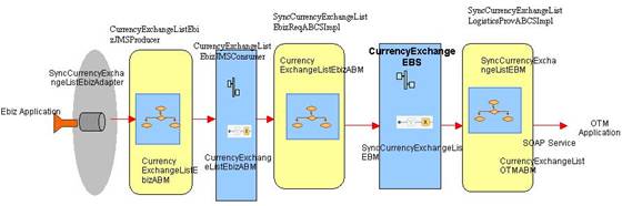

Figure 2-1 illustrates the integration of currency exchange rates.

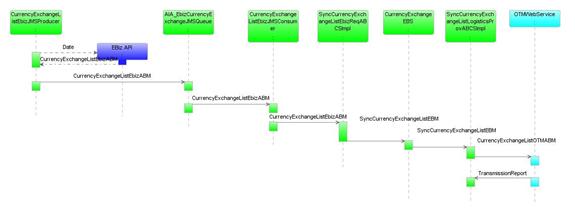

Figure 2-2 illustrates the initial loading of currency exchange rates.
When you initiate the initial load of currency exchange rates process, these events occur:
Oracle E-Business Suite invokes the CurrencyExchangeListEbizJMSProducer whenever a currency exchange rate is created or loaded into Oracle E-Business Suite.
The CurrencyExchangeListEbizJMSProducer extracts all the currency exchange rates from the Oracle E-Business Suite database based on the dates provided in the Business Process Execution Language (BPEL) console and moves the currency exchange rates into the AIA_EbizCurrencyExchangeJMSQueue.
The CurrencyExchangeListEbizJMSConsumer service picks up the message from the AIA_EbizCurrencyExchangeJMSQueue and invokes the SyncCurrencyExchangeListEbizReqABCSImpl, which transforms the message into the SyncCurrencyExchangeListEBM. Then, the SyncCurrencyExchangeListEBM invokes the CurrencyExchangeEBS.
The CurrencyExchangeEBS receives the SyncCurrencyExchangeListEBM and invokes the SyncCurrencyExchangeListLogisticsProvABCSImpl.
The SyncCurrencyExchangeListLogisticsProvABCSImpl receives the SyncCurrencyExchangeListEBM and transforms it into the CurrencyExchangeOTMABM.
The LogisticsWebService is invoked with this transformed application business message (ABM) and the instance asynchronously waits for a transmission report from OTM. If the transaction is successful, then the cross-reference values are populated for OTM columns for each of the currency exchange IDs listed in the SyncCurrencyExchangeListEBM; otherwise it invokes the AIAAsyncErrorHandlingBPELProcess with an error message.

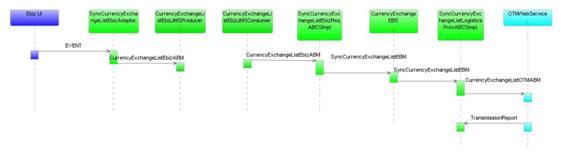

Figure 2-3 shows the incremental updates for currency exchange rates:
In the Oracle E-Business Suite user interface, the user updates or adds new currency exchange rates, which triggers and event that automatically invokes the SyncCurrencyExchangeListEbizAdapter. This adapter invokes the CurrencyExchangeListEbizJMSProducer, which queries the Oracle E-Business Suite database for currency exchanges rates and drops the message in AIA_EbizCurrencyExchangeJMSQueue.
The CurrencyExchangeListEbizJMSConsumer service picks up the message from the AIA_EbizCurrencyExchangeJMSQueue and invokes the SyncCurrencyExchangeListEbizReqABCSImpl, which transforms the message into the SyncCurrencyExchangeListEBM, and the SyncCurrencyExchangeListEBM invokes the CurrencyExchangeEBS.
The SyncCurrencyExchangeListLogisticsProvABCSImpl receives the SyncCurrencyExchangeListEBM and transforms it into the CurrencyExchangeListOTMABM.
The LogisticsWebService is invoked with this transformed application business message (ABM), and the instance asynchronously waits for a transmission report from OTM. If the transaction is successful then the cross-reference values are populated for OTM columns for each of the currency exchange IDs listed in the SyncCurrencyExchangeListEBM; otherwise it invokes the AIAAsyncErrorHandlingBPELProcess with an error message.
