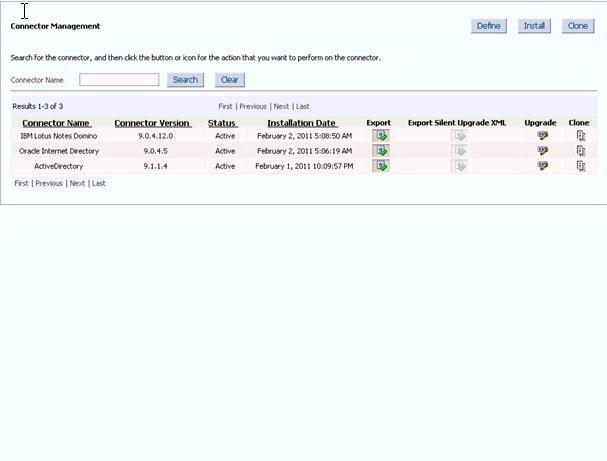

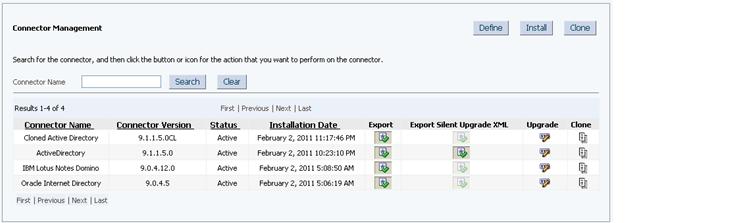

Login to Oracle Identity System Administration.
In the left pane, under System Management, click Manage Connector.
In the Connector Name field, enter the name of the connector and then click Search.
The search results show the details of the connector.
If you do not know the full name of the connector, then you can perform a wildcard search for a connector. For example, if you want to display details of the Microsoft Active Directory connector installed in your operating environment, then you can use "Direct" as the search string.
If you want to display details of all installed connectors, then leave the Connector Name field blank and click Search.
Figure 12-2 shows the search results table.
Figure 12-2 Search Results Table Showing Details of Connectors
The search results table displays the connector name, release number, status, and the date and time at which the connector was installed. The remaining columns of the table provide icons that you can use to begin any of the lifecycle management operations on a connector.

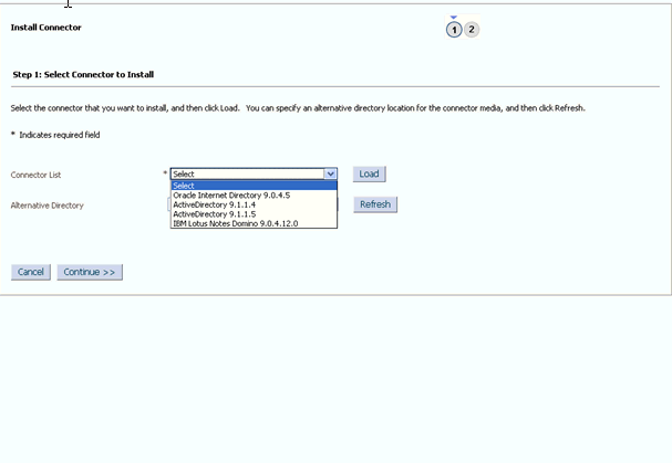

To install a connector:
Log in to Oracle Identity System Administration by using the user account described in "Creating the User Account for Installing Connectors".

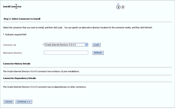

Click Install in the top-right corner of the page.
From the Connector List list, select the connector that you want to install. This list displays the names and release numbers of connectors whose installation files you copy into the default connector installation directory:
OIM_HOME/server/ConnectorDefaultDirectory
If you have copied the installation files into a different directory, then:
In the Alternative Directory field, enter the full path and name of that directory.
To repopulate the list of connectors in the Connector List list, click Refresh.
Figure 12-3 shows the Select Connector to Install page of the Install Connector wizard:
Figure 12-3 The Select Connector to Install Page
Click Load.

Connector installation history
The connector installation history is information about previously installed releases of the same connector.
Connector dependency details
There are some connectors that require the installation of some other connectors before you can start using them. For example, before you use the Novell GroupWise connector, you must install the Novell eDirectory connector. Novell eDirectory is called the dependency connector for Novell GroupWise.
The connector dependency details include the list of connectors that must be installed before you can install and use the selected connector. These details also include information about any dependency connectors that are already installed, and whether or not any of the installed dependency connectors must be upgraded. However, after showing the dependency information, the Install Connector wizard allows you to install the connector.
You must ensure that the correct versions of dependency connectors are installed after you complete the current installation.
Figure 12-4 shows the page with connector history details and connector dependency details:
Figure 12-4 Connector History and Dependency

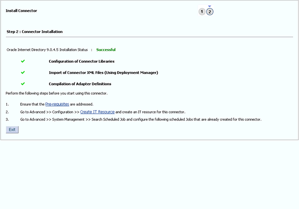

To start the installation process, click Continue.
The following tasks are performed in sequence:
Configuration of connector libraries
Import of the connector XML files (by using the Deployment Manager)
Compilation of adapters
Figure 12-5 shows the Connector Installation page of the Install Connector wizard:
Figure 12-5 The Connector Installation Page
On successful completion of a task, a check mark is displayed for the task. If a task fails, then an X mark and a message stating the reason for failure are displayed. Depending on the reason for the failure, make the required correction and then perform one of the following steps:
Fix the cause of the error, and then retry installation by clicking Retry.
Cancel the installation and begin again from step 1 of the installation procedure.
One of the reasons for installation failure could be a mismatch between information about files and directory paths in the configuration XML file and the actual files and directory paths. If this happens, then an error message is displayed.
For example, suppose the actual name of the JAR file for reconciliation is recon.jar. If the name is provided as recon1.jar in the configuration XML file, then an error message is displayed.
If such an error message is displayed, then perform one of the following steps:
Make the change in the configuration XML file, and then retry installation from the Step 1: Select Connector to Install page onward.
In the example described earlier, change the name of the JAR file to recon.jar in the configuration XML file, and then retry installation from the Step 1: Select Connector to Install page onward.
Make the change in the actual name or path of the file or directory, and then use the Retry option.
In the example described earlier, change the name of the JAR file to recon1.jar and then click the Retry button.
If all three tasks of the connector installation process are successful, then a message indicating successful installation is displayed. In addition, a list of the steps that you must perform after the installation is displayed. These steps are as follows:

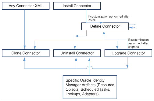

Connector LCM operations such as Upgrade, Clone, and Uninstall needs a source for each connector where all the connector objects reside. The Connector Install stores the Deployment Manager (DM) XML in Oracle Identity Manager database.
Typically, you will install the shipped connector and then perform one or both of the following operations:
Customize the connector by, for example, add/ modify existing object definitions, add additional adapters
(Re) Configure the connector by, for example, changing attribute names and key fields
The DM XML in Oracle Identity Manager database, which will be the reference for all Connector LCM operations need to be updated for customization changes. Oracle Identity Manager provides Define feature to update the DM XML stored in Oracle Identity Manager database with customization changes. Define feature is similar to Export where user need to add all the connector objects related to a specific connector. The end result of defining a connector is an XML file, which will be updated in Oracle Identity Manager database.

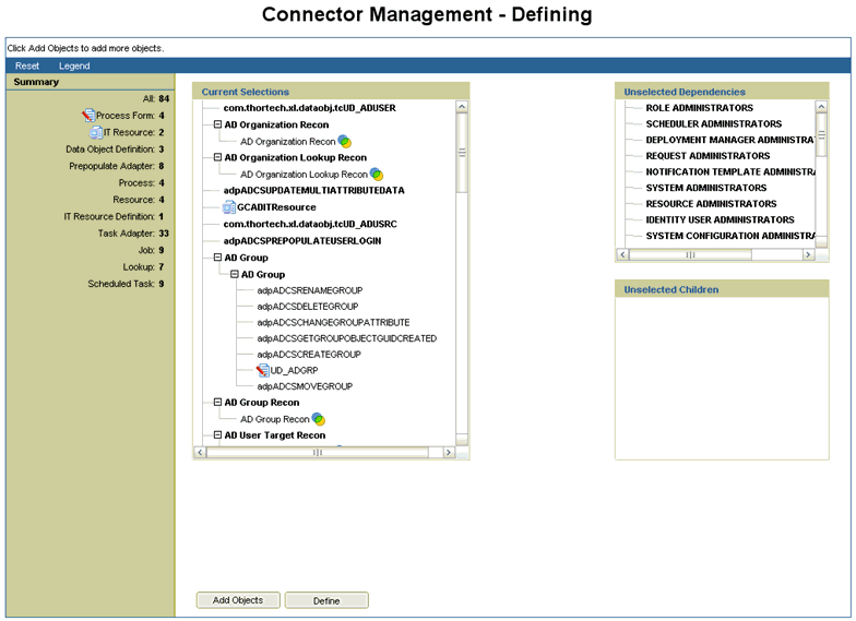

To determine whether you can define a particular release of a connector by using the Oracle Identity System Administration, see the documentation for that release of the connector.Log in to Oracle Identity System Administration.

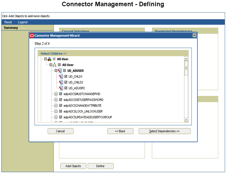

On the Connector Management window, click Define. The Connector Management Wizard is displayed, as shown in Figure 12-6:
Figure 12-6 Connector Management Wizard for Defining Connectors

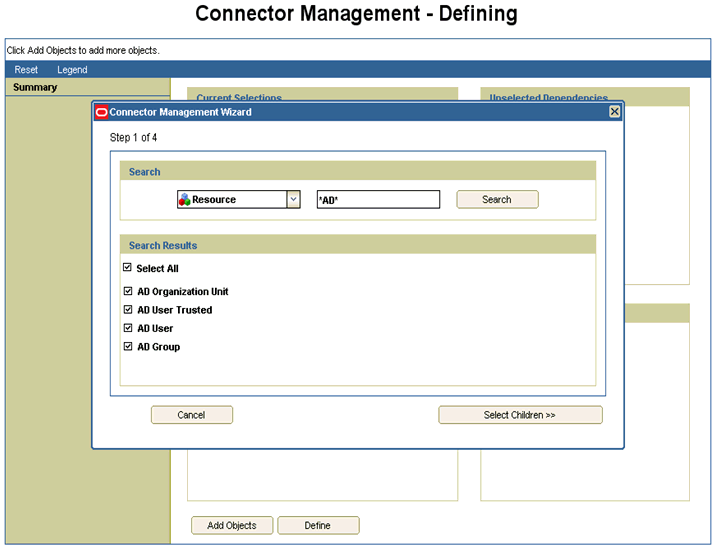

On the first page of the wizard, select either Resource or Process from the Search list. In the adjoining field, you can enter a search string and the asterisk (*) as a wildcard character to refine your search for resource objects or process definitions belonging to the connector. Then, click Search.
Most of the objects that constitute a connector are linked to the resource objects and process definition of the connector. By selecting the resource objects or process definition, you automatically select the objects linked with them. Some of the connector objects, for example, scheduled task, do not have dependency with the resource object. Ensure that you search all the attributes and add them while defining.
When you click Search, the list of resource objects or process definitions that meet the specified search criteria are displayed.
Select the check boxes for the resource objects or process definitions that are part of the connector.
Figure 12-7 shows step 1 of the Connector Management Wizard with search results for connector objects:
Figure 12-7 Step 1 of the Connector Management Wizard
Click Select Children.
From the list of connector objects displayed, ensure that all the objects belonging to the connector are selected. Then, click Select Dependencies.
For an Oracle-released connector, the adapters that are part of the connector are listed in the connector guide. Select the check boxes for those adapters.Figure 12-8 shows step 2 of the Connector Management Wizard:
Figure 12-8 Step 2 of the Connector Management Wizard
After you review the list of objects that you have selected, click Confirmation.
Figure 12-9 shows step 3 of the Connector Management Wizard with the list of selected connector objects:
Figure 12-9 Step 3 of the Connector Management Wizard

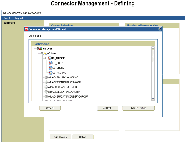

Click Add For Define.
Figure 12-10 shows step 4 of the Connector Management Wizard:
Figure 12-10 Step 4 of the Connector Management Wizard

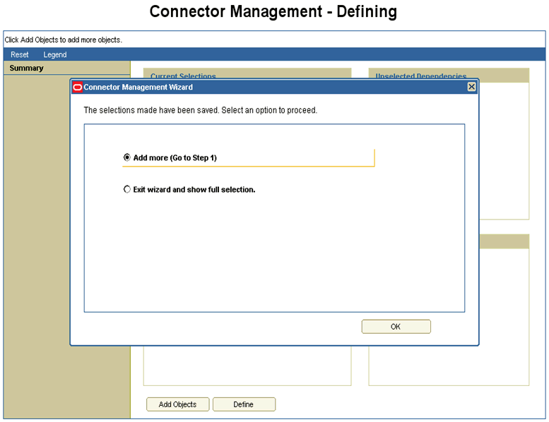

To proceed, select any one of the following options, and click OK:
Add more (Go to Step 1): Select this option if you want to go to step 1 of the Connector Management Wizard and select more connector objects.
Exit wizard and show full selection: Select this option if you want to exit the Connector Management Wizard and display the complete list of selected connector objects.
Figure 12-11 shows the page with the options to add more connector objects or to exit the wizard:
Figure 12-11 Options to Select More Objects or Exit
On the page that is displayed, only objects shown in the Current Selections list are included in the connector definition. You can drag objects across lists. For example, you can drag an adapter from the Current Selections list to the Unselected Children list. After you make the required changes, click Define.
Make sure that you have added all the Oracle Identity Manager connector objects specific to defining connector. If you do not have a specific connector object while defining the connector, then upgrade, clone, or uninstall may not handle the undefined object.The following are Oracle Identity Manager artifacts that are generally associated with almost all the connectors:

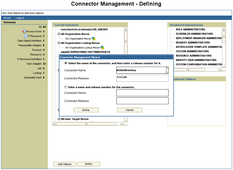

In the dialog box that is displayed, select one of the following options:
Select the name of the connector, and then enter a release number for it: Select this option if an earlier release of this connector already exists on this Oracle Identity Manager installation. In addition, select a connector name and enter a release number.
Enter a name and release number of the connector: Select this option if an earlier release of this connector does not exist on this Oracle Identity Manager installation. In addition, enter a connector name and release number.
Figure 12-13 shows the dialog box to specify the connector name and release number:
Figure 12-13 Connector Name and Release Number
Click Define.
At the end of the process, a message stating that the operation was successful is displayed. Click Close.

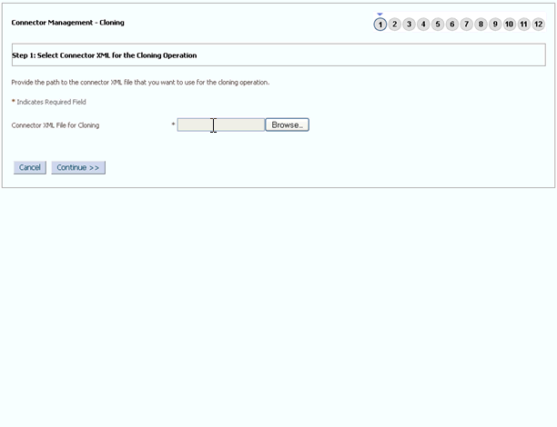

If you want to use a connector XML file as the source, then:
Click Clone in the upper-right corner.
On the Step 1: XML Selection from File System page, use the Browse option to navigate to and select the connector XML file.
Figure 12-14 shows the XML Selection from File System page of the Connector Management - Cloning wizard:
Figure 12-14 The XML Selection from File System Page
Click Continue.

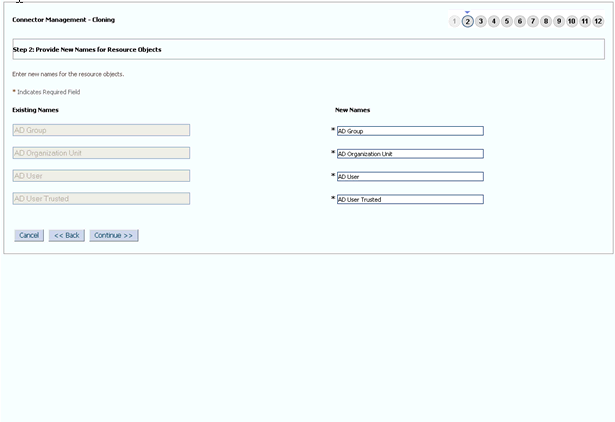

On the Step 2: Provide New Names for ROs page, enter new names for the resource objects of the clone.
If the connector has multiple resource objects, then the new name that you specify for each resource object must be different from the names of all the existing resource objects of that connector.
Click Continue after you specify new names for all the resource objects.
Figure 12-16 shows the Provide New Names for Resource Objects page of the Connector Management - Cloning wizard:
Figure 12-16 The Provide New Names for Resource Objects Page

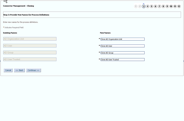

On the Step 3: Provide New Names for Process Definitions page, enter new names for the process definitions of the clone.
If the connector has multiple process definitions, then the new name that you specify for each process definition must be different from the names of all the existing process definitions of that connector.
Click Continue after you specify new names for all the process definitions.
Figure 12-17 shows the Provide New Names for Process Definitions page of the Connector Management - Cloning wizard:
Figure 12-17 The Provide New Names for Process Definitions Page

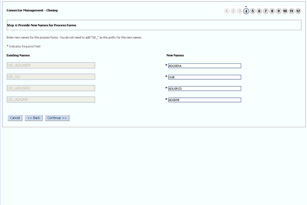

On the Step 4: Provide New Names for Process Forms page, enter new names for the process forms of the clone.
If the connector has multiple process forms, then the new name that you specify for each process form must be different from the names of all the existing process forms of that connector.
Click Continue after you specify new names for all the process forms.
Figure 12-18 shows the Provide New Names for Process Forms page of the Connector Management - Cloning wizard:
Figure 12-18 The Provide New Names for Process Forms Page

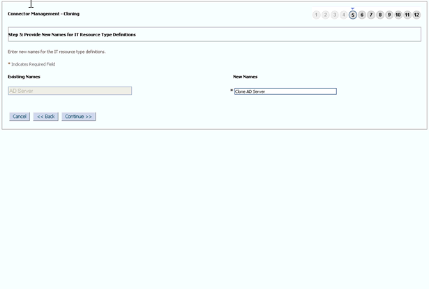

On the Step 5: Provide New Names for IT Resource Type Definitions page, enter new names for the IT resource type definitions of the clone.
If the connector has multiple IT resource type definitions, then the new name that you specify for each IT resource type definition must be different from the names of all the existing IT resource type definitions of that connector.
Click Continue after you specify new names for all the IT resource type definitions.
Figure 12-19 shows the Provide New Names for IT Resource Type Definitions page of the Connector Management - Cloning wizard:
Figure 12-19 The Provide New Names for IT Resource Type Definitions Page

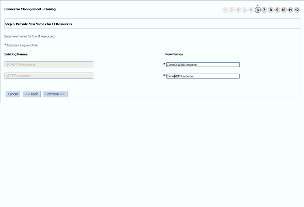

On the Step 6: Provide New Names for IT Resources page, enter new names for the IT resources of the clone.
If the connector has multiple IT resources, then the new name that you specify for each IT resource must be different from the names of all the existing IT resources of that connector.
Click Continue after you specify new names for all the IT resources.
Figure 12-20 shows the Provide New Names for IT Resource Type Definitions page of the Connector Management - Cloning wizard:
Figure 12-20 The Provide New Names for IT Resources Page

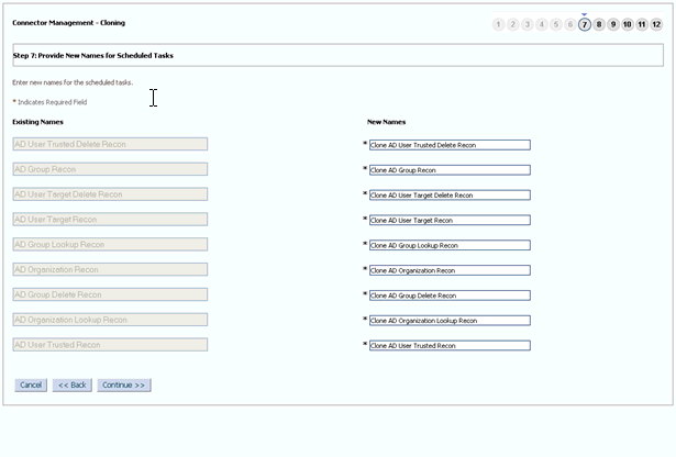

On the Step 7: Provide New Names for Scheduled Tasks page, enter new names for the scheduled tasks of the clone.
Enter new names for the scheduled tasks. However, you cannot use the same set of scheduled tasks for the clone and the original connector.
Click Continue.
Figure 12-21 shows the Provide New Names for Scheduled Tasks page of the Connector Management - Cloning wizard:
Figure 12-21 The Provide New Names for Scheduled Tasks Page

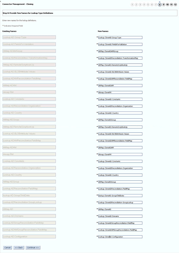

On the Step 8: Provide New Names for Lookup Type Definitions page, enter new names for the lookup definitions of the clone.
Click Continue.
Figure 12-22 shows the Provide New Names for Lookup Type Definitions page of the Connector Management - Cloning wizard:
Figure 12-22 The Provide New Names for Lookup Type Definitions Page

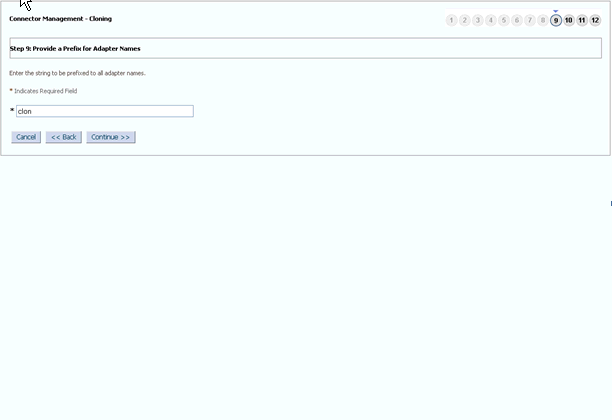

On the Step 9: Provide a Prefix for Adapters page, enter the string that will be set as the prefix for the copies of the adapters. Then, click Continue.
You must ensure that the prefix that you specify does not cause the full name of any adapter to exceed 80 characters. The Clone Connectors feature cannot check if this limit is exceeded. However, when you import the connector XML file created for the clone, the Deployment Manager throws an error. Remember that the Deployment Manager is called even when you build a deployment package for the clone and use the Install Connectors feature to install the clone.
You can use the Design Console to determine the character length of the longest adapter name.
Figure 12-23 shows the Provide a Prefix for Adapters page of the Connector Management - Cloning wizard:
Figure 12-23 The Provide a Prefix for Adapters Page

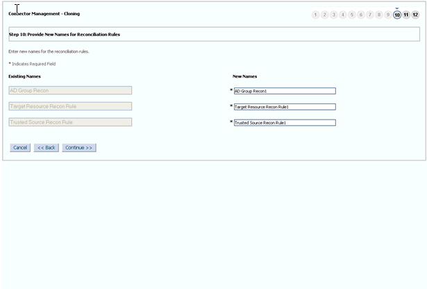

On the Step 10: Provide New Names for Reconciliation Rules page, enter new names for the reconciliation rules of the clone.
Figure 12-24 shows the Provide New Names for Reconciliation Rules page of the Connector Management - Cloning wizard:
Figure 12-24 The Provide New Names for Reconciliation Rules Page

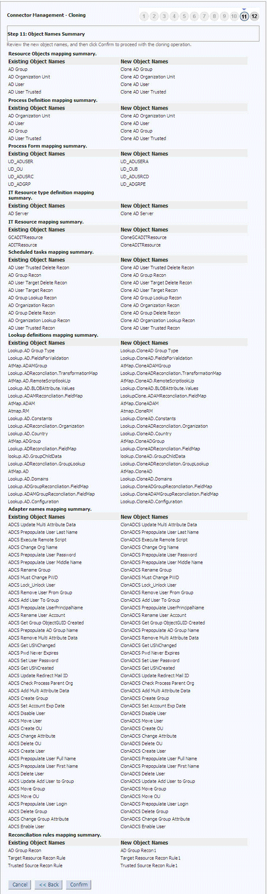

On the Step 11: Object Names Summary page, review the names that you have set for the connector objects of the clone and then click Continue.
Figure 12-25 shows the Object Names Summary page of the Connector Management - Cloning wizard:
Figure 12-25 The Object Names Summary Page

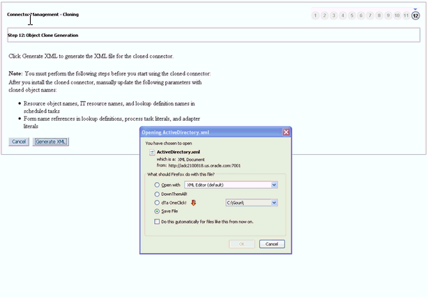

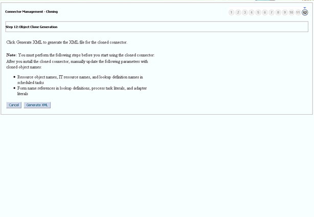

On the Step 12: Object Clone Generation page, click Generate XML.
Figure 12-26 shows the Object Clone Generation page of the Connector Management - Cloning wizard:
Figure 12-26 The Object Clone Generation Page
In the File Download dialog box, use the Save option to save the connector XML file of the clone to a location of your choice.
Figure 12-27 shows the File Download dialog box:
Figure 12-27 The File Download Dialog Box
You can use one of the following options to export the connector XML file:
If you want the XML file to include definitions of only specific connector objects, then use the Export button to open the Deployment Manager. See the "Using the Deployment Manager" chapter in the connector guide for detailed information about using this feature to select connector objects whose definitions you want to include in the connector XML file.
If you want to create the connector XML file out of the connector XML stored in the database when the connector was defined, then:
In the Connector Management page, use the Search feature to display the connector for which you want to create the connector XML file.
Use the Export icon displayed in the connector row to export the connector XML file from the entry created in the database when defining the connector.
Figure 12-28 shows the Connector Management page:
Figure 12-28 The Connector Management Page

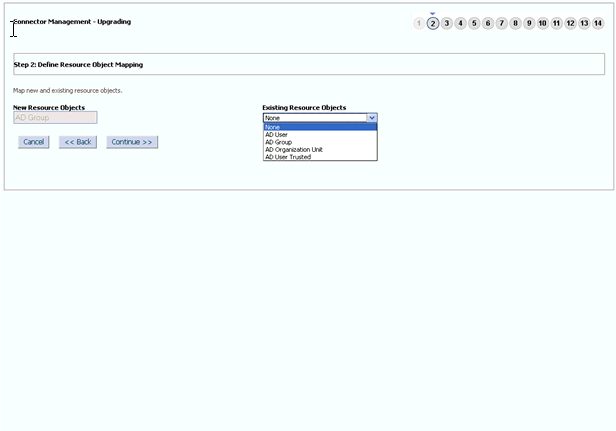

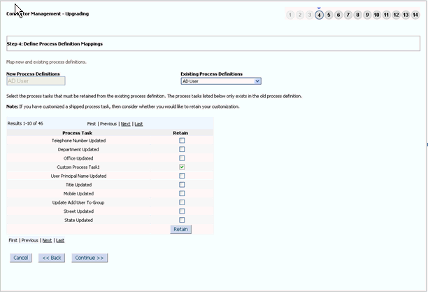

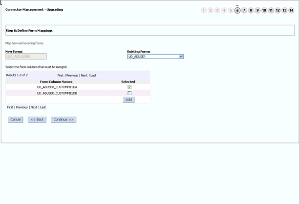

Connector Upgrade utility is responsible for upgrading the OIM artifacts from source version to the target version, by retaining the customer customization done on the source connector. Connector upgrade does not handle connector library upgrade/update. User need to manually upgrade the libraries involved in connector.
The following are sample scenarios that describe a need for upgrading a connector:
Reconfiguring or customizing an existing connector
After you install a connector, you might customize or reconfigure it according to your requirements. For example, you might add new attributes for reconciliation and provisioning and modify the scheduled tasks for reconciliation or lookup field synchronization. Ideally, you would make these changes to the connector on a staging server. You would then want to upgrade the connector deployed on your production server to the version that you create by making changes on the staging server.
Upgrading a customer-developed connector
You might have developed your own connector. When an Oracle-released upgrade is available for your connector, you might want to upgrade from your connector to the Oracle-released connector. For example, suppose you have developed and are using a connector for IBM Lotus Notes and Domino. When Oracle ships a new release of Oracle Identity Manager Connector for IBM Lotus Notes and Domino, you might want to use some of the features included in the new release. You can use the Upgrade Connectors feature to upgrade from your connector to the Oracle-released connector.
Upgrading an Oracle-released connector
Oracle ships connector upgrades. An upgrade includes enhancements and fixes that you might need. For example, if you are currently using SAP User Management release 9.1.2, then you might want to upgrade to release 9.1.2.3 of the same connector when that release is available.
In scenarios such as these, you can use the Upgrade Connectors feature to upgrade the connector.
Upgrading connectors can be done by two ways:
Silent mode upgrade: Used in staging and production environments
Wizard mode upgrade: Used in development environment
In this guide, Wizard upgrade, which is performed using Oracle Identity System Administration pages is described.

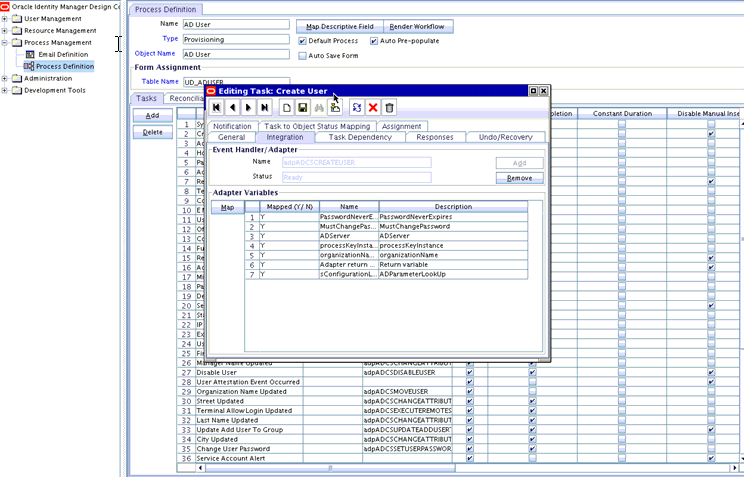

Event-handler adapters can be assigned or deleted.

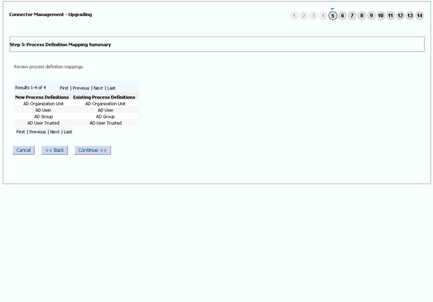

The Upgrade Connectors feature can run on a process definition on which any combination of the following changes have been made. In addition, an upgrade operation might involve any combination of the following changes to a process definition.
The existing process definition can be replaced by a new process definition.
The existing provisioning definition can be renamed.
Existing reconciliation field mappings can be retained without change or modified.
New process tasks can be added.
Custom process tasks can be retained without a change.
Default process tasks can be retained, but you need to confirm that there are no changes in the default process task in the new version. Refer to the connector guide for more information.
Any combination of the following changes can be made to an existing process task:
The name and properties of the task can be modified.
An attached event handler-adapter can be modified.
Preceding and dependent tasks can be added, modified, or deleted.
New response codes can be added.
Existing response codes can be modified or deleted.
New tasks can be generated.
Undo tasks and recovery tasks can be modified.
Task-to-object status mapping can be modified.
Assignment rules can be modified.
Existing process tasks can be deleted.
After the upgrade, the new name of the process definition is the one specified in the connector XML of the target connector.

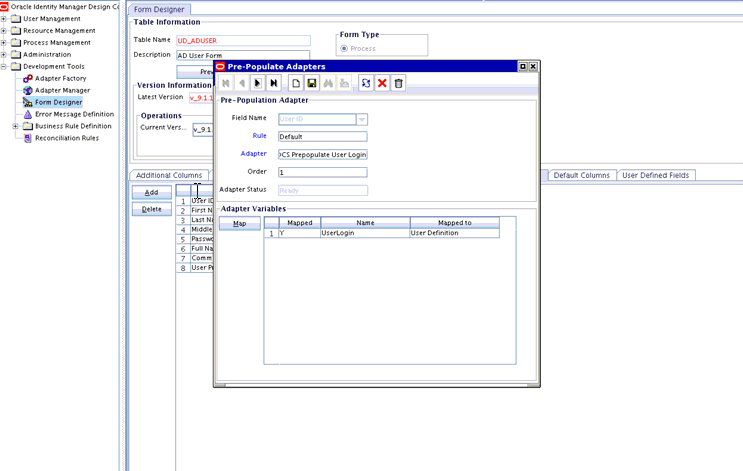

Pre-populate adapters can be added.
The name, mappings, order, and rule of existing pre-populate adapters can be modified.

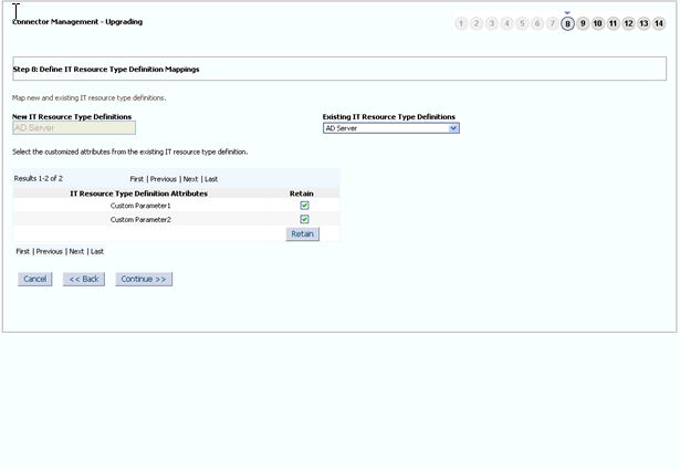

The Upgrade Connectors feature can run on an IT resource type on which any combination of the following changes have been made. In addition, an upgrade operation might involve any combination of the following changes to an IT resource type.
The existing IT resource type can be replaced by a new IT resource type.
In an existing IT resource type, new parameters can be added and existing parameters can have their default values and types modified or deleted.
All custom parameters are displayed while mapping IT Resource Type definitions. You can retain the custom parameters.
The Upgrade Connectors feature can run on an IT resource on which any combination of the following changes have been made. In addition, an upgrade operation might involve any combination of the following changes to an IT resource.
The parameter retained for IT Resource Type definition will be available for all the IT Resource instances of this type. If an existing parameter in IT Resource Type definition is not retained, then this parameter will not available in all the IT Resource instances of this type.
In an existing IT resource, new parameters can be added and existing parameters can have their default values and types modified or deleted.
After the upgrade, the new name of the IT Resource Type definition is the one specified in the connector XML of the target connector.

If required, create the connector XML file for a clone of the source connector.
If the object names in the target connector are different from object names in the source connector, then it is recommended that you first create the connector XML file for the clone connector. "Step 1: Create the connector XML file for the cloned connector" describes the procedure. While performing the procedure, specify object names that are the same as object names in the target connector. This will help avoid the need for renaming connector objects after you upgrade the connector.

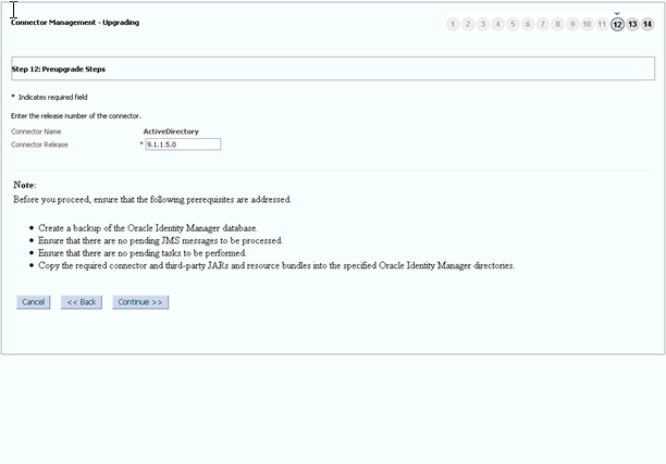

You need to perform preupgrade and post upgrade steps while performing wizard mode upgrade.To perform the wizard mode upgrade on the staging server:
Create a backup of the Oracle Identity Manager database.
Create Oracle Identity Manager metadata (MDS) backup. See "Migrating User Modifiable Metadata Files" in the Oracle Fusion Middleware Developer's Guide for Oracle Identity Manager for information about exporting and importing Oracle Identity Manager metadata to and from MDS.
Run the connector preupgrade utility.

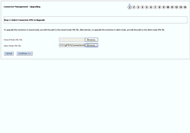

Use the Upgrade Connectors feature.
Log in to the Oracle Identity System Administration.
Use the Search feature to search for the source connector that you want to upgrade. In the table of search results, click the Upgrade icon for the source connector.

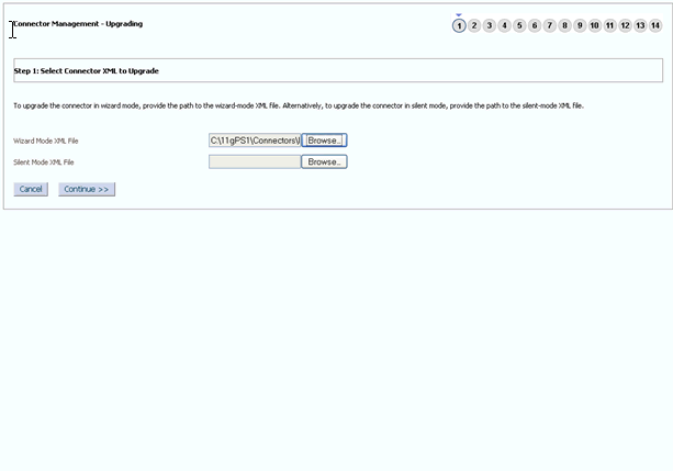

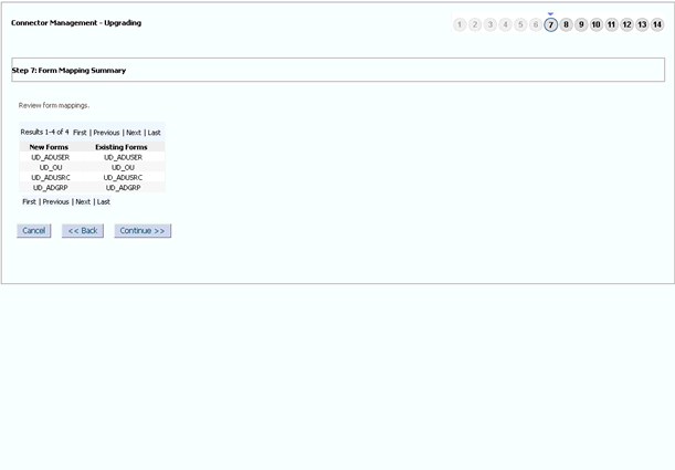

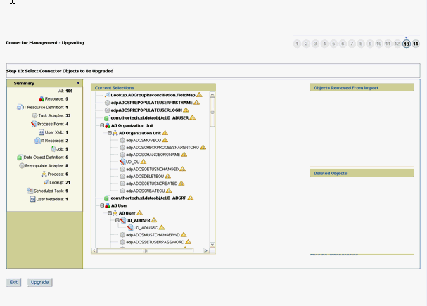

On the Step 1: On the Upgrade page, select Connector XML for the Wizard Mode XML File field. Use the Browse option to navigate to the target version of the connector XML to which you want to upgrade. You can also enter the full path of the target connector XML file. Make sure that you select the correct target connector XML. Upgrade feature does not validate the XML for target version or for any other connector object details. Leave Silent Mode XML File field empty.
For example, if a user is upgrading the Active Directory connector from source version 9.1.1.7 to target version 11.1.1.5.0, user needs to select Active Directory 11.1.1.5.0 connector config XML (which is under xml folder) for Wizard mode upgrade XML field.
There will be only one XML file for both trusted source reconciliation and target resource reconciliation for all the ICF based connectors. If you have more than one XML file, that is one for trusted source reconciliation and another for target resource reconciliation, you need to select the XML file for target resource reconciliation. Refer the connector guide (CI-XML) for the XML file name.Figure 12-29 shows the Select Connector XML to Upgrade page of the Connector Management - Upgrading wizard:
Figure 12-29 The Select Connector XML to Upgrade Page
Click Continue.
On the Step 2: Resource Object Mapping page, apply the following guidelines to map each new resource object with an existing resource object. Click Continue after you create each mapping.
The New Resource Object field shows the name of a resource object in the target release. From the Existing Resource Object list, select the resource object in the source release to which you want to map the resource object in the target release. There might be a change in resource object names. It is your responsibility to map the resource object properly.
If there are new resource objects that do not have a corresponding resource object in the source release, then select None from the Existing Resource Object list. This will happen only when the target connector versions add new resource objects that are not there in the source version.
If you are upgrading from an Oracle-released source connector to an Oracle-released target connector, then see the connector guide for information about the mappings that you must create.Figure 12-30 shows the Resource Object Mapping page of the Connector Management - Upgrading wizard:
Figure 12-30 The Resource Object Mapping Page

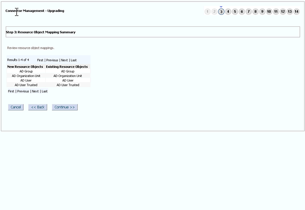

On the Step 3: Define Resource Scope page, a summary of the resource object mappings that you create is displayed. If there are resource objects in the source release that do not have corresponding resource objects in the target release, then they are displayed in the second table on this page. If you want to delete these resource objects, then select their check boxes. If a resource object is selected for deletion, then the resource will not be deleted from Oracle Identity Manager database. It just updates the OBJ_IS_SOFT_DELETE flag for the corresponding Resource Object to "1". The resource will be still available for all provisioning and reconciliation. This flag will be used in future.
Figure 12-31 shows the Define Resource Scope page of the Connector Management - Upgrading wizard:
Figure 12-31 The Define Resource Scope Page
Click Continue.
On the Step 4: Define Process Definition Mapping page, map each new process definition with an existing process definition. Follow the guidelines given in Step f for mapping resource objects. Click Continue after you create each process definition mapping. If there are changes in the process definition names in source and target, it is your responsibility to map them properly. After selecting the corresponding source process definition for a specified target process definition, the page displays the list of process tasks available in the source process definition. You can retain the process tasks from the Source process definition. If there are any custom process tasks added to the source process definition, they can be retained. If there are any customization on the default process task, then before retaining such tasks you need to make sure there are no changes for this process task in the new connector release version by refereeing the connector guide. If a specific default process task is selected to retain, you might lose the changes (if there are any) for this process task in the new connector release. If the process tasks are part of the source connector and are not required in the target connector, then such process tasks must not be retained. It is recommended only to retain tasks that are added by user as part of customization of the source connector.

On the Step 5: Process Definition Mapping Summary page, a summary of the process definition mappings that you create is displayed. Click Continue to proceed.
Figure 12-33 shows the Process Definition Mapping Summary page of the Connector Management - Upgrading wizard:
Figure 12-33 The Process Definition Mapping Summary Page
On the Step 6: Define Form Mappings page, map each new form with an existing form. Follow the guidelines given in Step f for mappings resource objects. In addition, apply the following guideline and then click Continue after you create a mapping for each form. When a source process form is selected for each target, the page displays list of process form fields from the source process form attributes, which are not available in the target process form. These attributes either added to the source process as a part of customization or these were default attributes part of the source process form which may not be required for the target. You can select the attributes which are added as a part of customization, but need to verify if a default attribute is required in the target before retaining it.
Figure 12-34 shows the Define Form Mappings page of the Connector Management - Upgrading wizard:
Figure 12-34 The Define Form Mappings Page
On the Step 7: Form Mapping Summary page, a summary of the form mappings that you create is displayed. Click Continue to proceed.
Figure 12-35 shows the Form Mapping Summary page of the Connector Management - Upgrading wizard:
Figure 12-35 The Form Mapping Summary Page
On the Step 8: Define IT Resource Type Definition Mappings page, map each new IT resource definition with an existing IT resource definition. Follow the guidelines given in Step f for mappings resource objects. Click Continue after you create a mapping for each IT resource definition. If there are changes in the names of the IT resource type definition, then it is your responsibility to map them properly. Refer the connector guide to check the change in default IT resource type definition names. When a target IT resource type definition is mapped with corresponding source IT resource type definition, the page displays list of IT resource type definition parameters, which are part of source definition but not available in target definition. These are either added as a part of customization or they were part of source definition. If these parameters are added as part of customization, then you need to retain them.
Figure 12-36 shows the Define IT Resource Type Definition Mappings page of the Connector Management - Upgrading wizard:
Figure 12-36 The Define IT Resource Type Definition Mappings Page

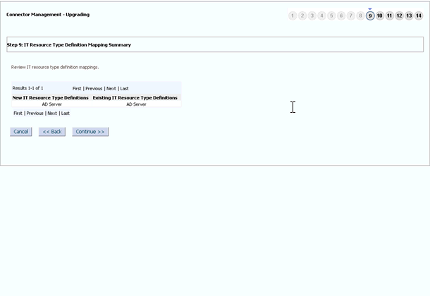

On the Step 9: IT Resource Type Definition Mapping Summary page, a summary of the IT resource type definition mappings that you create is displayed. Click Continue to proceed.
Figure 12-37 shows the IT Resource Type Definition Mapping Summary page of the Connector Management - Upgrading wizard:
Figure 12-37 The IT Resource Type Definition Mapping Summary Page
On the Step 12: Preupgrade Steps page, enter a new release number for the connector in the Connector Version field. Click Continue to proceed. The upgrade process does not validate the version provided with the connector release version. You need to provide correct version here by referring the connector guide.
Figure 12-38 shows the Preupgrade Steps page of the Connector Management - Upgrading wizard:
On the Step 13: Select Connector Objects to Be Upgraded page.
Figure 12-39 shows the Select Connector Objects to Be Upgraded page of the Connector Management - Upgrading wizard:
Figure 12-39 The Select Connector Objects to Be Upgraded Page

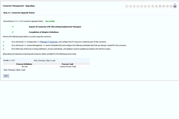

Figure 12-40 shows the Connector Upgrade Status page of the Connector Management - Upgrading wizard:
Figure 12-40 The Connector Upgrade Status Page
Note down the process definition names and the corresponding process task names. These process tasks are not going to be used by Oracle Identity Manager anymore. Therefore, all their pending and rejected instances need to be canceled.Use cancelProcessTask utility available in OIM_HOME/server/bin. The utility takes the process definition name and the process task name as input. You need to run the utility for each process task.The Upgrade Connectors feature processes connector object mappings in the following manner:
Use the Search feature to search for the connector.
In the search results table, click the Export Silent Upgrade XML icon for the connector.

On the Step 1: Select Connector XML to Upgrade page of the utility, enter the full path and name of the connector XML file for the source release in the Silent mode upgrade XML field. You can use the Browse option to navigate to the XML file.
There will be only one XML file for both trusted source reconciliation and target resource reconciliation for all the ICF based connectors. If you have more than one XML file, that is one for trusted source reconciliation and another for target resource reconciliation, you need to select the XML file for target resource reconciliation. Refer the connector guide (CI-XML) for the XML file name.Figure 12-41 shows the Select Connector XML to Upgrade page of the Connector Management - Upgrading wizard:
Figure 12-41 The Select Connector XML to Upgrade Page
Click Continue.

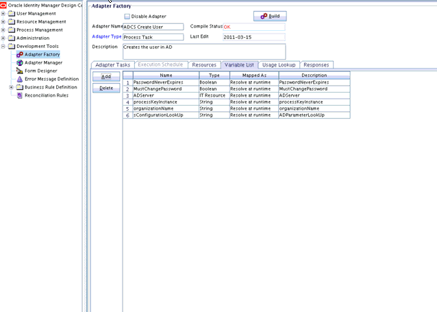

Log in to Design Console.
Open the custom adapter using the adapter factory.
Go to the variable list and check if there are any variables of type IT Resource, as shown in Figure 12-45:
Figure 12-45 The Variable List Tab of the Adapter Factory Form

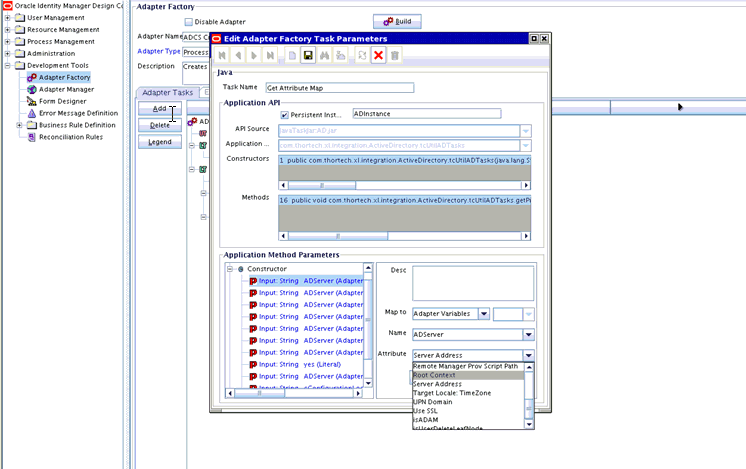

If there is a variable of IT Resource, then go to the task details and change the mapping of the IT Resource parameter mapping to the new target field (if the parameter is changed/deleted).
Figure 12-46 shows the Edit Adapter Factory Task Parameters dialog box that enables you to change the mapping of the IT Resource parameter mapping to the new target field:
Figure 12-46 The Edit Adapter Factory Task Parameters Dialog Box

iii) Click the task, and then click the Integration tab, as shown in Figure 12-47:
Figure 12-47 The Integration Tab of the Editing Task Dialog Box

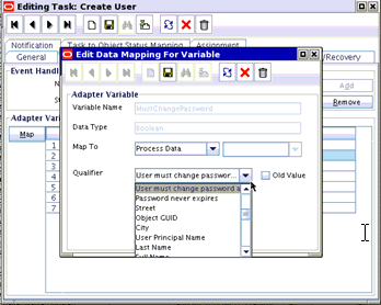

iv) Check if the adapter variable is mapped to the deleted/modified form attribute. If yes, remap such attributes to adapter variables. Repeat this step for all process tasks of all process definitions of the connector.
Figure 12-48 shows the Editing Data Mapping for Variable dialog box that enables you to view and edit the adapter variable mapping to the form attribute:
Figure 12-48 The Editing Data Mapping for Variable Dialog Box
Prepopulate adapter mappings as follows:
i) Log in to Design Console.
ii) Go to Form Designer, Pre-Populate Adapters, as shown in Figure 12-49:
Figure 12-49 The Pre-Populate Adapters Dialog Box
iii) Click Map to map adapter variable and check if any of the fields are mapped to the process data attributes. If it is mapped, then verify the process form attribute is not deleted as part of upgrade. If the process form attributes are deleted, then remap them to the correct form attribute data.
Figure 12-50 shows the Map Adapter Variable dialog box:
Figure 12-50 The Map Adapter Variable Dialog Box
Repeat the procedure for all the prepopulated fields of all the process forms of the connector. If there are any entity adapter, then check the adapter variables mapping for these adapters in Data Object Manager.Perform the following postupgrade steps:

Using Oracle Identity Manager 11g Release 2 (11.1.2.1.0), you can configure a cloned Active Directory (AD) Release 9.x connector for target AD and run an AD trusted source reconciliation to create users in Oracle Identity Manager. After the user is created in Oracle Identity Manager, when you run the target resource reconciliation for AD, the user details are linked in the Accounts tab. However the Detail Information tab displays a blank page. When you check the Application Instances section in Oracle Identity System Administration and search and open the relevant application instance, no form is found associated with the application instance.
Create a new set of forms for each application instance.
